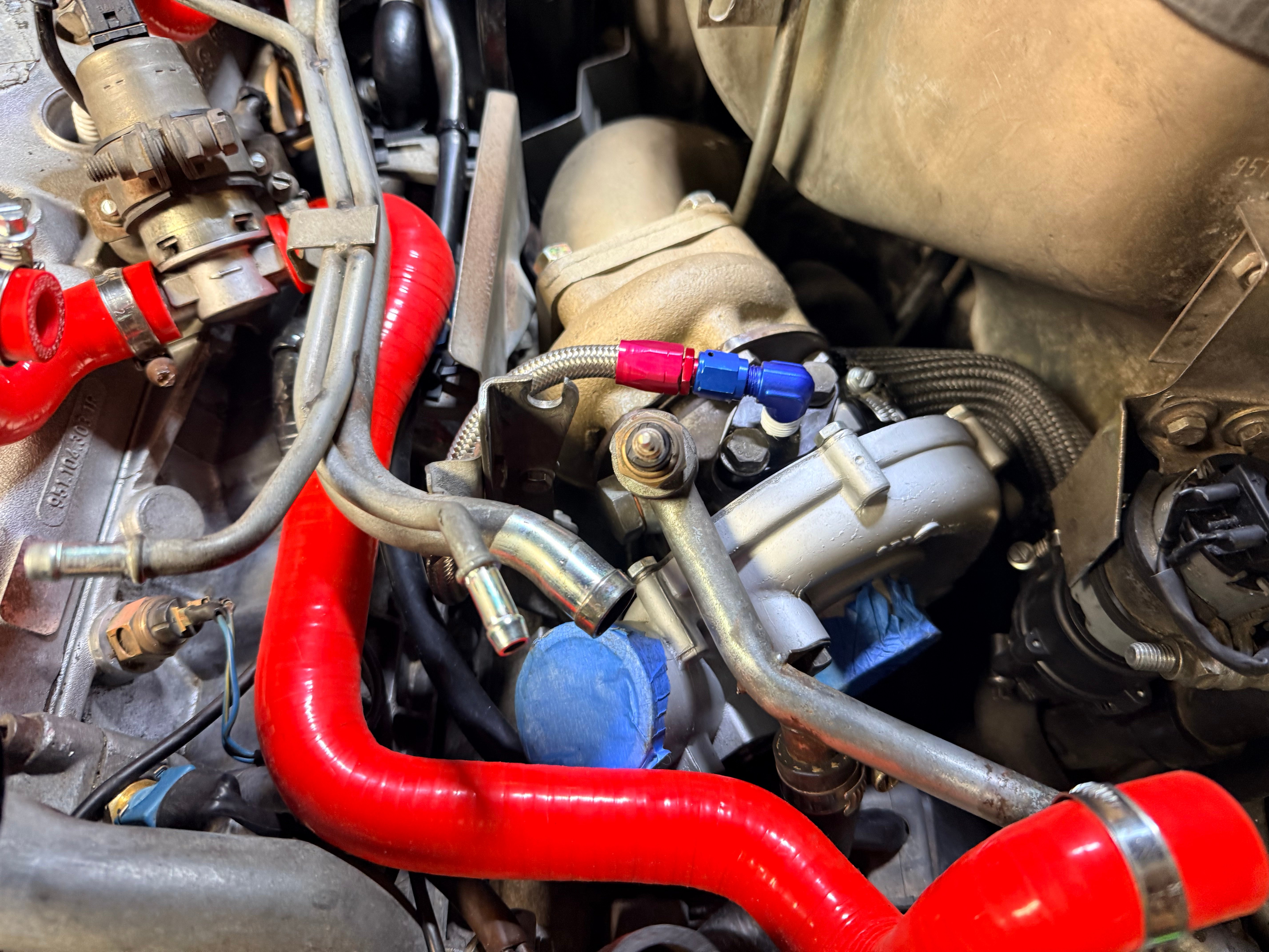

Backstory. I purchased a 951 4 months ago and after replacing the j boot, I discovered that the compressor wheel on the stock k26/6 had damage. The car still seemed to get around 10-11psi even with the bad compressor wheel. I decided to either get the turbo rebuilt or purchase another one. I ran across a recently rebuilt turbo (under 15k miles) for a good deal and decided to go for it. It looked great. No play in the compressor wheel and had been coated and cleaned.
I just got done swapping the turbo along with new vacuum lines, new billet Mode pop off diverter valve, boost hoses, Venturi delete, coolant hoses, new turbo oil feed line, aos seals, various other seals, crush washers and exhaust crush seals, etc. now I only get around 5 maybe max 6 psi boost and I’m hearing almost rattle like sound on cold start. Seems to taper off after warming up.. Maybe from the turbo? Maybe in the exhaust somewhere? I can hear it more in the exhaust under the car. But I can’t confirm and very hard to pinpoint. All I know is it didn’t have the sound before and made around 10-11’ish psi before the work.
Symptoms I’ve noticed
- Intermittent rattle sound seems to come from around turbo I think..? almost sounds like a rattling heat shield. at first I thought that what it is but doesn’t appear to be. still trying to nail down where but seems to be more pronounced under car. Could it be the turbo not getting enough oil from the feed line?
- Slight condensation leak from triangle down pipe flange on cold start. Just a little condensation seeps out of that flange. Assuming this indicates a leak but I installed a brand new donut crush washer and torqued very snug.
- Only 2psi of boost in first gear 3k rpm and maxes out at no more than 5-6 psi in second gear around 4k rpm
Troubleshooting I’ve done:
- Tightened down all vacuum and boost hoses, new wastegate hose, pipes..
- Swapped out cycling valve for a spare. I tested both with applying 9v to the pins and I can hear a click. air passes through the port that is cutoff when power is applied to the valve.
- My boost/vacuum gauge is reading 17-18 hg for vacuum at idle.
Trying to figure out if I need to tear it down again and just get the turbo rebuilt. Or should I keep troubleshooting before I do that? What steps would you recommend? I still have my old turbo that I could just send off to get rebuilt with new compressor wheel, but I’m obviously not happy about forking over the money to buy a ‘good’ used one and it’s not functional or is at least suspect. I’ve seen that clamping off the wastegate is a troubleshooting option but if it gets boost, what does that tell me, and if it doesn’t, what does it mean? I spent a lot of time on the project and tried to take my time and go through every detail so any pointers here on next steps/options would be helpful!
Max 5psi boost after turbo install

Pulled the j boot again just to double check the compressor wheel and it looks good and I don’t feel any play. Not sure if I have an issue with the turbo or something else reducing boost.

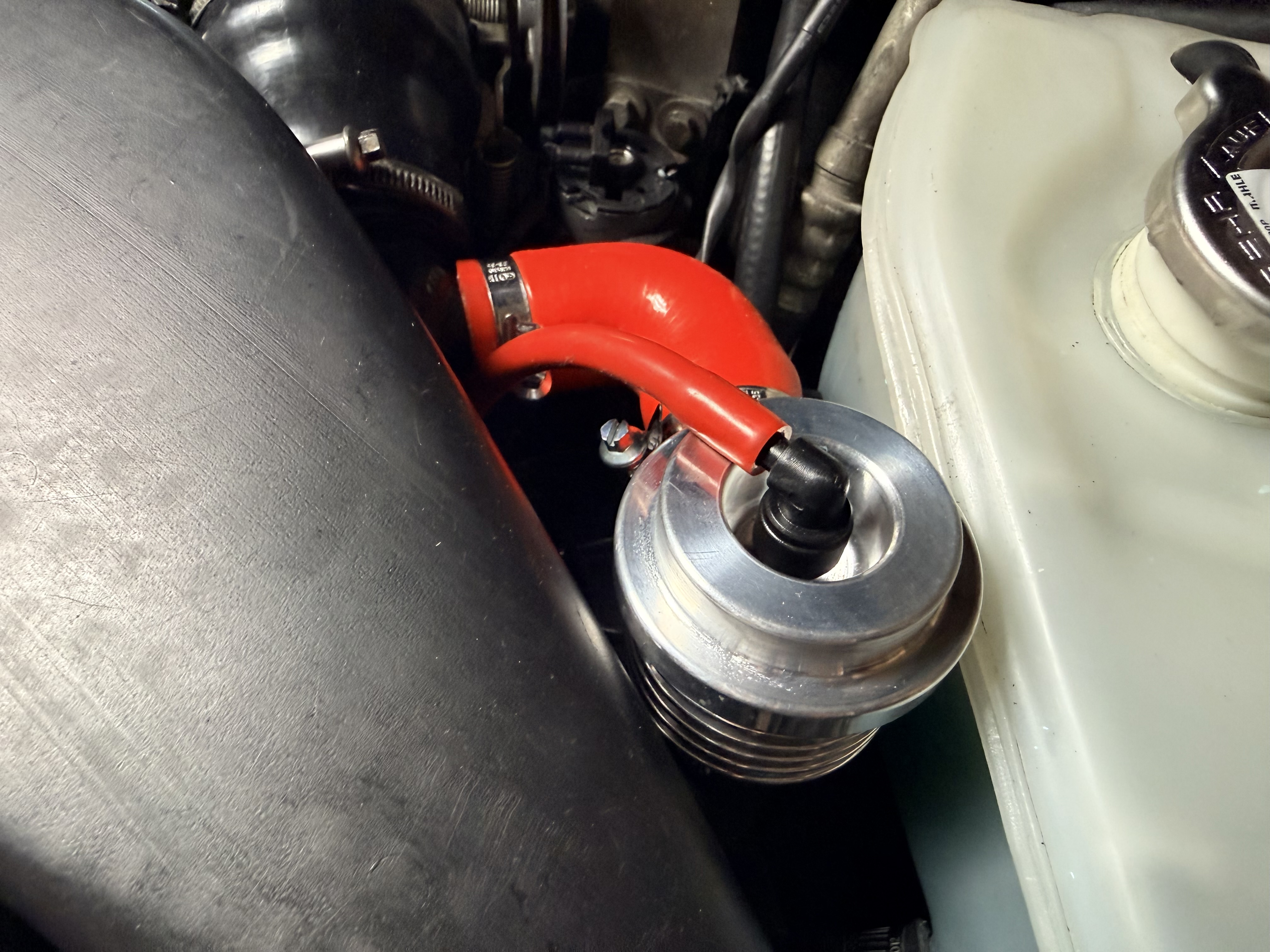

I know! I had to to a mount my phone close to the gauge so I can take video to catch what I’m hitting.
So I replaced it with a new Mode billet piston style diverter valve so I hope it’s working bc it wasn’t cheap! https://944online.com/cut-off-pop-off-valve/ i used Lindsey’s vacuum diagram and it’s T’ed from the damper and regulator. https://www.lindseyracing.com/LR/Parts/VACDIA.htmldanmartinic wrote: Mon Jun 01, 2026 5:49 pm 11 psi is about right (.75 - .8 bar)
If you can get it full boost in high gear maybe look at your diverter valve that it's properly installed & setup
chrischrischris
- Posts: 131
- Joined: Mon Mar 03, 2025 11:10 am
- Has thanked: 4 times
- Been thanked: 34 times
do some research on the diverter valve because some of the non-stock valves are installed in the reverse way compared to the stock style.
Glassmuseum
- Posts: 34
- Joined: Wed Mar 25, 2026 1:28 pm
- Has thanked: 10 times
- Been thanked: 3 times
Yeah I ran across that possibility but I’m not finding a lot of Install info on this model surprisingly. It seems like it would at least be odd to install with the swivel vacuum line on the side rather than top. Does anyone run the Mode billet bypass/diverter valve? I guess I could try to install it the other way, any harm in that? Attached is how it’s currently installed.chrischrischris wrote: Mon Jun 01, 2026 11:29 pm do some research on the diverter valve because some of the non-stock valves are installed in the reverse way compared to the stock style.
