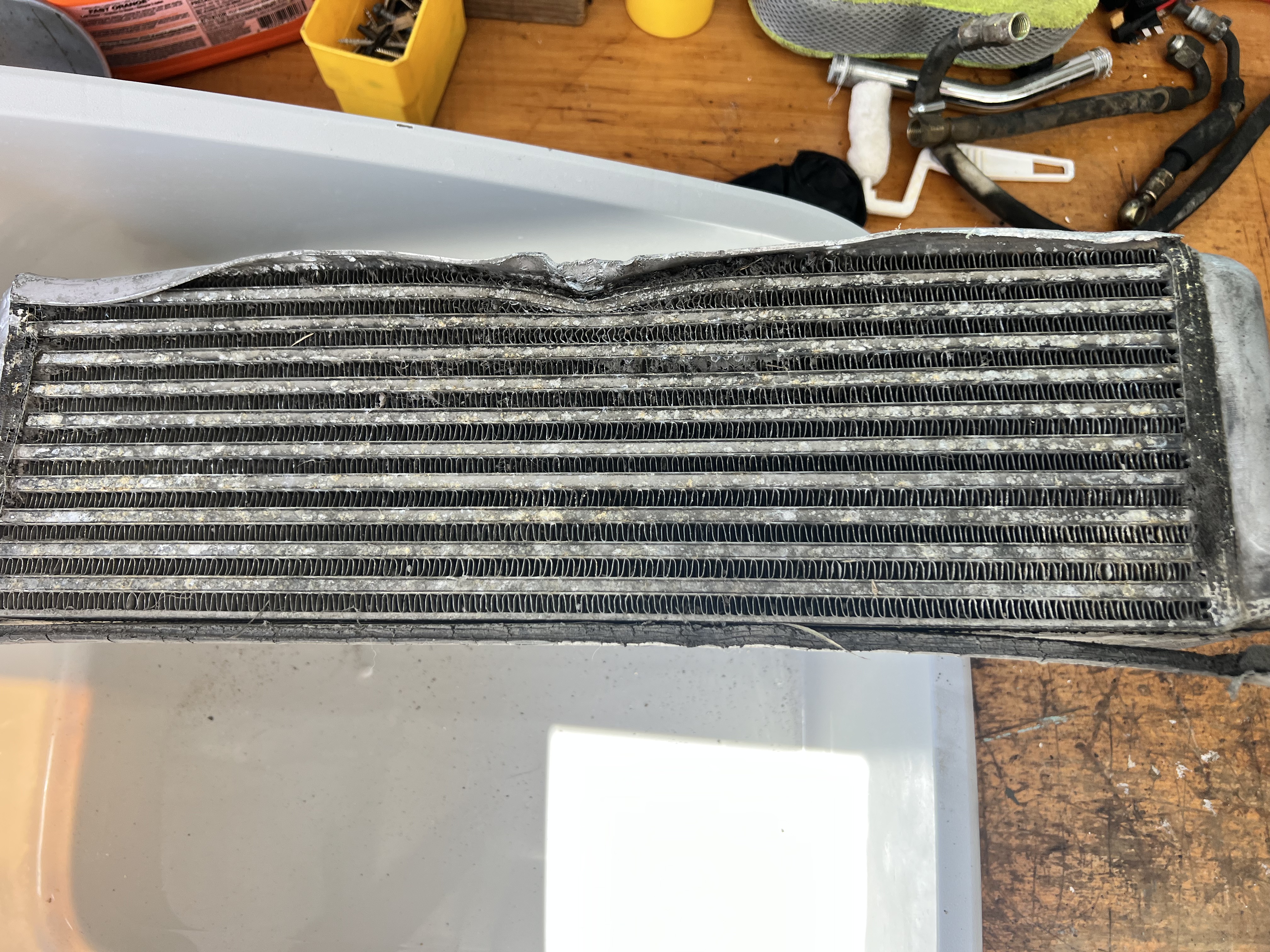

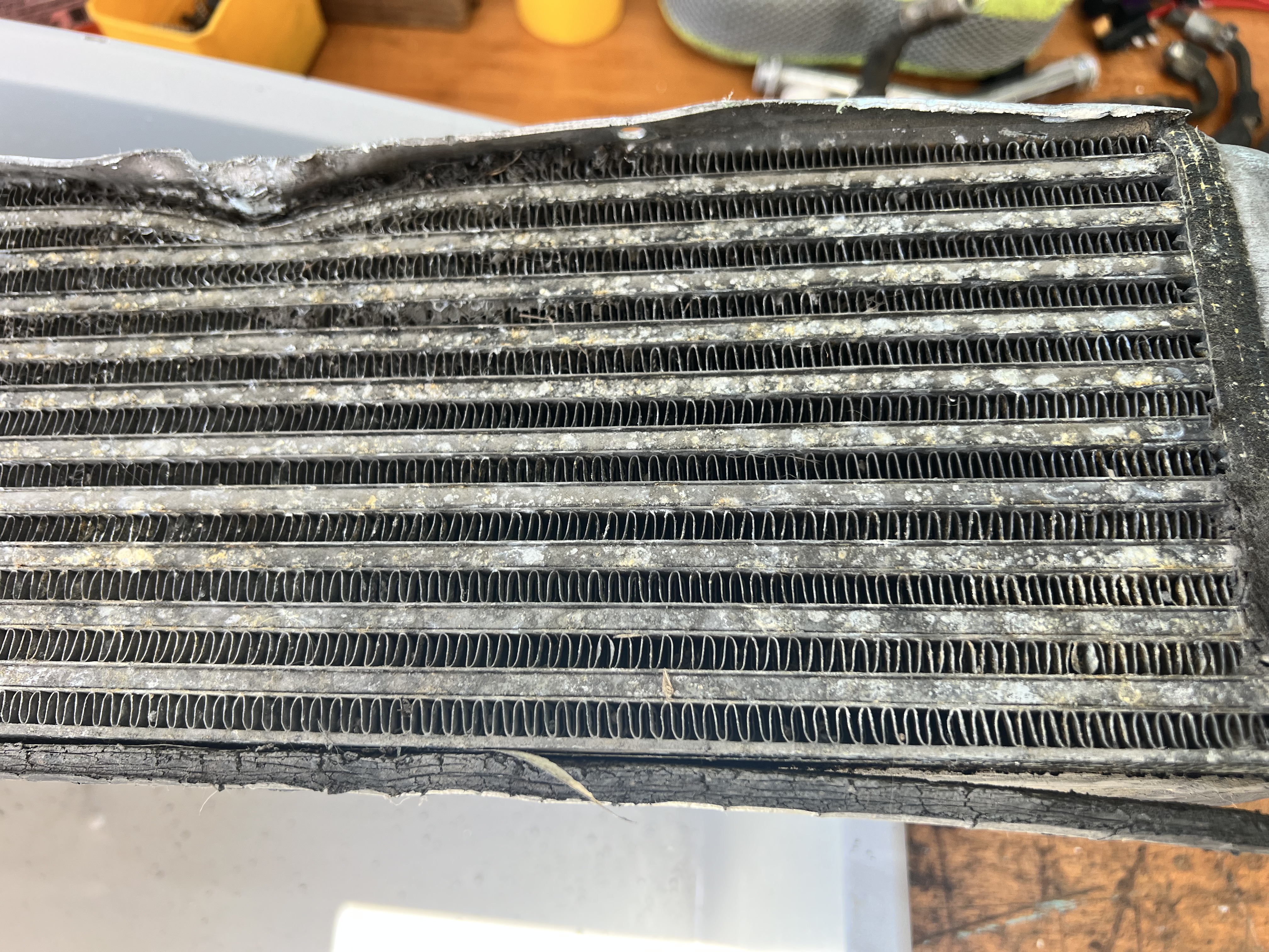

I removed the batch panel, and to my surprise, I found the intercooler has a somewhat large dent. Everything seems to be working, but obviously this is not optimal.
Should I replace the intercooler with a "factory" used one or an aftermarket one? If there is an aftermarket performance benefit now with the car stock, as I try to increase performance, at what point is a "better" intercooler needed?
Also, what is the recommended brand if not factory?

Wow, that's one banged up intercooler. I'd start by pressure testing it to see if leaks. If it leaks, it's probably a goner. If it holds pressure, and still fits, it's still probably works nearly as well as most. I tested intercoolers many years ago with pressure and temp readings and concluded the factory intercooler is much better than people give it credit for. Unless you had a good/specific reason to do otherwise, I'd just get a good used one on eBay if that one leaks. Heat soak was the one area where big aftermarket front mount intercooler win. So if you are tracking the car for instance, and need it to shed heat asap, a bigger intercooler may pay off. For a street car with a k26 turbo, there's no real need/benefit straying from stock. I've tried several SFR intercoolers over the years and ended up removing them all for various reasons, but if you could find their stage 1.5 intercooler, that would be my choice for the best drop in aftermarket. But, of course, there's this. Several places sell the modified end tank versions, but I've never seen any verifiable gains from any of them...

Thank you, I will pressure test this and see, if bad I will replace it with a used factory unit, they are not that unreasonable in price.
Also will keeping an eye out for an SFR 1.5 on the used market, I do not want the drama of having to deal with SFR.
