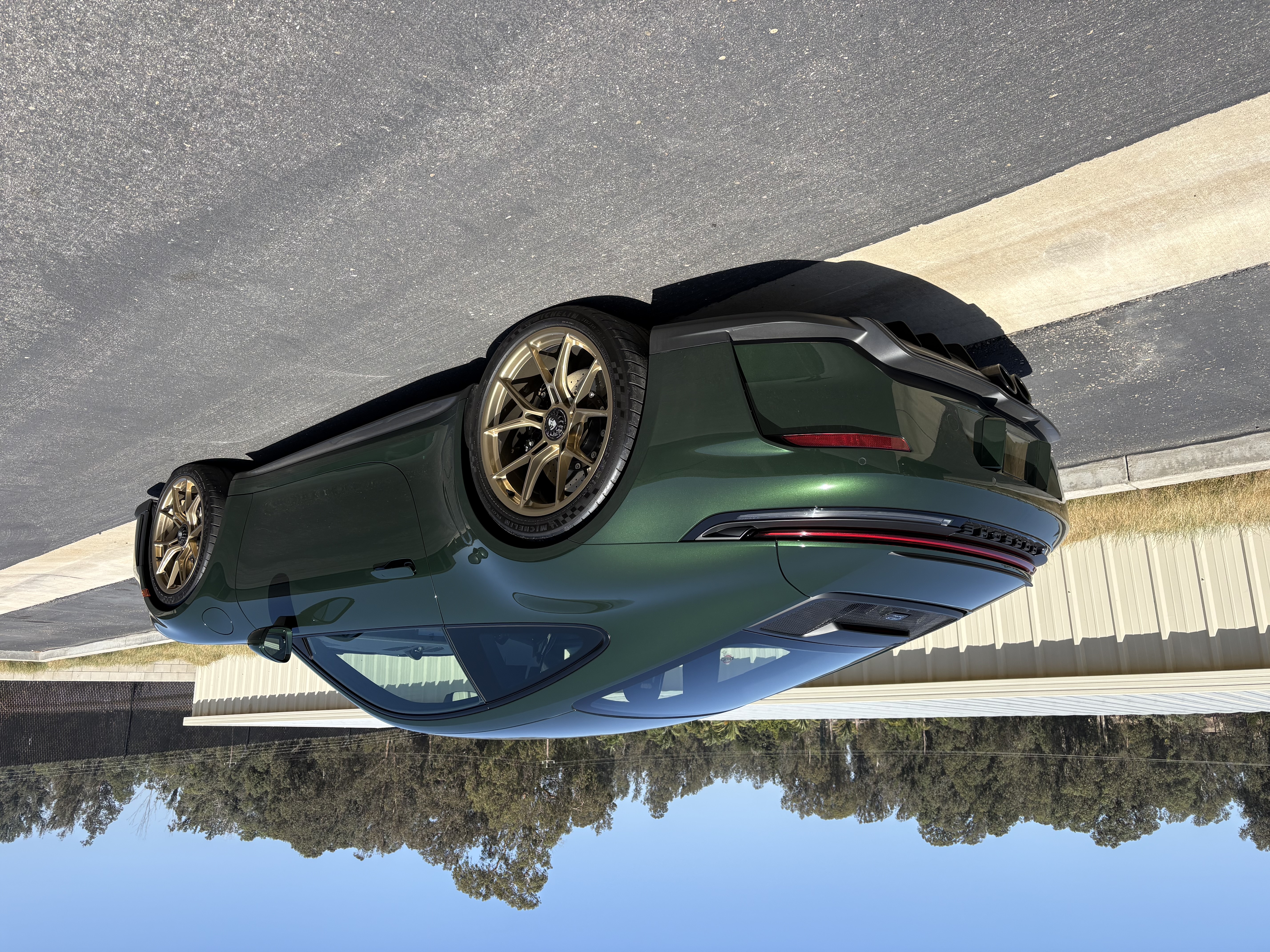

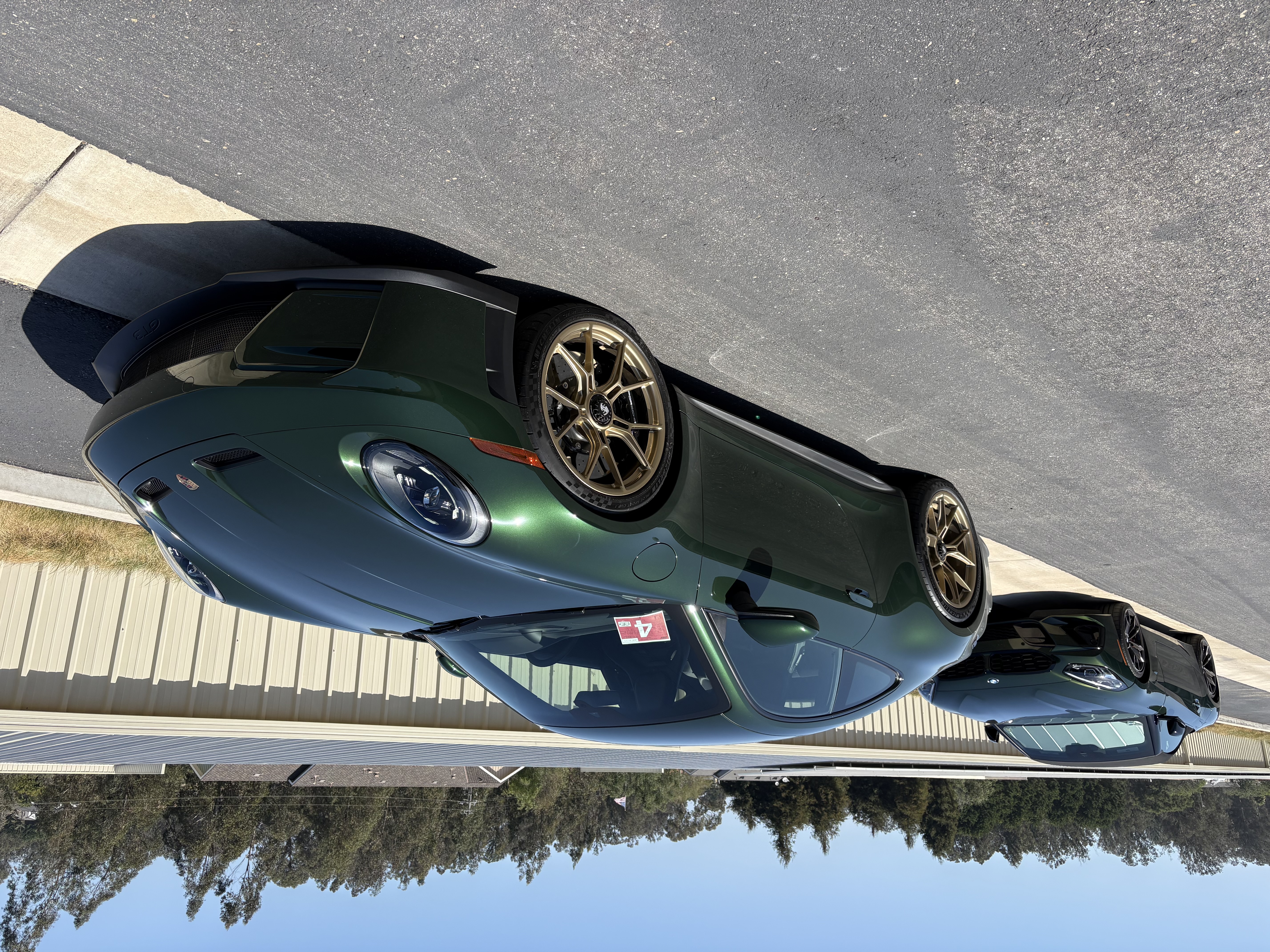

Thanks! Trying to get used to the LWB seats.
A popular colorway! Tom has posted a similar winged car.
