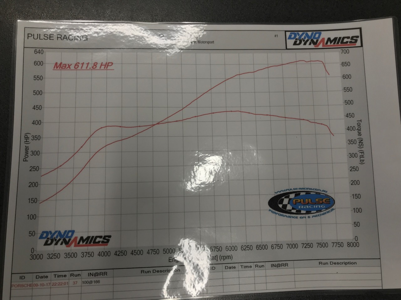

If you are not going for big power then you may want to go with an 8v head. These are real torque monsters and way more usable/fun on the street. The 16v will give you higher max hp that is only really usable on the track.
This is common knowledge in the 3L turbo community. Here is 1 small example.
16 valve head comes into its power band at a much higher RPM range compared to an 8 valve. Their port velocities are about 2k to 3k rpm apart both on intake and exhaust. They require a different mind set in selecting turbos and intake manifolds. Without variable cam timing and a good designed resonance intake manifold drivability becomes more difficult from the lack or l or lower bottom end. They will work great on the track if geared right for the right rpm drop. For a milder built and better drivability the 8 valve is the way to go, simpler and more compatible for an all out build.
Well speaking from my experience of owning both larger sized 8v (3.1ltr) and 16v (3.2ltr) race motors and also being a highly impressed passenger in Thom's 3lt 16v street car, I would say that there may be some truth to the concept of the 8v developing tq earlier in the rpms however with modern turbos, ECUs, fuel and spark control that disparity is pretty easily overcome these days. See attached dyno chart showing a very healthy tq curve (at the wheels) in my 16v motor at less than 18psi. There's no doubt that making a 3lt 8v street motor is potentially much more affordable though. As always, it often comes down to desired use of the car (and where it will be driven most often) and budget. The added caveat is how much someone is going to charge you to build/tune it vs how much of the work you can do yourself. Plenty of clever people in this forum have put their own engines together and can advise you accordingly (if the info is not already in here and elsewhere). Oh, and Thom can also speak about the differences based on his previous big bore 8v motor so I'd tap into these people for very relevant information.
- 3.2 tq.jpg (211.22 KiB) Viewed 552 times
