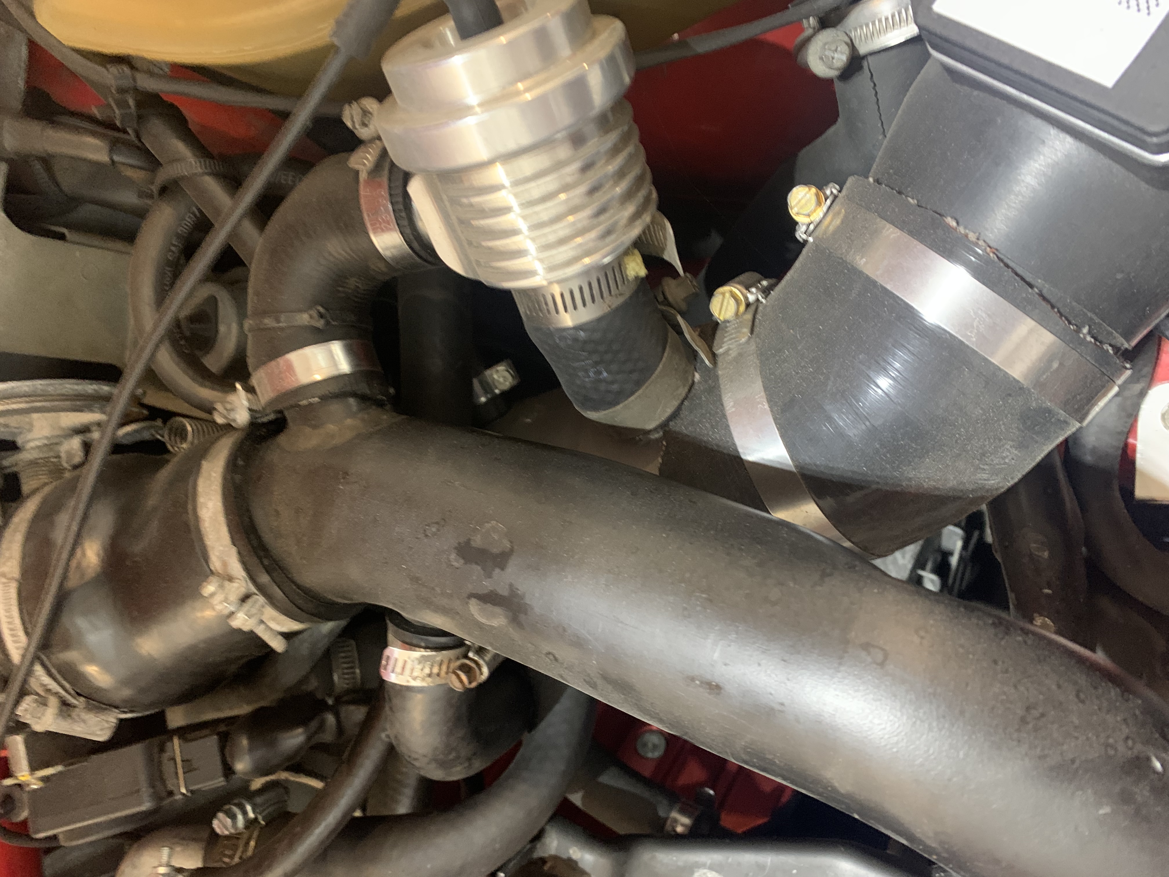

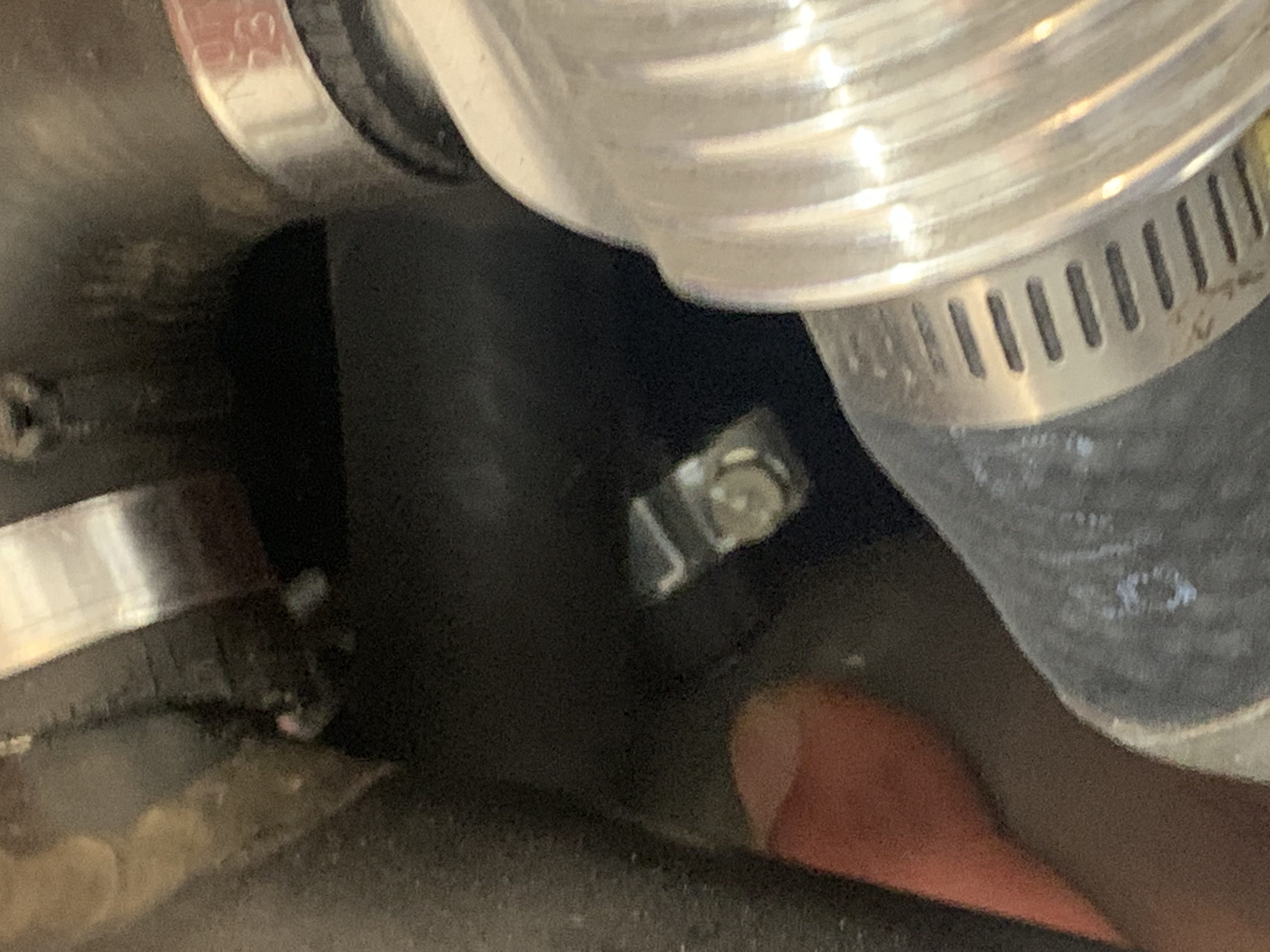

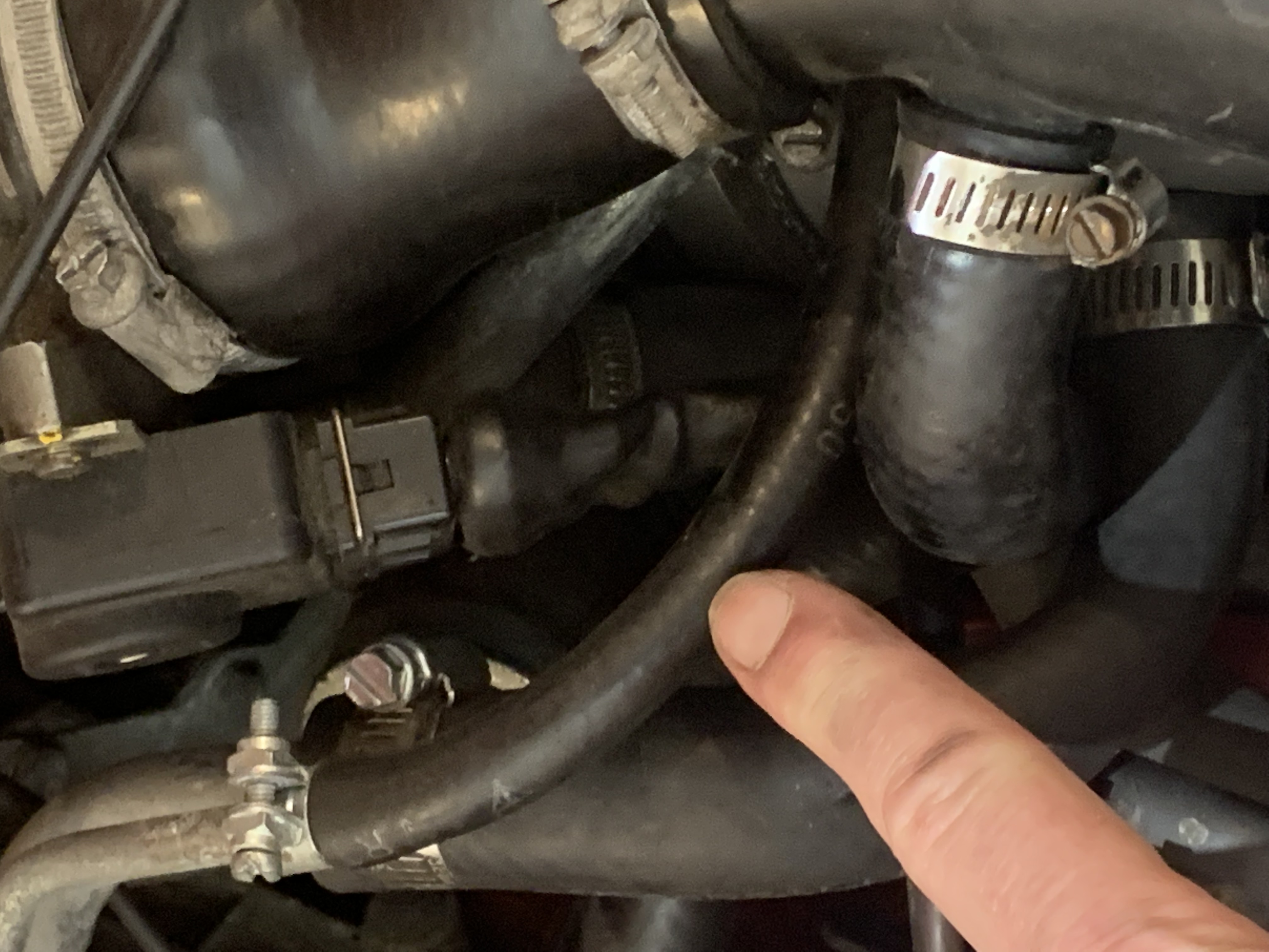

Is this the line at the j-boot (now the vitesse MAF pipe).

The Vitesse J-pipe has 3 fittings:
- Crankcase vent hose
- BOV
- Emissions hose
The CV has 3 hoses:
- IN pressure: from IC pipe.
- OUT signal: to top of WG.
- VENT: to J-boot or shared fitting at J-pipe (emissions port).
99.9% of customers no longer use the stock CV. For those that do use the CV, they "T" the CV vent hose with the emissions hose so they can share the same port on the J-pipe (nearest the turbo).
In your pictures you point to the "emission hose port". When eliminating the CV, you disconnect the CV vent hose (and plug it). Remove the "T" fitting, the emission hose must remain connected to the J-pipe.
Ideally when going to an MBC or EBC, you want to remove the CV and its associated hoses. If you prefer to keep the CV, just disconnect and plug its hoses. Make sure to disconnect the CV electrical plug.
