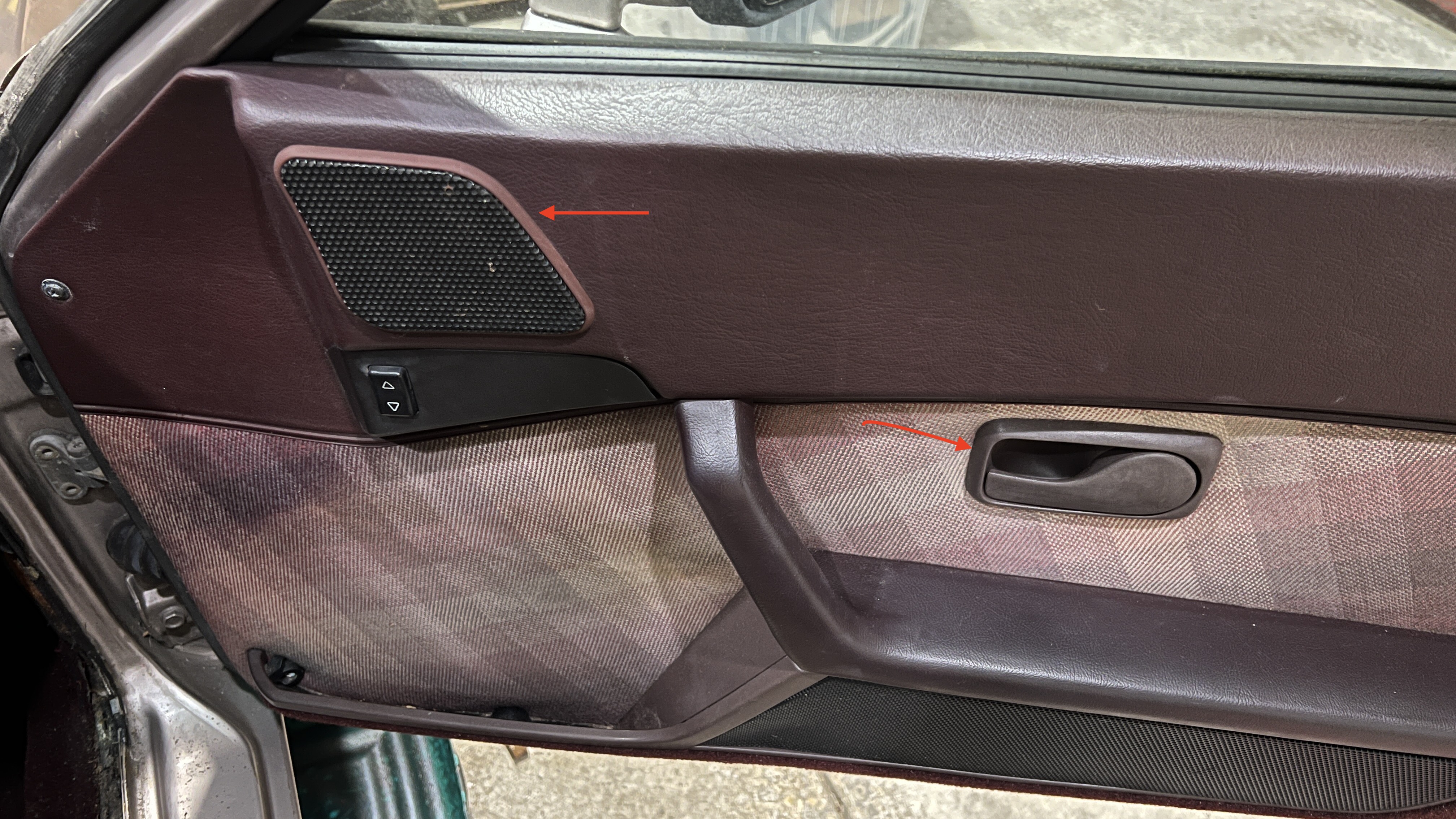

In restoring my burgundy interior, and I want to re-dye/paint faded plastic parts.
I read that ColorBond interior paint is good for this.
Selecting the closest matching color (1988 Porsche), gives me: "Porsche Magenta Red".
https://www.colorbondpaint.com/product/ ... agenta-red
Has anyone used this product? How is their match, and how is the final result in terms of quality/durability?
