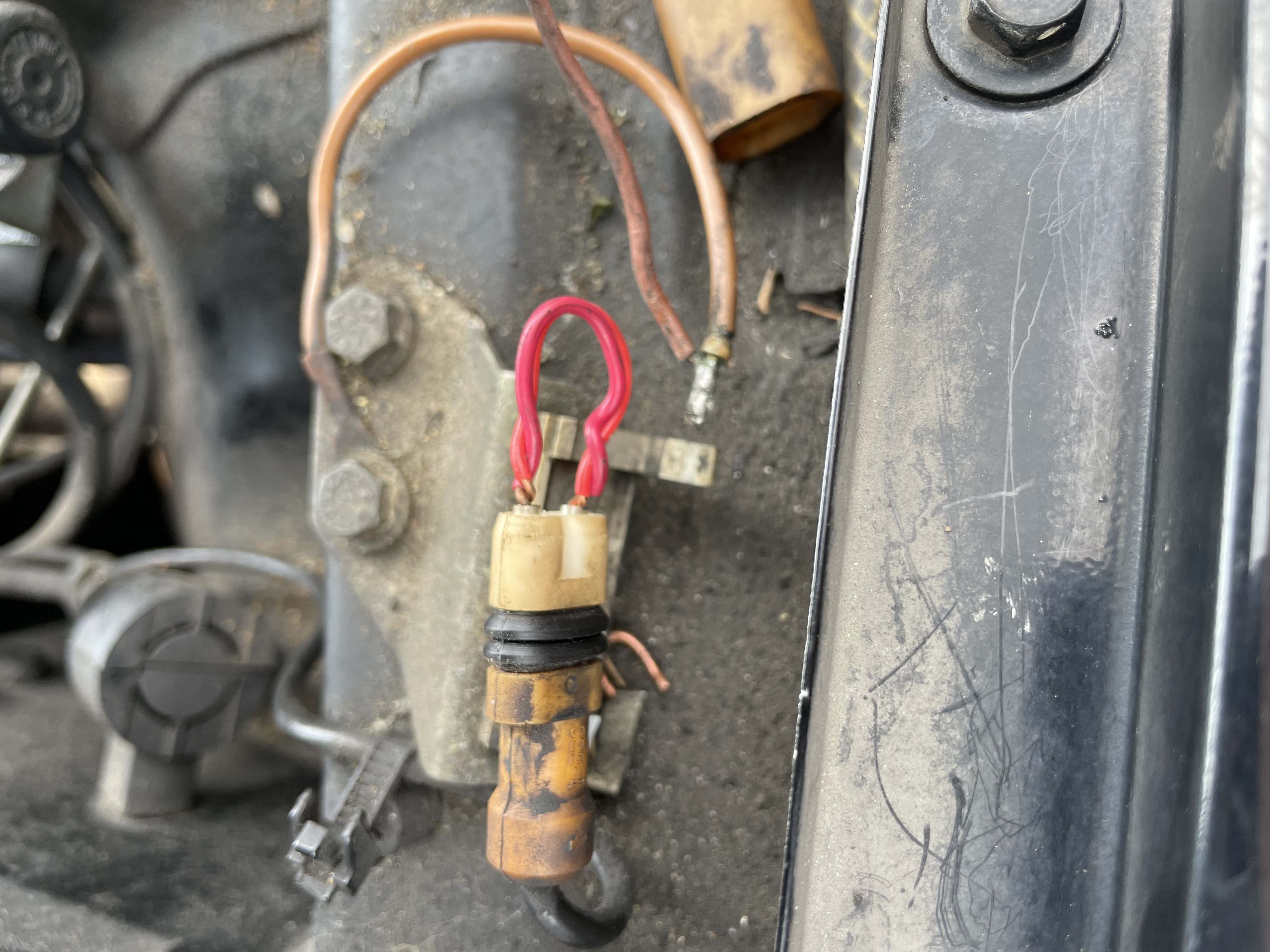

For months, the light stayed off with driver's side harness shorted
I tore out the passenger wires the other day (fender cover off and might as well clean up all these dried out crumbling wires) and shorted the harness plug
Light comes on
This is clearly more complicated. Something to do with ground? Each harness plug has a ground connection next to it. Why?

With all the wiring intact, you can just short the ends of the individual sensors. Looks like you removed some of the harness, where you are probably getting into trouble. I'm guessing your shorting wires on that side are not picking up the two wires at the end of that sensor (?). If you cut the end of the senor off and find the two wires that get disconnected when worn, you could then ohm them out to the wires you need to connect in the remaining harness, if that makes sense.
The sensors are wired like old-school Christmas lights --in series-- so that if any one goes out (wears down), the entire circuit is open and the dash light goes on. As best I can tell, with only moderate confidence, those wires are just creating that in-series circuit so that the cluster doesn't need multiple inputs. The extra ground wires appear to ground the wheel assembly and side markers. Looking at the schematic, it looks like you can bypass all 4 sensors by connecting the brown wire with white stripe in the front right harness with the brown wire with red stripe in the rear left sensor harness. Doing that would bypass all 4 sensors. You can get to both of those wires easily at the cluster -- they are pins 6 and 7 of the A edge connector. Basically, if pins 6 and 7 are not connected (via all 4 sensors in series, or bypassed) the light goes on. If you were to short those two pins together, based on my reading of the schematic, it should bypass all 4 sensors. Never tried it though... I can test that on a spare cluster if helpful...

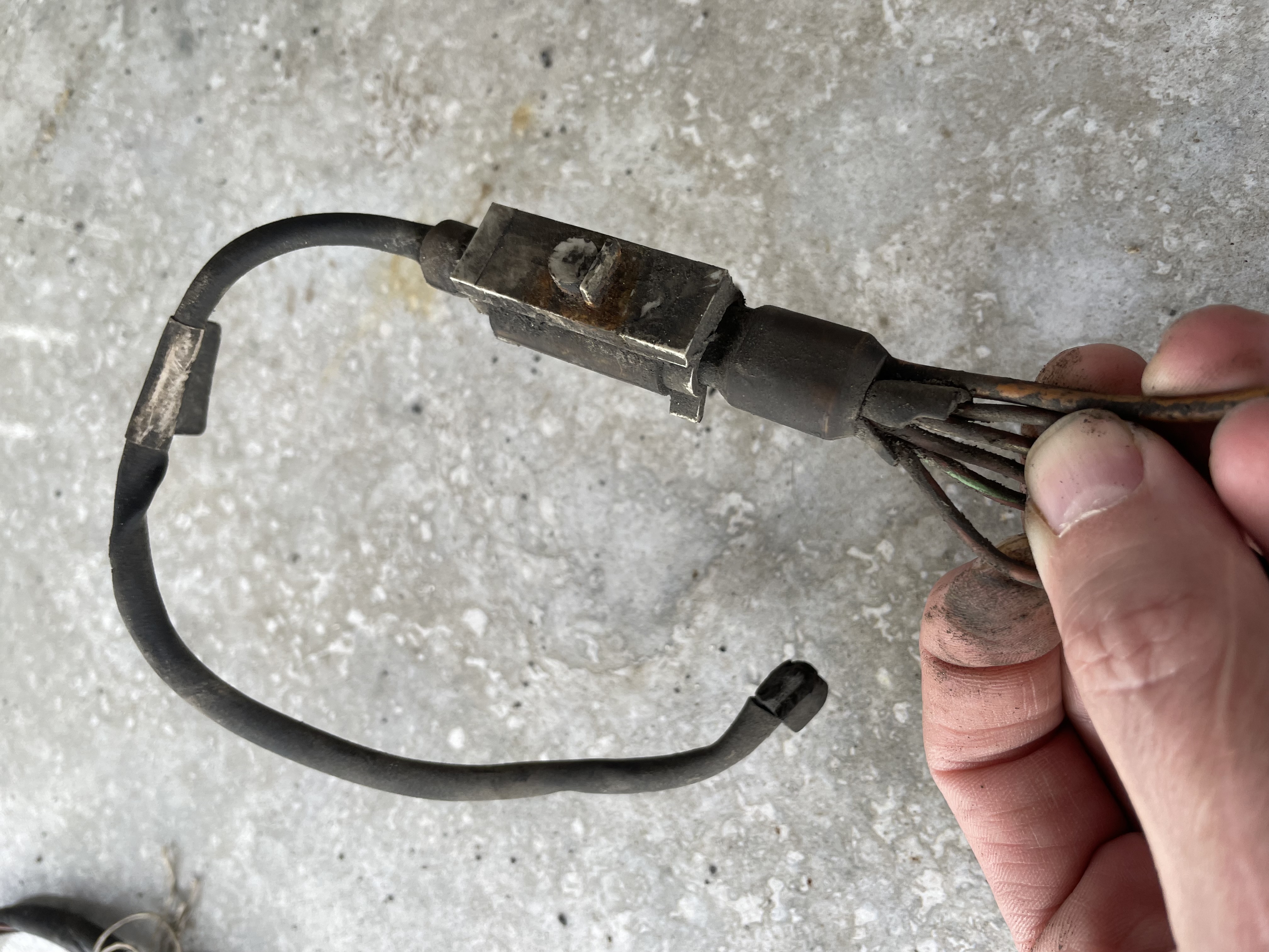

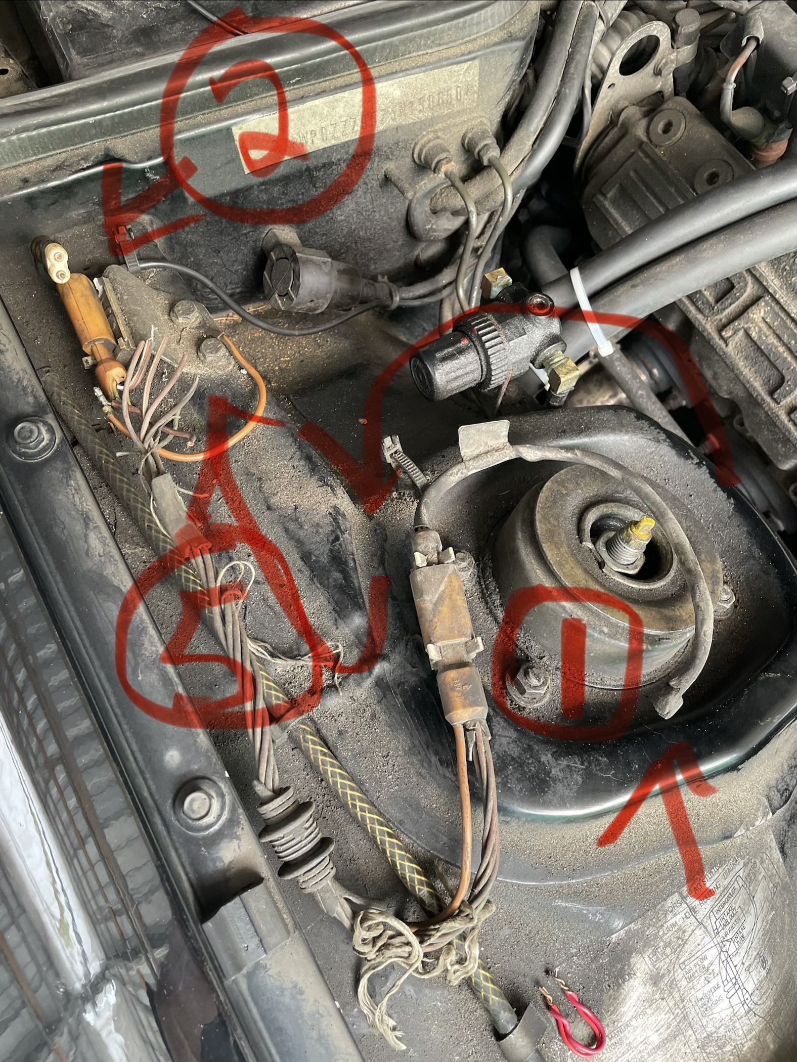

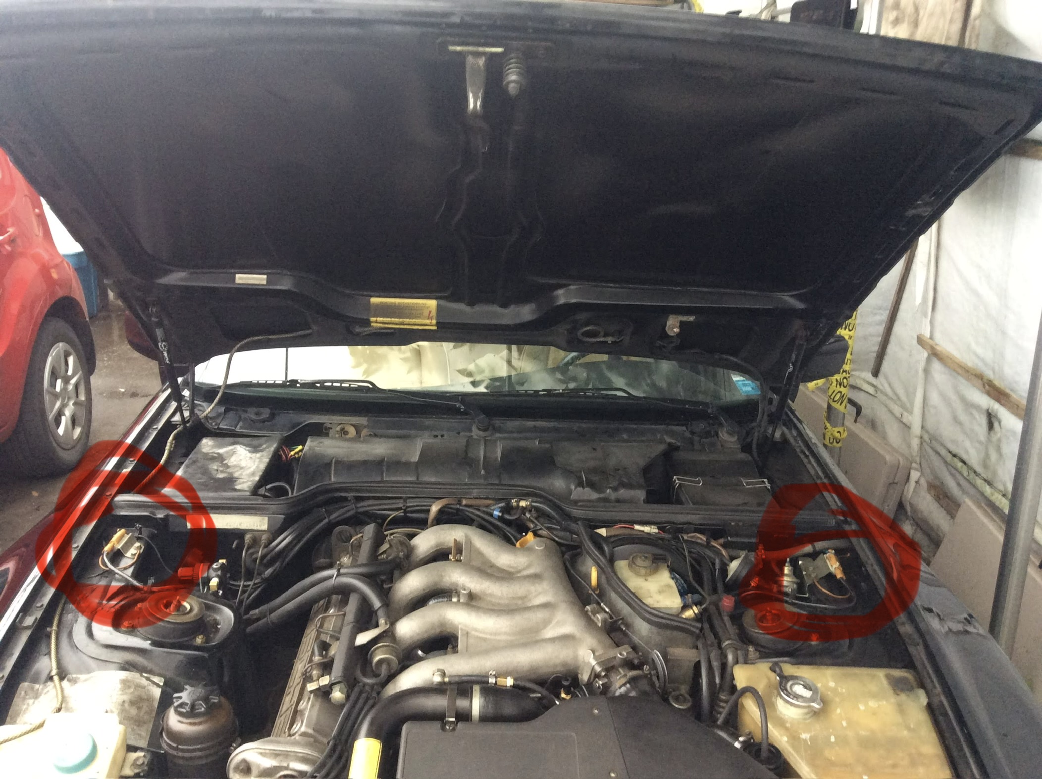

Here are the harnesses:

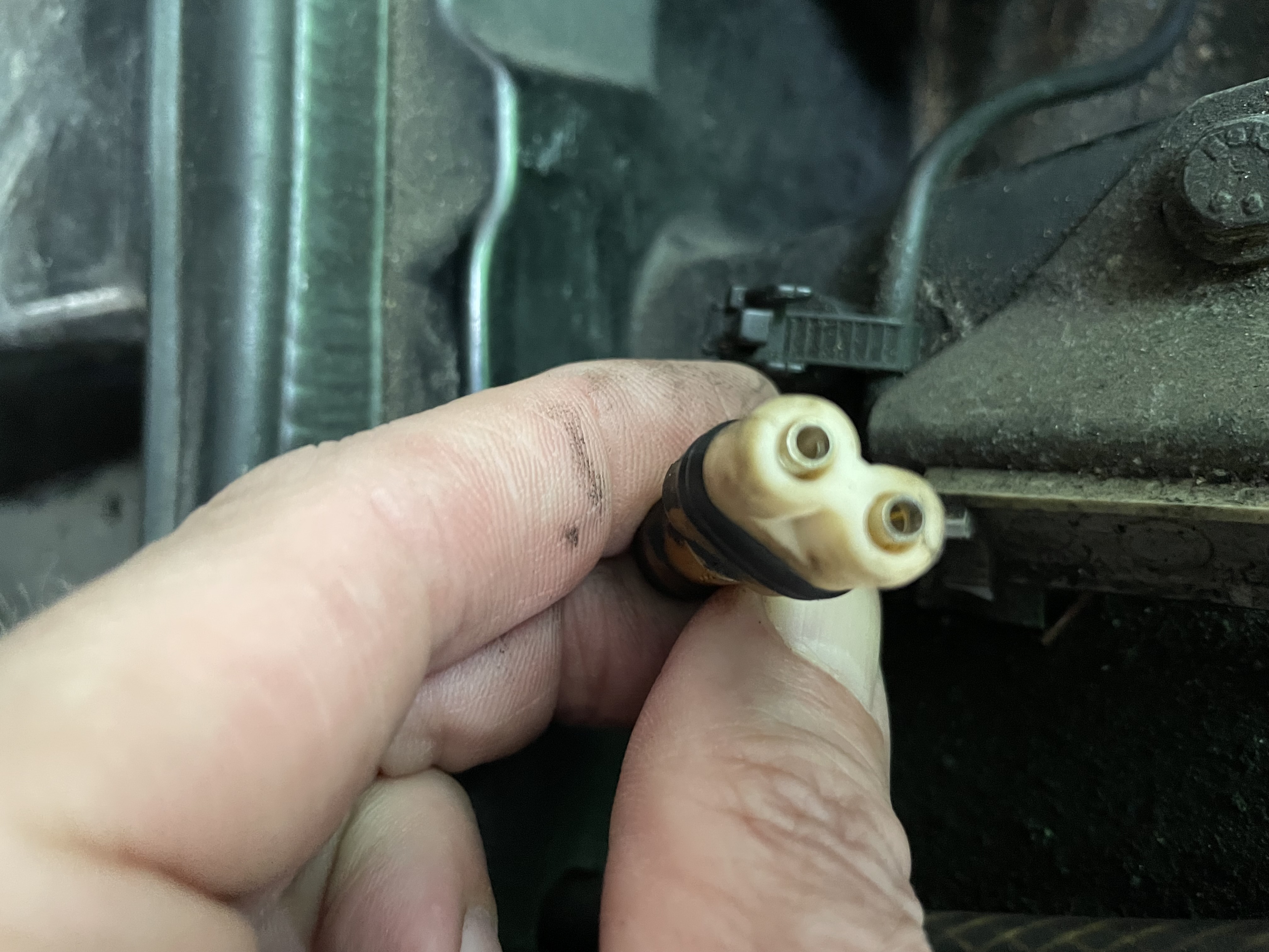

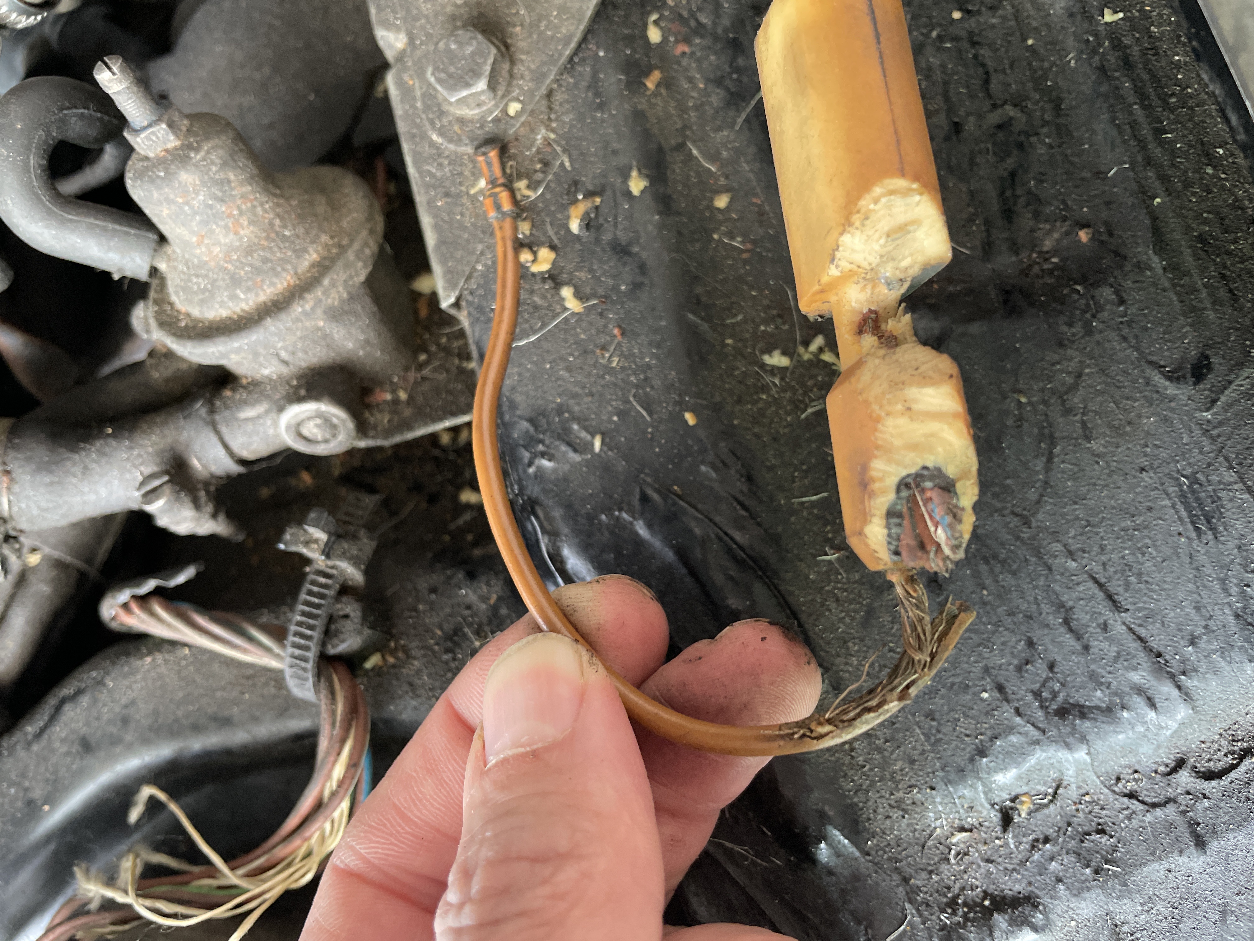

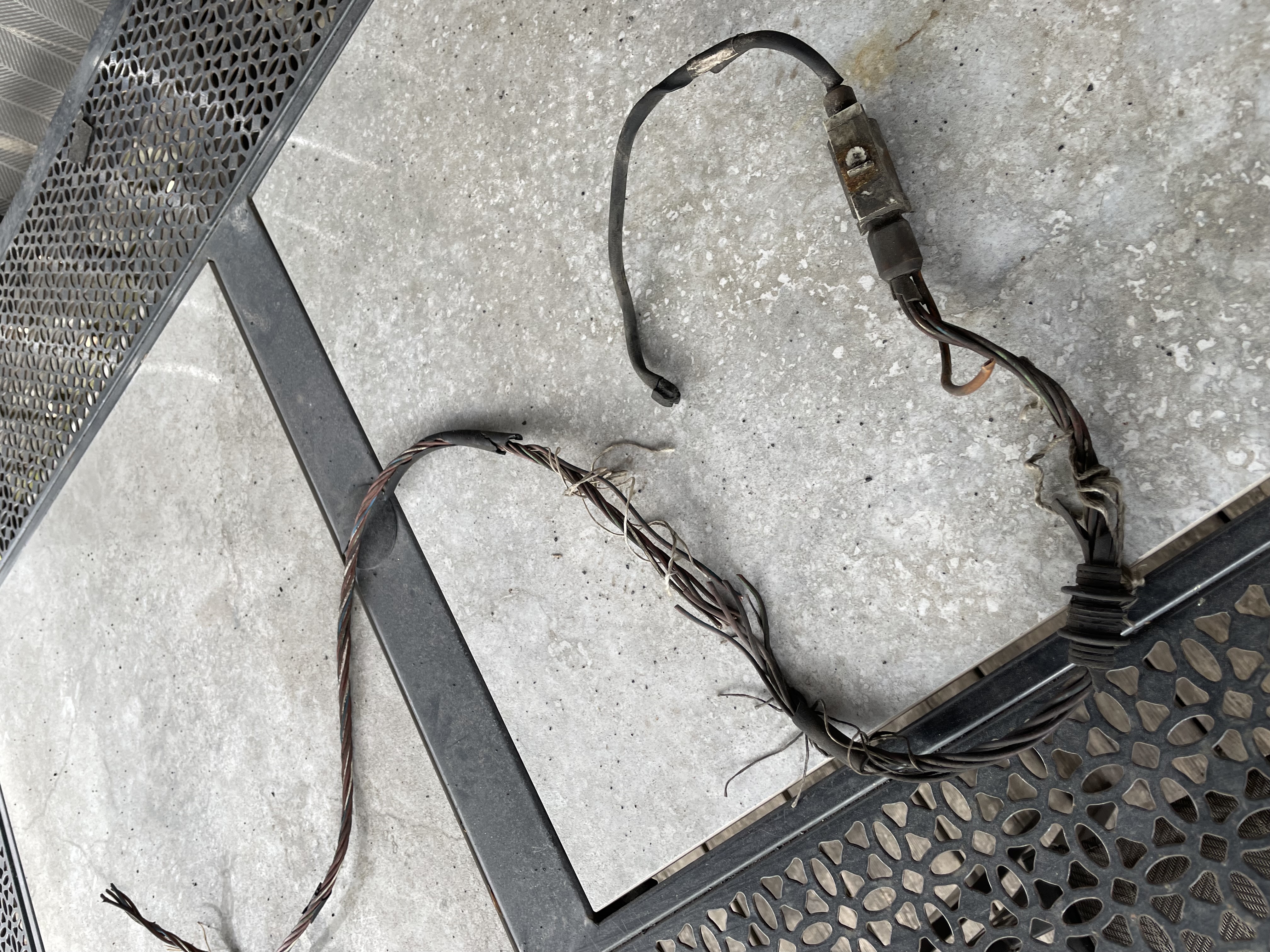

And here is what I am calling the sensor wire:
I have removed all the wire up to the harness. The wire had connections at the strut and on the body behind the strut
Starts as you say 2 wires at sensor end.. connects to a 5 wire loom at strut.. the 5 wire loom goes up into the engine bay.. and plugs into this:
The ground wire comes out of the loom plug and grounds at the body
Nothing else connects here--no lights, etc
This is repeated identically on the other side

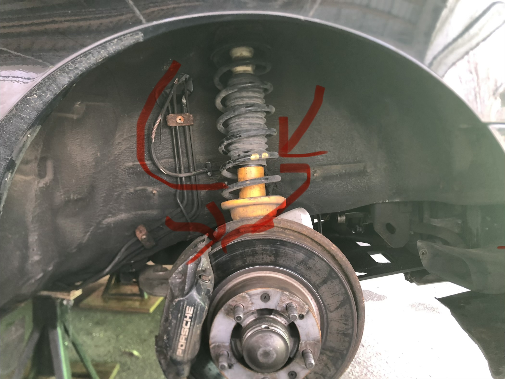

FYI the rear sensor wiring is still present.. unsure of its condition. Maybe I should find their barrels and short them too
