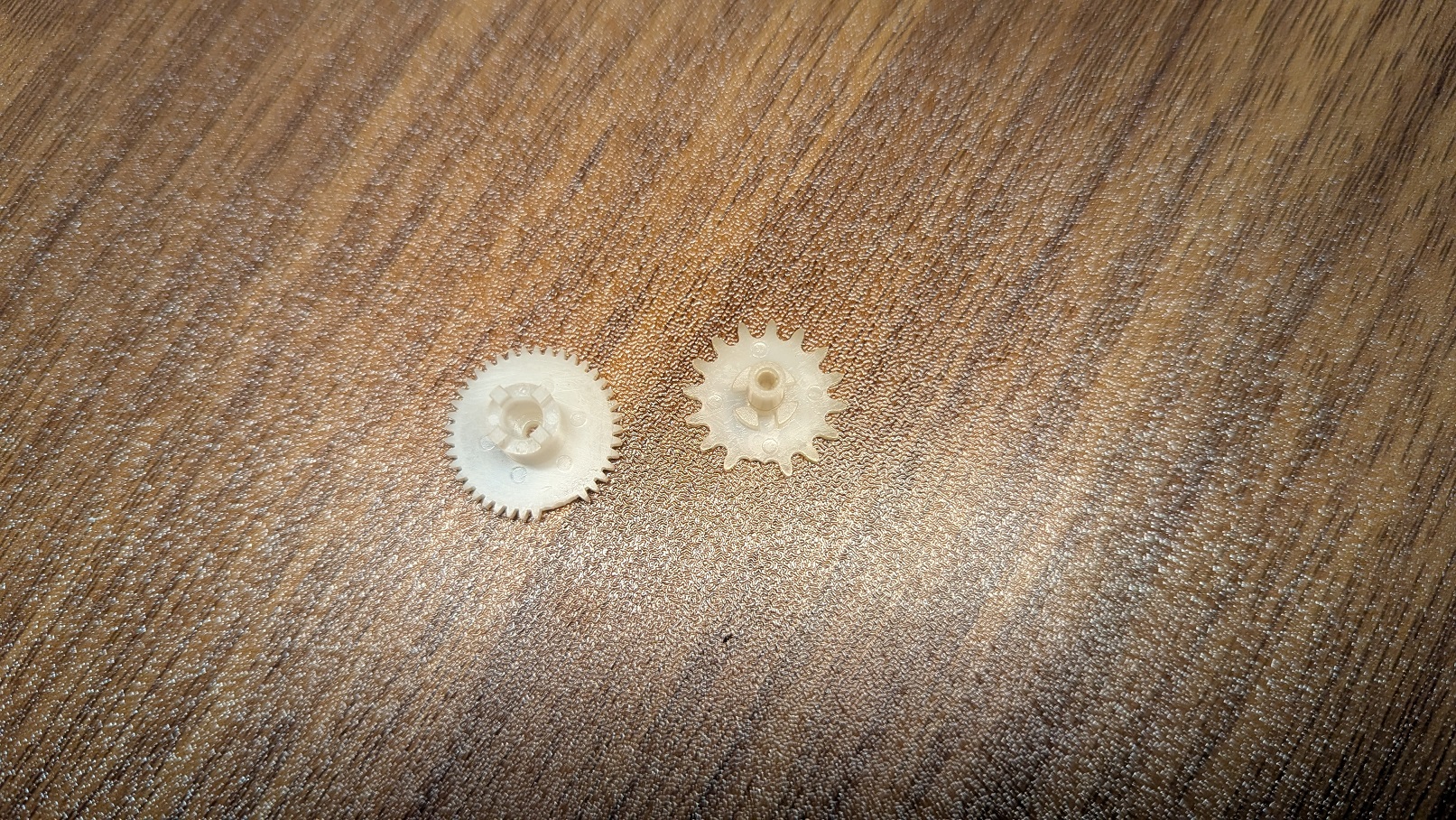

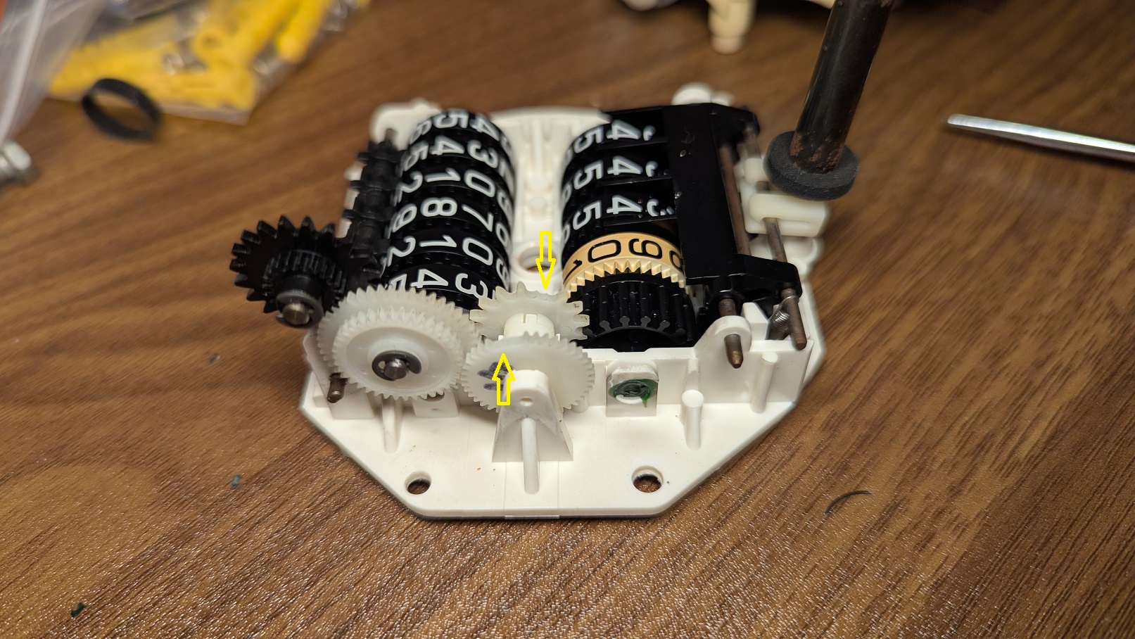

Does anybody have any leads on where to get these two gears that sit in between the odometer and the tripometer? both of mine are broken. They appear to be 41 teeth and 16 teeth. The yellow arrows point to them in the second picture where the teeth are broken. Thanks for any input!

I believe there are a few topics scattered about in the Trasnsaxle sub-forum regarding odometer gears and their replacement. In addition, I'm sure other Carpokes members will have more info, including where replacements might be found.
Also, the "3D Printing & CAD Files" sub has a long thread that will likely help too.
https://www.carpokes.com/viewtopic.php?t=900

Yeah, I'm not aware of any source for those gears. Used parts are probably the path of least resistance for now, and honestly those gears tend to outlive the rest of the gauge -- your results notwithstanding. That's not to say new ones aren't out there somewhere, but I've never seen them marketed for the 944. The whole gear set is on my list to model and print (someday), which I'm hoping to do as a universal replacement set so that people don't have to count teeth....
