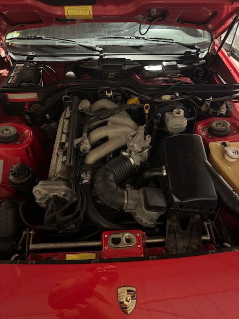

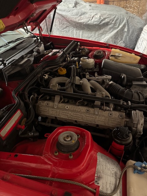

Just a quick word about the fuel lines. On the 924S as you can see on the photos, they don't run over the exhaust side of the engine, but come up on the intake side, so there's less risk of a sudden catastrophic fire. It's of course still a good idea to replace them, and I did mine with the Rennbay kit which I bought fromm 944online. It has been working leak-free from the start, so I'm very happy with the kit.
