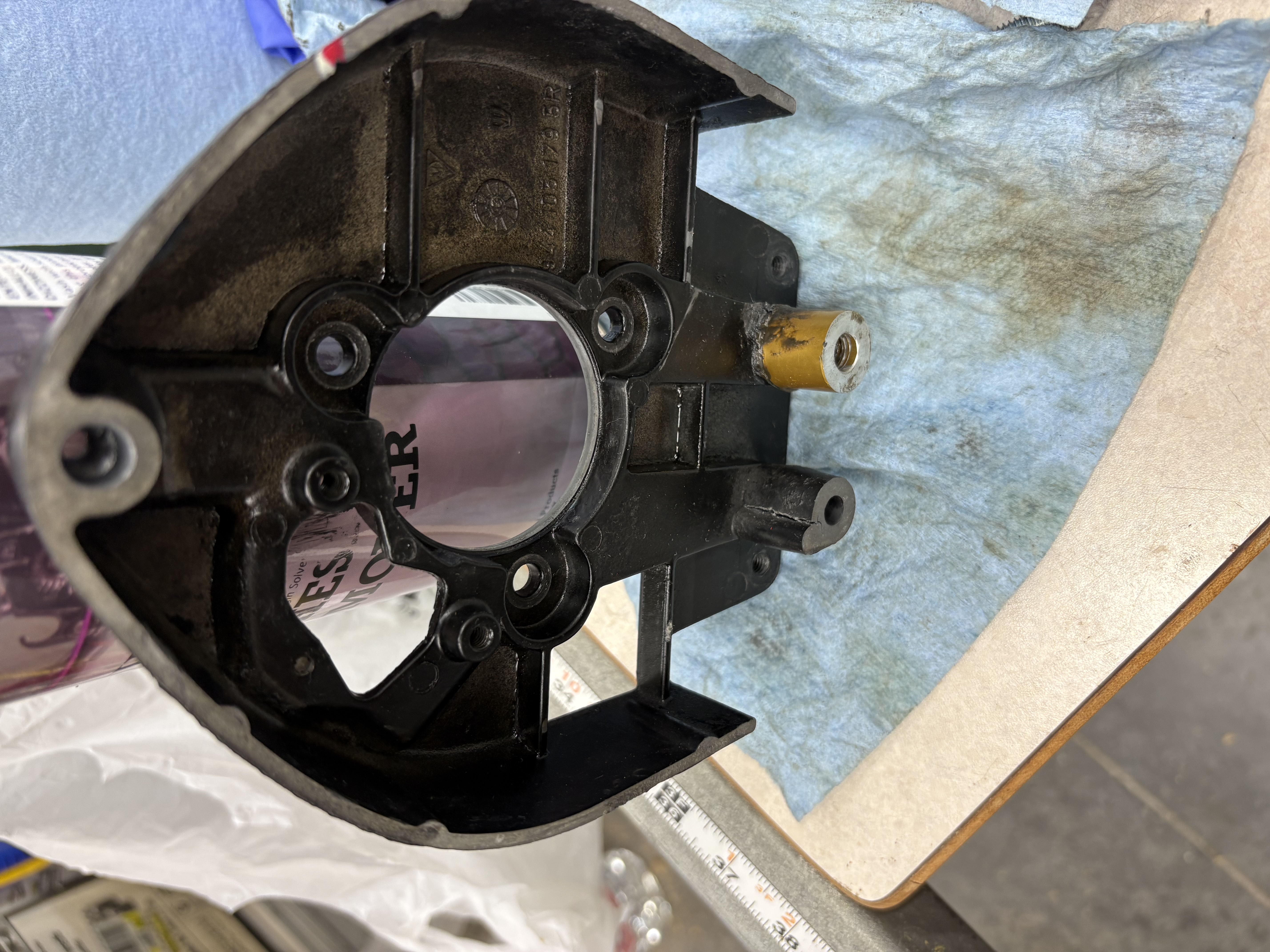

Thought it would be fun to start a thread where people can share the worst of their previous owner's work. Post up your most cringe-worthy find!

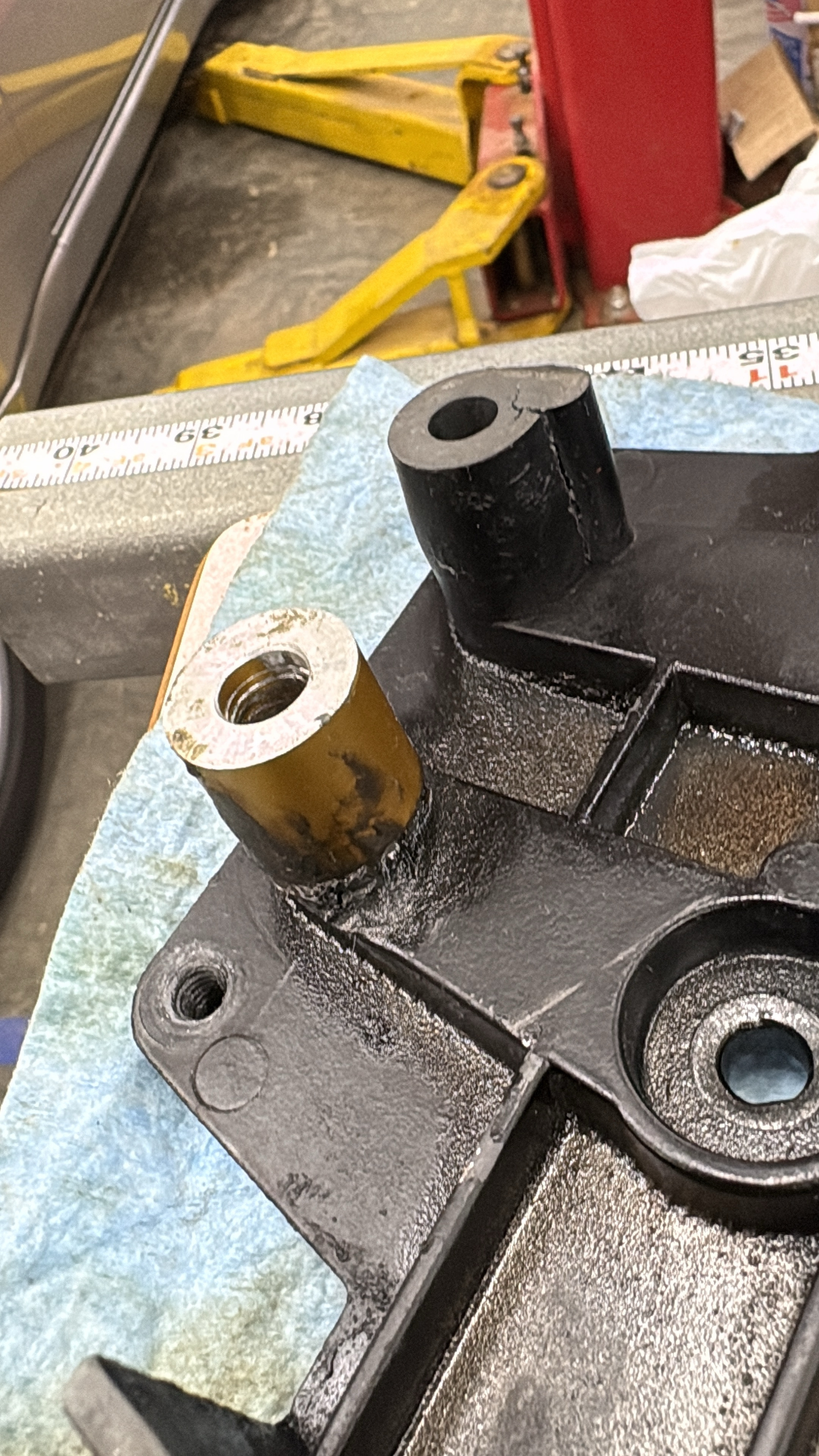

I'll kick it off with this 944 timing belt spring tensioner -- i.e., the thing that prevents the 944 motor from self-destructing. I was helping a friend do the belts on his car recently when we discovered the spring tensioner had a very quirky feature. The car had apparently been driven like this for years...

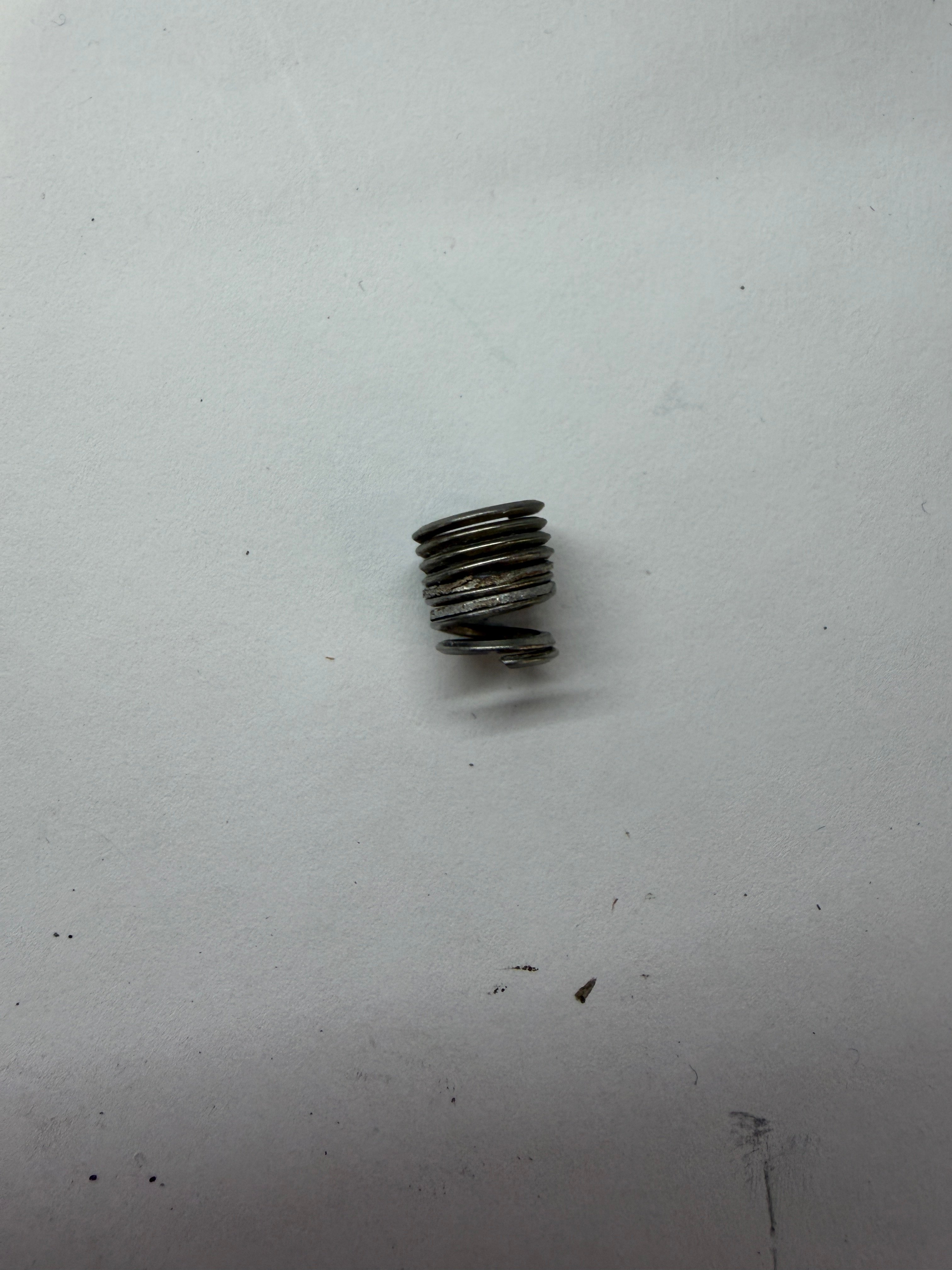

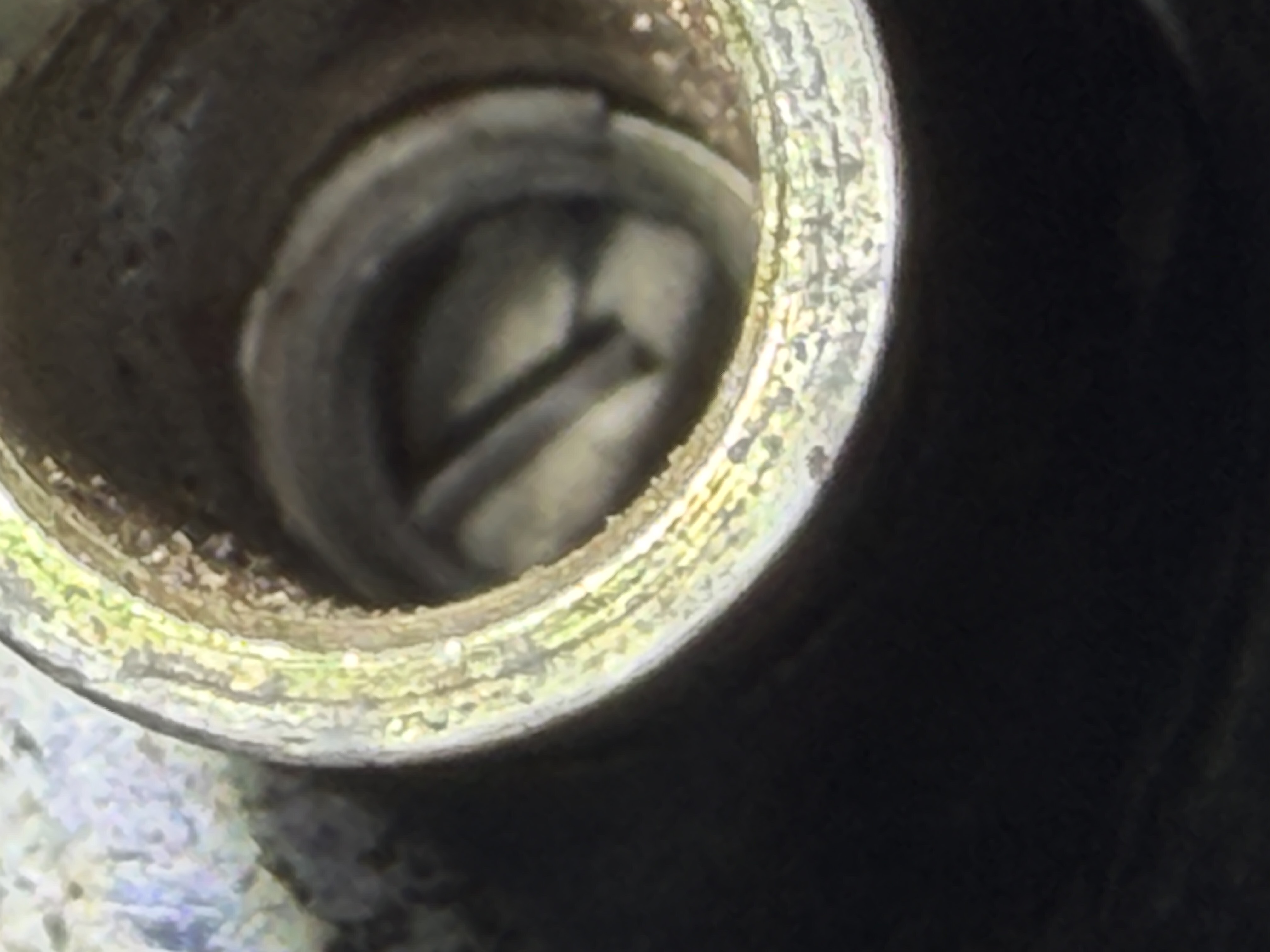

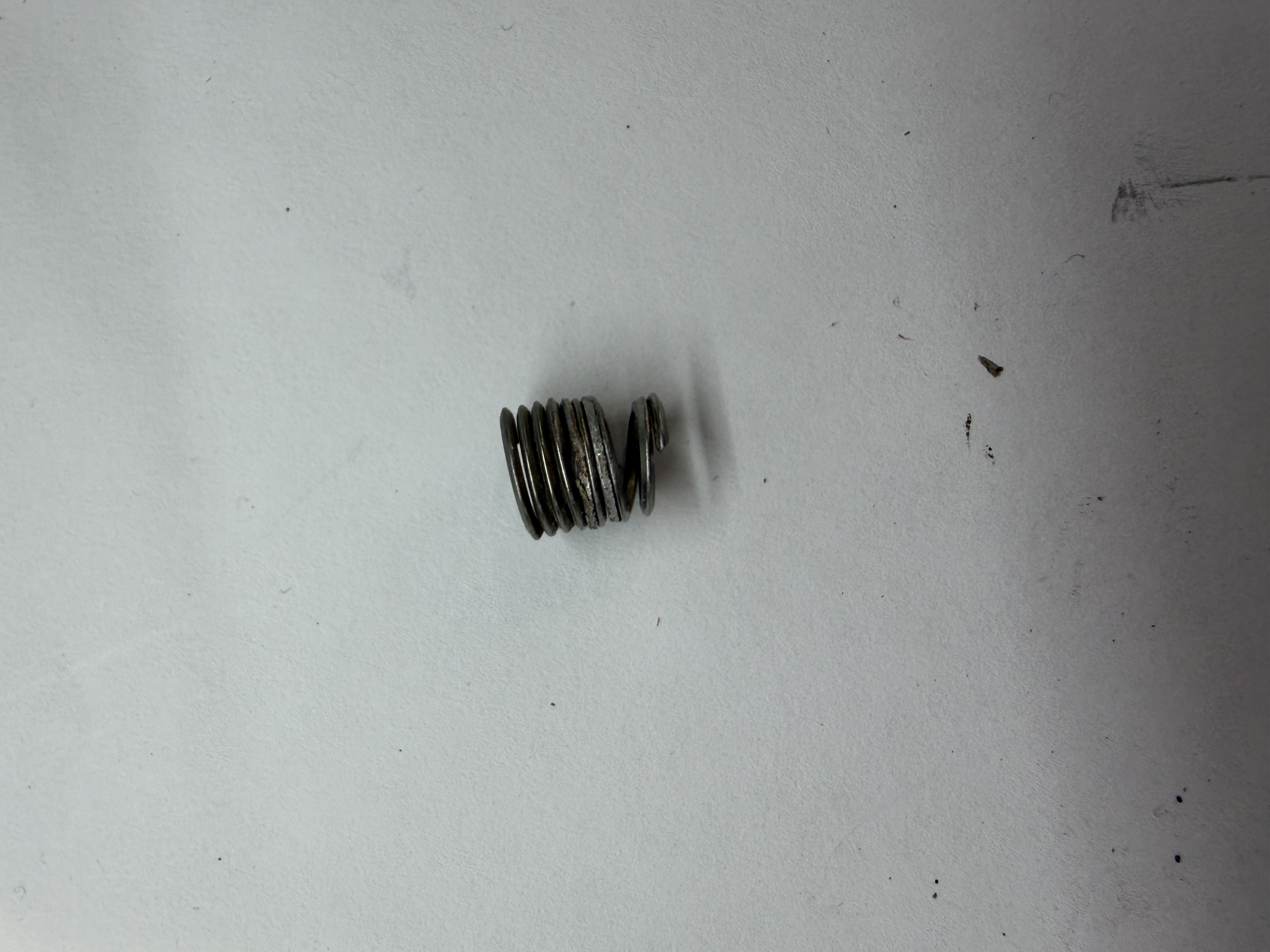

Turns out, the threads that stud screwed into were stripped and someone made the world's worst helicoil repair. Only about 2 threads of the helicoil were actually engaged in the casting -- the rest just sat free inside the locating/pivot tube. The stud was screwed into the free-floating helicoil and got wedged at the bottom -- which explains why the stud felt like securely attached bobble head. The more amusing part is that the PO apparently thought that was good enough, so ran the car like that for years.
Note the installation tang still attached! It was a bear to remove the press-fit pivot tube to repair the thread, and even more so to get the whole thing back together, but I'll do a separate post on that soon since I couldn't find a peep on the internet about how to disassemble and reassemble these things...

That "repair" on the pivot bolt is just wild! Really surprising that it didn't come loose.

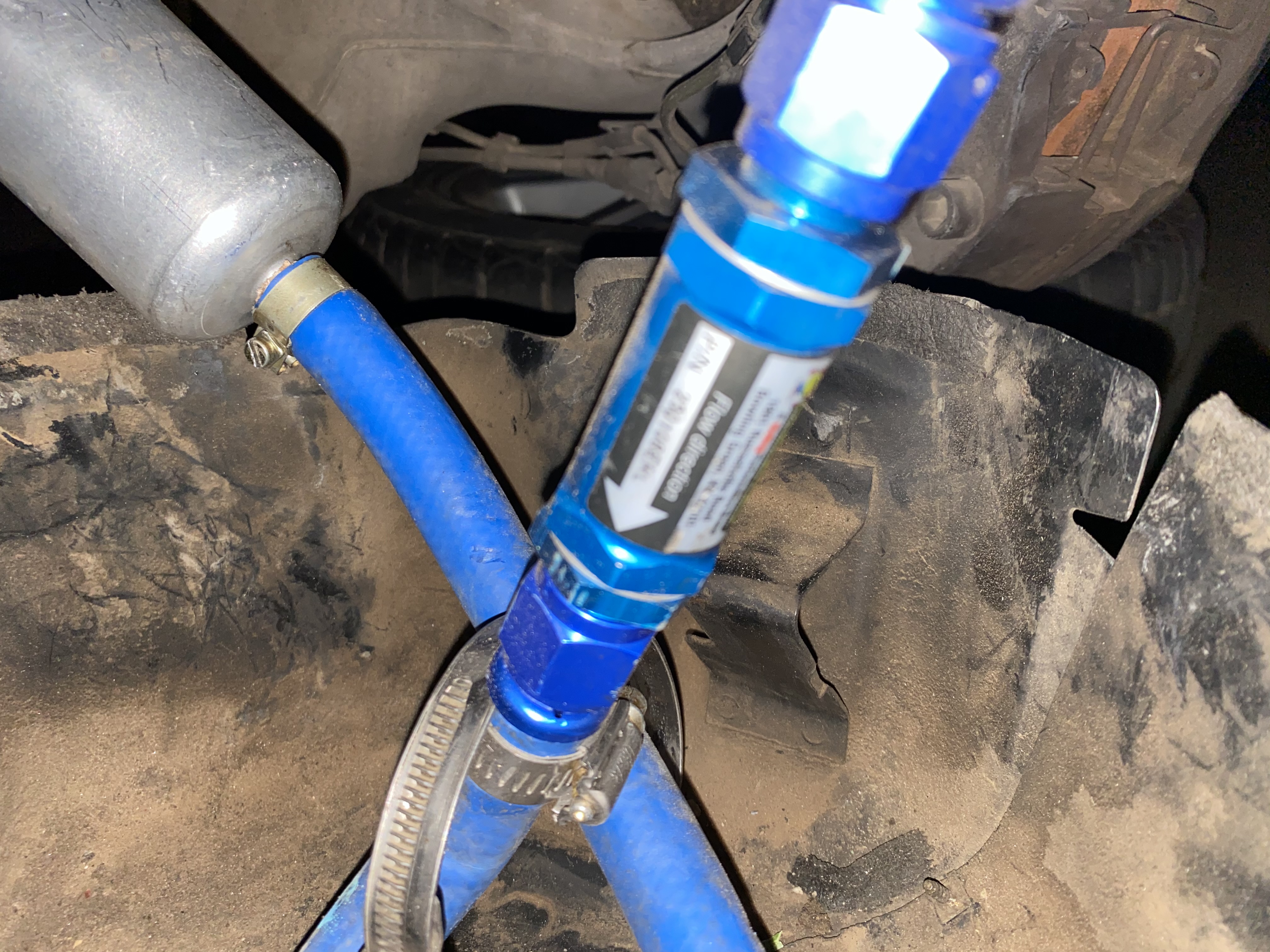

He did have his brother sell the car for him. The brother decided to put in a new fuel filter. As in - add a new few filter not replace the old one….
