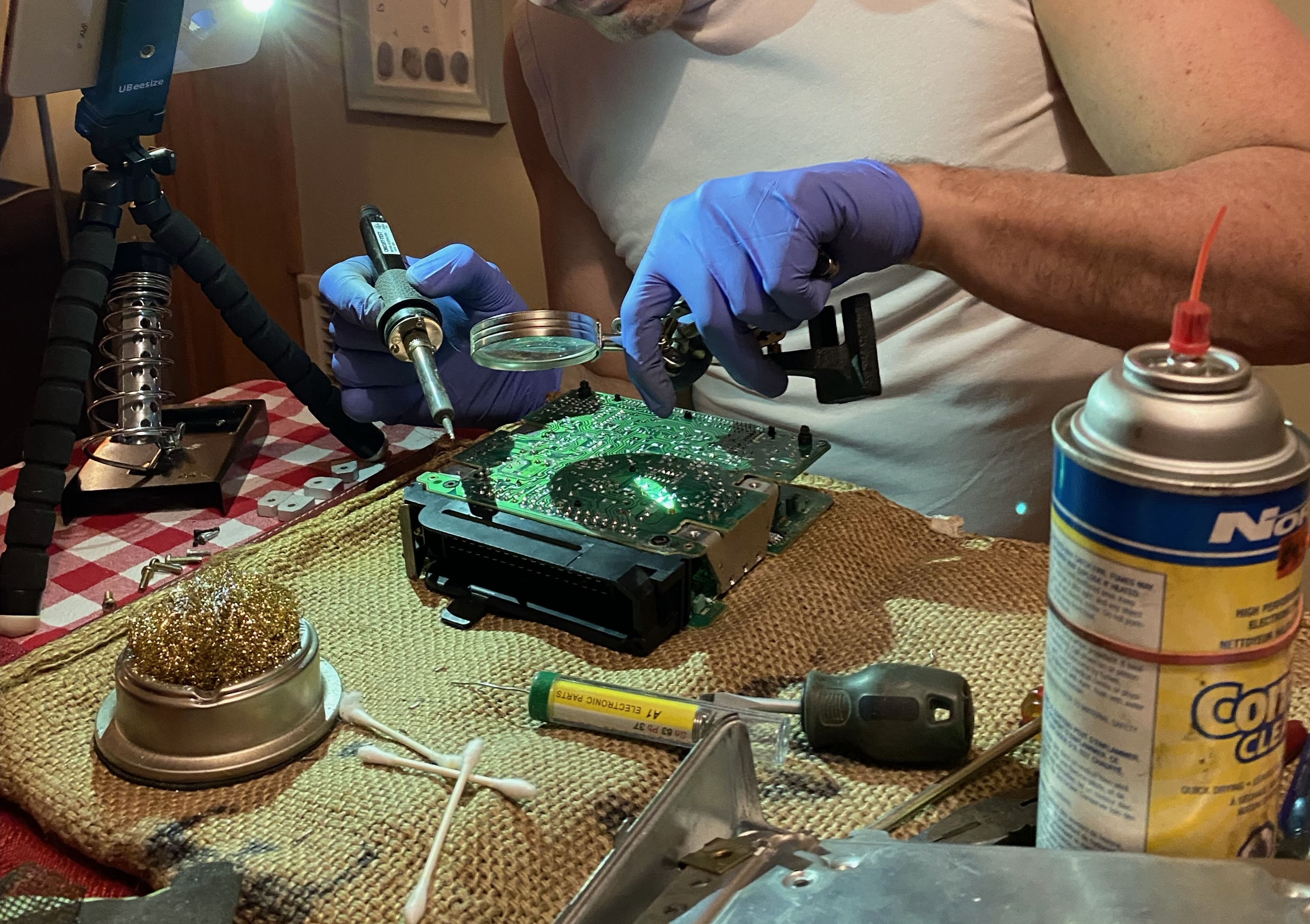

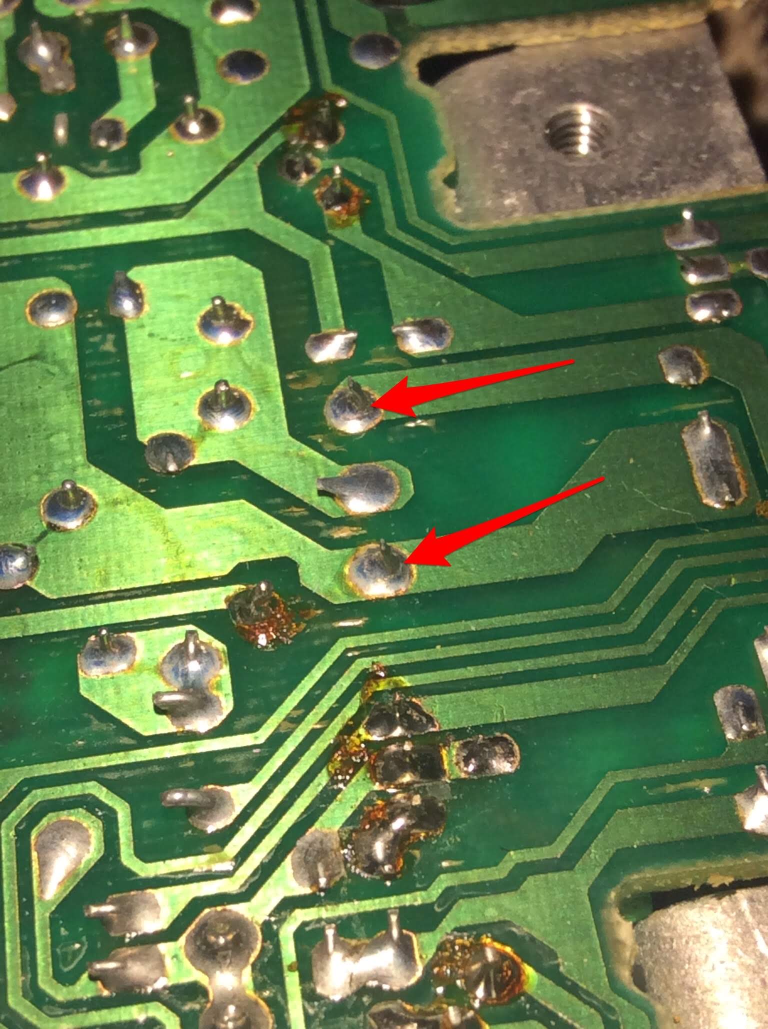

To remove and re-solder inside is not particularly difficult, is relatively quick, and chances are very high solves DME/ECU issueswalfreyydo wrote: Wed Feb 25, 2026 4:55 am Are you lacking fuel or spark?
Usually the DME is sort of the last thing you replace once you have tested and verified everything else, since there is not a great way to test the DME (there are companies that you can send it out to for testing through), but they do go bad.
So depending on if you lack fuel or spark, Clarks will walk you through the diagnostic process starting with those two basic tests. Once you have exhausted those steps, then maybe its time to try swapping out the DME.
https://www.clarks-garage.com/shop-manual/ts-01.htm
No need to send out for testing or pay big money for replacing
All you have to do is get a cheap soldering iron.. solder.. sponge or cleaning mesh.. & magnifying glass
Open it up.. put some solder on the tip of the hot iron.. and quickly touch any joints that have little lines on them. You can add a bit of solder but usually just reflowing seems to do it
In the pic above you can see both bad joints (lines with arrows) and freshly touched up joints (shiney). Very easy to do!
With zero skill or knowledge I was able to perform this twice so far and each time the improvemnt in drivability--in addition to solving the problem--amazed me
I would put money down that doing this to every DME currently in service with at least 100k miles today would result in a marked improvement of some sort
FYI I also did this to my original Made-In-West-Germany DME Relay and it's still in my car today

At the very least as part of regular diagnostics remove the DME/ECU and if you see ANY little lines like those above, it is not functioning as it should be
