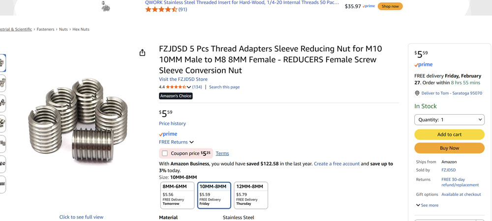

I've heard that that same basic unit was used on a lot of cars, so I'm wondering if the supplier just use the wrong case variant for the 944. I'd be inclined to call them on it and see what they say. If you don't want to bother, I wouldn't drill the mount myself, but rather use some kind of thread adapter so you can stick with the factory hardware. Something like this:

Thanks Tom. I will check out the compressor tutorial for tips. Yes, I'm ordering those adapters. The local hardware store had the standard m10 to m8 adapters, but I need m10 1.25 thread to m8.
So, I'll be doing removing the compressor again next week and will install the insert. Now the only thing I need to resolve is removing the hose manifold from the top of my original compressor. The hole in one of the allen bolts is stripping.
