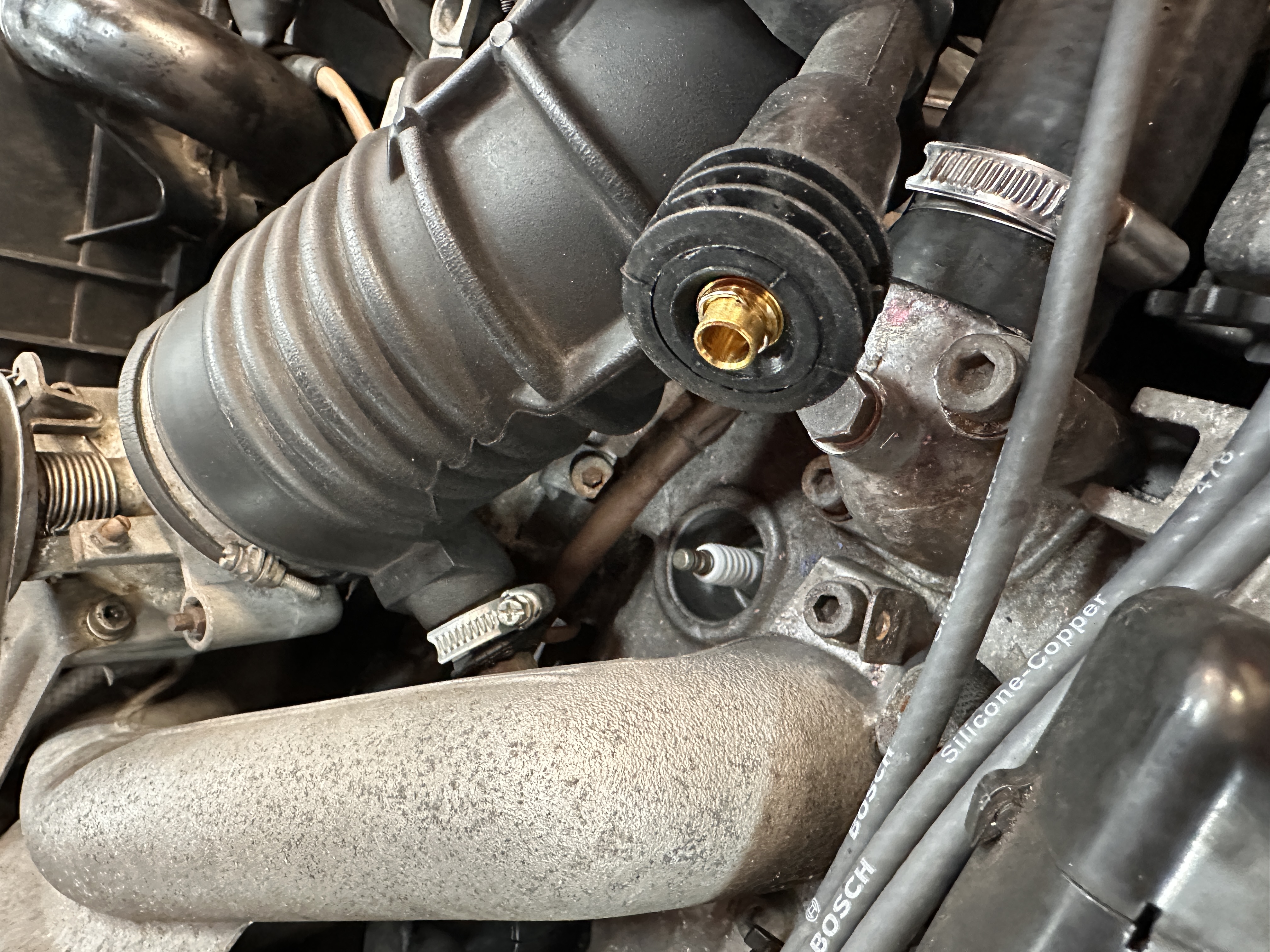

Exactly as you say, the boots are pulling up but as I’ve now found the caps are wedged on top of the plugs.
I have them all off now but I’ve attached a picture of cap number one as it came off. Can I just push it back in or is a new lead needed?

Redmonds944 wrote: Thu Feb 19, 2026 4:43 am Hi,
I'm not sure what we're looking at in that boot? The spark plug itself looks normal, but all that gold connector metal coming out of the boot is throwing me off. Normally the part that clips onto the plug is recessed way up inside the boot -- not popping out the end like that. That boot is supposed to push all the way down inside the spark plug well to create a water tight seal. Do yours? I'm not sure what you mean by 'caps' wedged on the plugs? You should just have spark plugs and spark plug wires. Do you have separate gold colored caps or something? The wires should look like this picture -- note the 'empty' boots, and how far into the well they would need to sit to clip on the plugs. I'm wondering if your connectors got stuck on the plugs while you pulled on the boot, such that the boot slid up the wire -- or, worse, broke off the connector? If the boot just slid (??), the wires might be ok of you can push the boots back down, but I'd also be worried all the pulling compromised the connections inside. Either that, or I'm completely confused about what we're looking at, which is a real possibility. :angel:

I would check continuity on the plug wire in the pic end to end . It is possible the brass piece stretched so far that it ripped from the internal wire . If you have continuity I say push it back into the boot and use it . If you have a misfire you will know it's probably that wire .
Install with dielectric grease to avoid future issues . Add the grease to all four and on both ends . Good luck

I'll 3rd just pushing them back in.
I have other vehicles where I've had issues with pulling the guts out of the boot. Using plug boot pliers was the answer there, as well as dielectric grease.
If you're worried about damage, test the wire. Multimeter is a quick way to see. Using an inline spark tester will also let you know if there is a problem. I bet it will be fine.

PSU_Crash wrote: Fri Feb 20, 2026 4:10 am ...Using plug boot pliers was the answer there, as well as dielectric grease.
The 944 was the first car I purchased pliers for, my hands barely fit between the runners to get a good grip on the boots.
