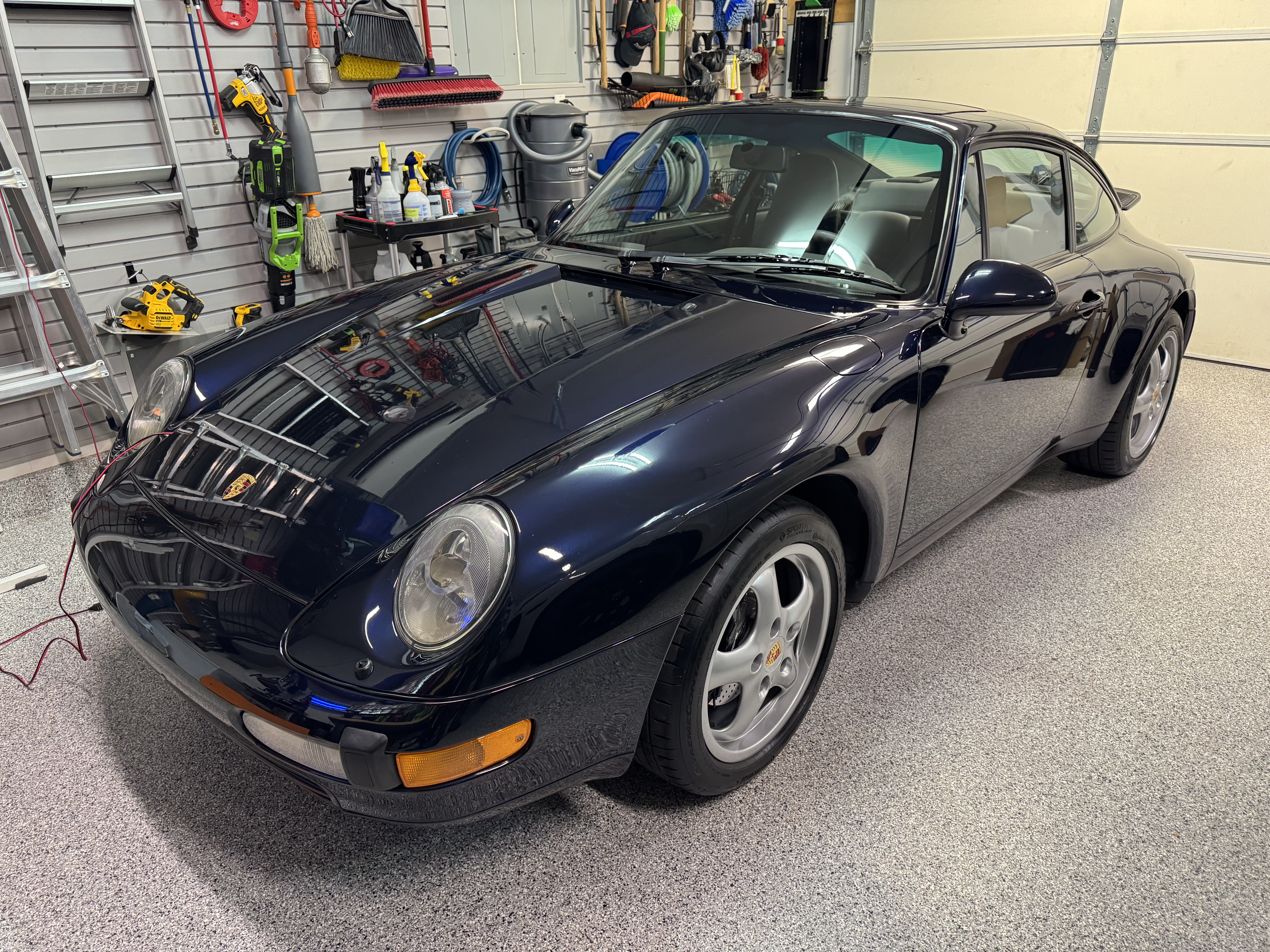

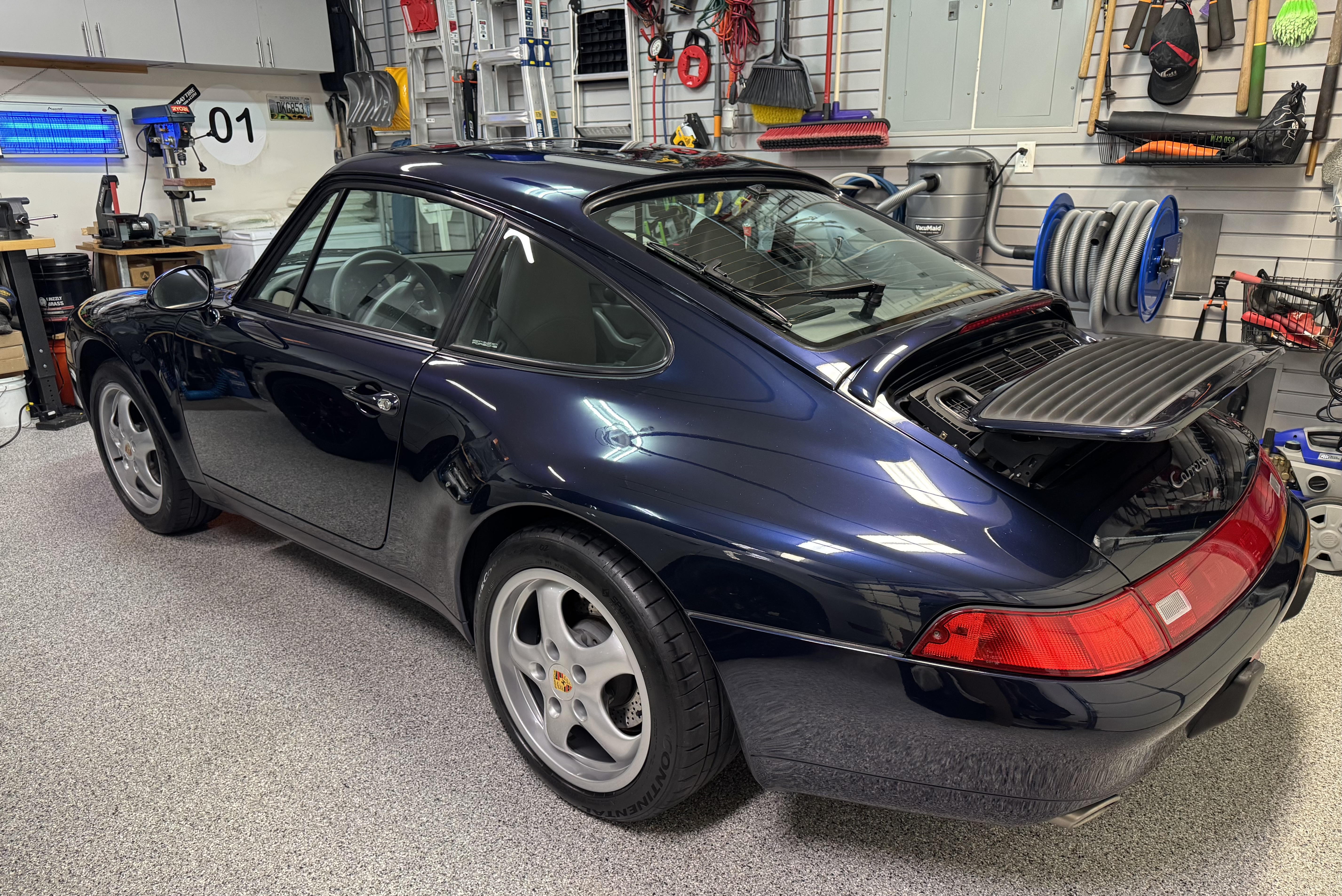

I have owned my 1995 C2 for about two months now and it's been a great experience so far. I love the ability to diy most anything on this car, depending on one's capabilities and willingness to dive in. I'm not an experienced mechanic by any means, and the really big jobs (engine out, seals, transmission repair, etc), I leave to my local independent Porsche mechanic, who has been incredibly helpful in enabling my hobby and projects!
a list so far:
new tires, bent wheels replaced with refurbished Cup 2's
corner balance and alignment (at the shop)
brake flush
air and cabin filters replaced (ugh, the cabin ones were gross!)
gear fluid change (don't think it had ever been done)
replaced locking lug nuts
new driver side door seal and door handle gaskets
replaced funny looking kenwood aftermarket radio with a Continental TR7412
Rennline phone holder
removed tachometer, cleaned haze behind the glass and replaced
repaired broken fog light mounting tab, front right
repaired broken plastic door pocket mounting brackets (both sides)
new floor mats
replaced rear decklid struts (what a pain!)
FD pad keeper
leather reconditioning, dye and topcoat applied to seats, steering wheel and shift knob, looks great!
Numeric short shift kit (discovered the front guide rod on oem setup was hanging free, failed bushing!)
RS motor mounts
replaced cassette holder in rear center console with cup holder
paint correction, ceramic coated body and wheels (CSL, Exo V5, C5 on wheels)

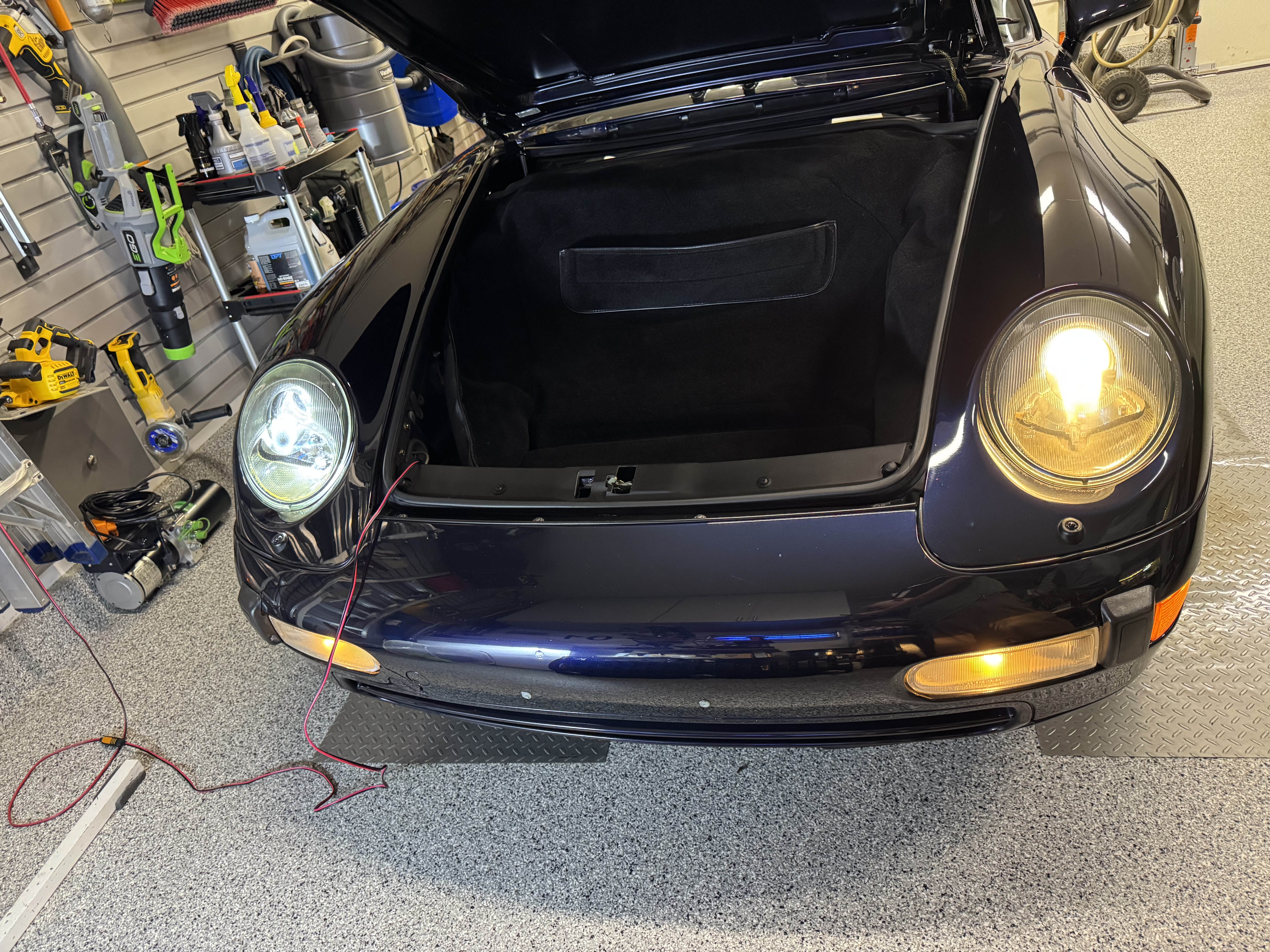

Update! I installed Bi-LED projectors and Osram high beam bulbs, huge improvement. I can now drive at night, confident I can see and be seen! Sourced from emtuning.co.uk and highly recommended.
Pic doesn't do justice to how much brighter.
Half the job done here:
