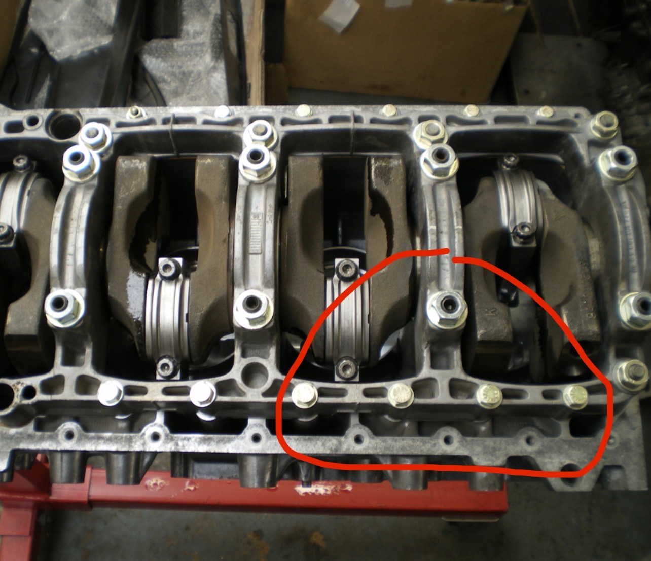

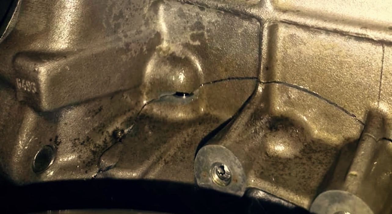

Bergerac wrote: Wed Feb 11, 2026 9:04 pm Seems like most of the higher HP builds broke the block in the end
Do you have more info on that ? I heard thom speaking about a guy breaking the block at 950Nm but couldn’t find anything, did the block get reenforced ? Where did it broke exactly ? I didnt saw any 944 build with broken engine after top deck plate reenforcement and nothing at all with the resin one.
Also, Turbotim documented his built on rennlist in 2013 and get close to 700hp with liners and no top deck plate.
I know that 500hp is more than enought to have fun, but science you know 😂
Thom
The First Carpoke!
Posts: 578
Has thanked: 140 times
Been thanked: 156 times
Welcome and good luck with your project. It is quite a long way to get there but well worth it IMO.
If I remember right Duke made near 950 N.m on his last dyno run before heading to World Time Attack in Sydney where the block broke as suggested by photos showing the girdle had "pulled" one or two bottom main studs out. The material in the block around the main studs cracked. It is also possible he turned up the boost to be as competitive as possible and we won't know for sure how much torque the engine was making when the block broke.
500-600 hp is I think well enough for a 3L for road use. More hp may make sense on a shorter stroke engine (maybe 2.7 16V) that would make less of the barely manageable peak torque of a 3l. At least that's what I would build for a track car.
Good luck and let us how you get on.

michaelmount123 wrote: Fri Feb 13, 2026 7:58 pm If your goal is maximum HP, why in the world would you de-stroke the 3L?
Those engine produce a lot of torque, and if you want the maximum hp, the massive torque in response create too much stress on the crankcase
(This is what happened at 946hp 966Nm)
Reducing the stroke means less torque for the hp, means more potential hp
The second added value my eyes see is that reducing the stroke also reduce the compression ratio, and with a 2.5L crank in place of the 3L and a 3mm cometic headgasket you now have a compression ratio of 8:1 with piston meant for 10.9:1
