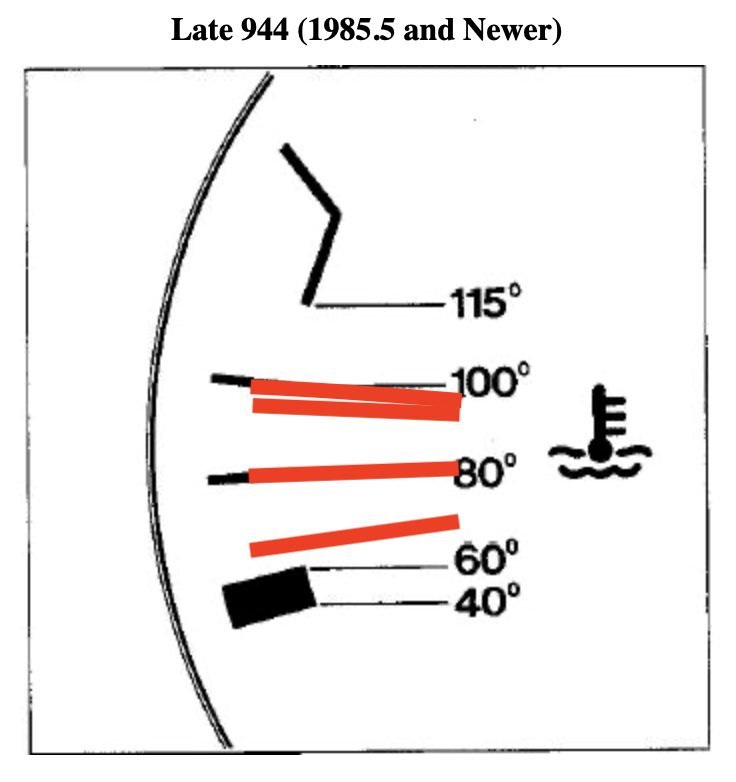

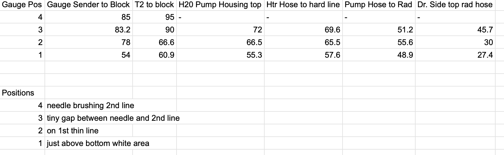

Looks like I have a gauge issue. I figured I should start with the safety factor and verify the actual engine temps at various spots and see how that corresponds with the gauge....
Here is the screenshot from clark's garage from the manual. My orange lines correspond to the needle positions in the table below (4 on top, 1 on bottom)
So when the gauge pic shows 100, my digital thermometer is reading 90-95 on the head, just a bit below.
What is weird and really got me thinking too much was the fact that the thermostat does not fully open according to the manual until 90, and the factory spec for the cooling fans to come on low speed is 92 (198F) and high speed at 102 (215).
My fans are controlled by MS and right now I just have one on/off point set to come on at 196F.
Once the gauge gets to the 3/4 spot, it typically stays on 3 when moving and might get up to the line sitting at a light.
Thoughts?
Thoughts?

Drscottsmith wrote: Mon Feb 09, 2026 11:24 am Ok - thanks all!
Screenshot 2026-02-09 at 2.14.49 PM.png.
Thoughts?
Unorganized thoughts:
[TL;DR version: I'd revert to factory control over the fans using an 83c/93c thermo switch in the radiator and an 80c t-stat. If you then still see high temps, consider radiator options...]
Just curious why you are controlling the fans with the microsquirt? The factory system works quite well when functioning as designed and does not rely on the DME/ECU, so you don't 'need' to control the fans with the microquirt.
The factory system has the fans come on in two stages (slow and fast) to help prevent the temps from getting as high as you are seeing. If you have just one set point, you are losing a level of control. You are either losing the slower fans coming on at a cooler temp (to help prevent it from getting up to line 4) or you are losing the fan coming on fast when it starts getting really hot. Either way is 'less good' than the standard factory set up. If your fans don't turn on at all until 196F, you are virtually guaranteeing the gauge will get up to line 4 at long stop lights.
Unless you have a specific reason to control the fans that way, I'd start by reverting to the factory system (using an 83c/93C thermo-switch in the radiator) and see if and how much better you do, or at least turn the set point down to 180F. Your car is currently working similar to a car with a bad thermo-switch that fails to trigger until the higher set point (and even worse if the fans only turn on in slow speed). In that situation, it's common to see the gauge bounce up near your 3 and 4 lines.
I'm not entire clear which sensor you are using to trigger the fans, but assuming it is either the DME temp sensor (blue connector) or the Gauge sensor (with spades), be aware that the factory system controls the fans based on the thermo switch in the radiator itself, rather than coolant temps in the block like you seem to be doing. All the fans can do is cool what's in the radiator, so the only temp that matters to the fans is the temp inside the radiator. There are circumstances where the block temps and radiator temps diverge, and the factory system protects the radiator from overheating (blowing end tanks, etc.) in those situations.
I wouldn't put much stock in the discrepancy between a point and shoot thermometer and the temp on the gauge. The sensor is submerged in the coolant itself, and the thermometer is pointing at the outer wall of an engine. I'd expect the other wall to be cooler...
If the fans were the ONLY issue, your car would run cooler than your line 3 on the highway, so agree it's worth looking at the t-stat and general health of the cooling system.
I think the factory liked these cars to run a bit hotter than most of us would like (opinions vary on that of course), so what I and many others have done is use a lower temp thermostat paired with a lower temp thermo switch. I have a 80c thermostat and a 83/93C thermo switch, and my needle will creep up to just under half way on the gauge at long stop lights, then the fans kick on and it settles back down to 80c (the t-stat setting). If you revert to factory fan controls, and a lower temp t-stat and thermo switch, chanced are your gauge will bounce between 80 and 90c. If not, it would be time to look at the radiator itself for internal clogging, etc.
Also be sure to remove all debris in front of the radiator. Leaves and bugs and dirt can significantly reduce the cooling efficiency.
