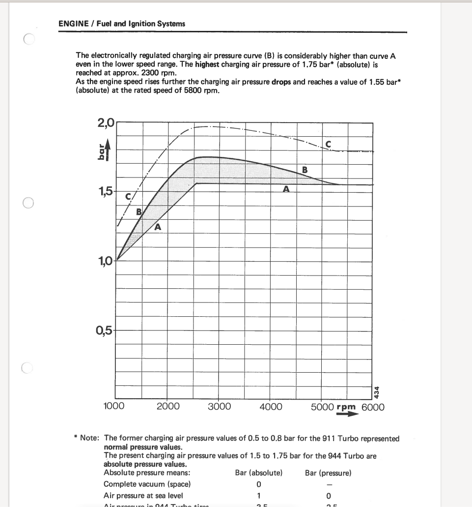

The 87 turbo doesn't hold max boost to the redline, it does drop off. Here's a graph with some numbers from the official Porsche technical docs (pdf attached):
The 88 Turbo S and all Turbos from 89 on hold full boost all the way to the max rpm - that's how they make their extra power (peak boost is the same pressure as the early Turbos).

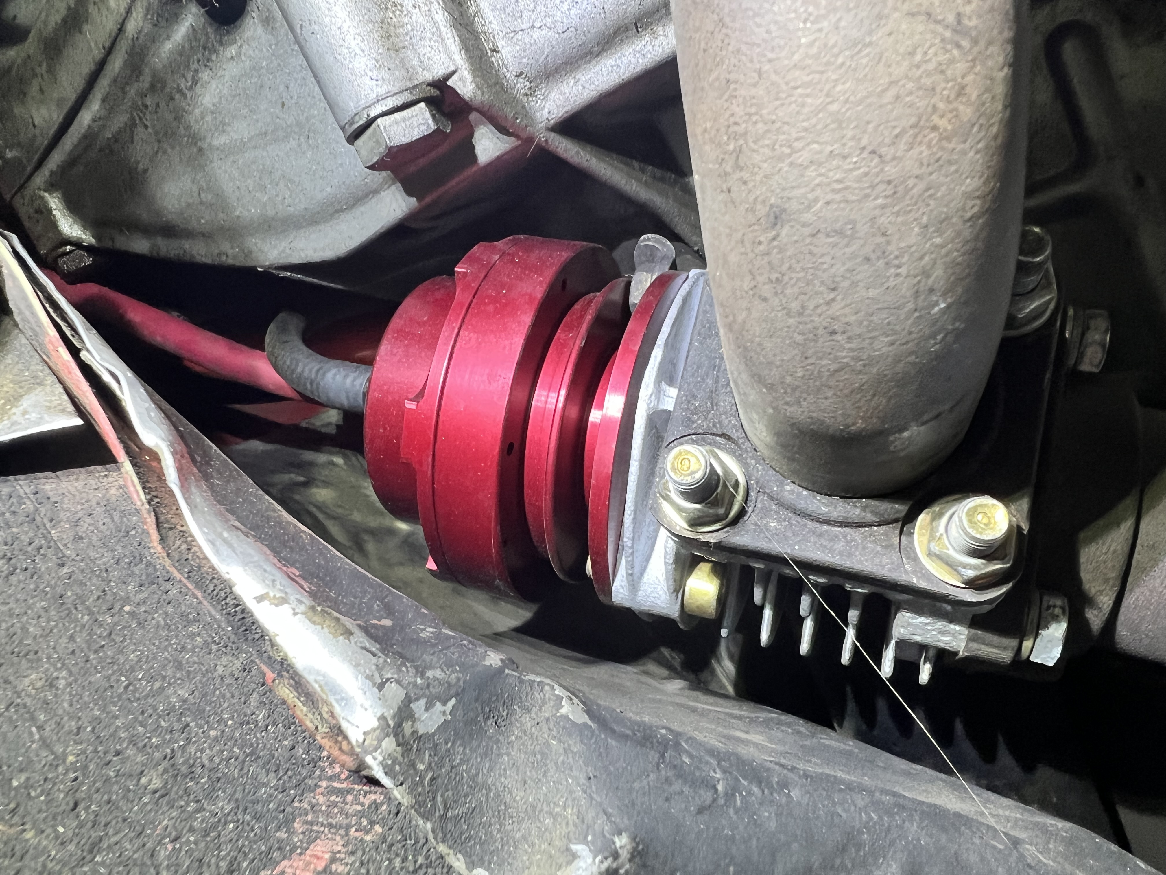

Looks like a Lindsey Clubgate. What are you using for boost control?
Boost controller looks stock, that black vacuum hose from the top of the waste gate goes into the cycle valve control (is this the right name for it)
Regardless, by you guys description I believe my car is working as it should, there is a vacuum while cruising but at the slightest throttle input it goes into positive boost. The one thing I have to test for sure is at what rpm the boost comes in.
Yes, the wastegate looks fine... the challenge remains not maintaining full boost. Do also check the diverter valve to ensure it's not sticking open and bleeding boost. If there are no other pipe leaks, then the turbo appears to be just getting weak and not able to maintain boost. I do rebuild these K26/6 and have a set of new billet wheels on the shelf.shft22 wrote: Mon Feb 02, 2026 3:44 am Boost controller looks stock, that black vacuum hose from the top of the waste gate goes into the cycle valve control (is this the right name for it)
