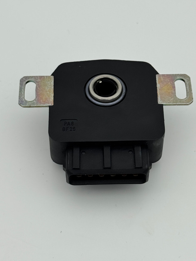

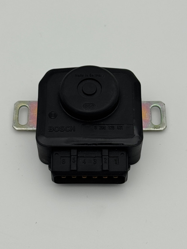

Hi all, after following the CARPOKES testing procedures, I determined I need to replace the costly TPS in my 951! Does anyone have any knowledge if this TPS for the older Audis, Bosch part # 0 280 120 431 could be/is a direct fit the Porsche part 951 606 113 00/ Bosch 0280 120 400? While cheaper, it is still a $300 part. Many thanks for your assistance. Bruce

I have experimented with various sensors with the same form factor, and none has turned out to be compatible.
0280 120 400 is only used on some turbo volvo cars, afaik.

Ok, thanks. I tried to find tech specs for both the original and this one to see what was different/same to determine fit/form/function but was unsuccessful.
