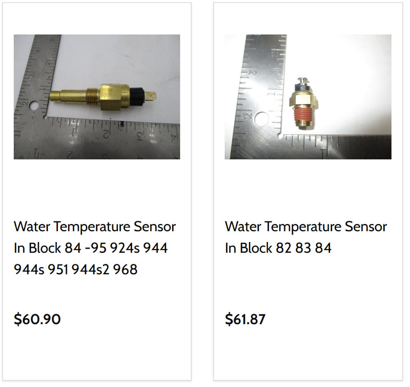

Yes, I believe the early 944 has a one-wire sensor rather than 2 spade connectors like the later cars. Assume yours looks like the one on the right in this pic borrowed from 944online:
Just measure resistance to ground and compare to the reference points based on temps. Since ChatGPT is so good at doing tables, I did one for you so you don't have to interpolate so much...
30°F ≈ 2118 Ω
40°F ≈ 1558 Ω
50°F ≈ 1163 Ω
60°F ≈ 879 Ω
70°F ≈ 673 Ω
80°F ≈ 521 Ω
90°F ≈ 407 Ω
100°F ≈ 322 Ω
105°F ≈ 287 Ω
110°F ≈ 257 Ω
120°F ≈ 206 Ω
130°F ≈ 167 Ω
140°F ≈ 137 Ω
150°F ≈ 113 Ω
160°F ≈ 93 Ω
170°F ≈ 78 Ω
180°F ≈ 65 Ω
190°F ≈ 55 Ω
200°F ≈ 47 Ω
210°F ≈ 40 Ω
220°F ≈ 34 Ω
221°F ≈ 33.6 Ω
230°F ≈ 29 Ω
240°F ≈ 25 Ω
248°F ≈ 22.7 Ω
250°F ≈ 22 Ω
