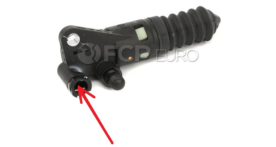

Located inside your plastic clutch slave cylinder (thanks FCP Euro for the pic. :P )

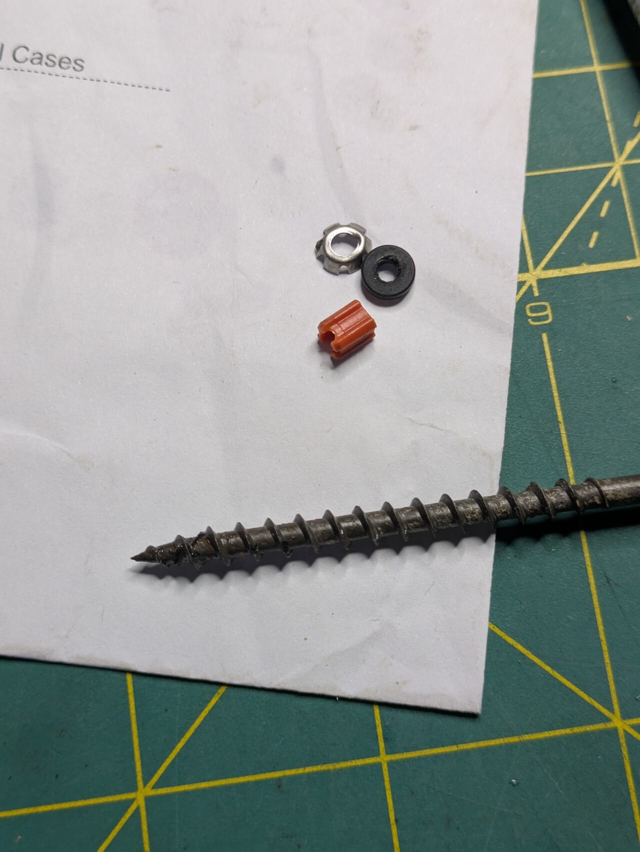

There is a shiny metal clip, a rubber gasket, and a plastic valve with a small hole in it.
Sheetrock screw removal tool for scale. Take a screw driver and drive the screw into the clip and pull out.
Remove these three parts and re-install.

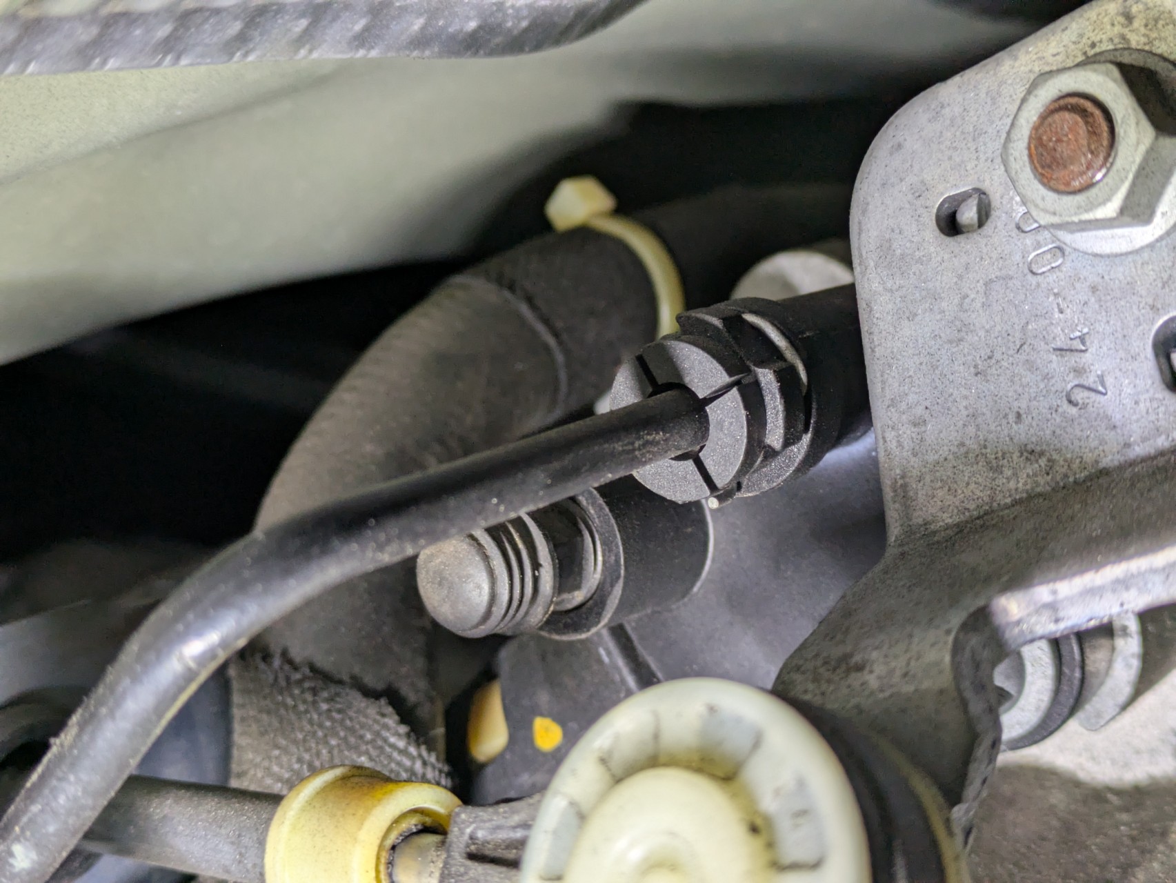

The slave cylinder is spring loaded and full of fluid so it's easy to remove and a bit of a pain to re-install, but can be done with some persistence from under the car. You can position the cylinder so that it locks onto the transmission under tension, and get the bolt started. The fluid line has a metal clip that just needs to be pulled up and then the line will pop right out. All of this is plastic, so be careful. You will need a 12mm E-Torx plus a clamp on the rubber hose to stop the fluid leak.

Here is the post from @Ix_ where he showed me the valve, afterward I was able to easily duplicate it.
I measured the orifice size to be 1.45mm, I mention this as on other boards people will increase this orifice size with a drill bit instead of remove it to fine tune the clutch feeling they want.
Ix_ wrote: Sat Oct 14, 2023 12:53 pm Jeremy,
The clutch slave cylinder has a small red plastic restrictor inside. Supposedly it is there to prevent overly aggressive launches. If one wants to remove it, a properly-sized screw makes quick work of it. Just a thought.
