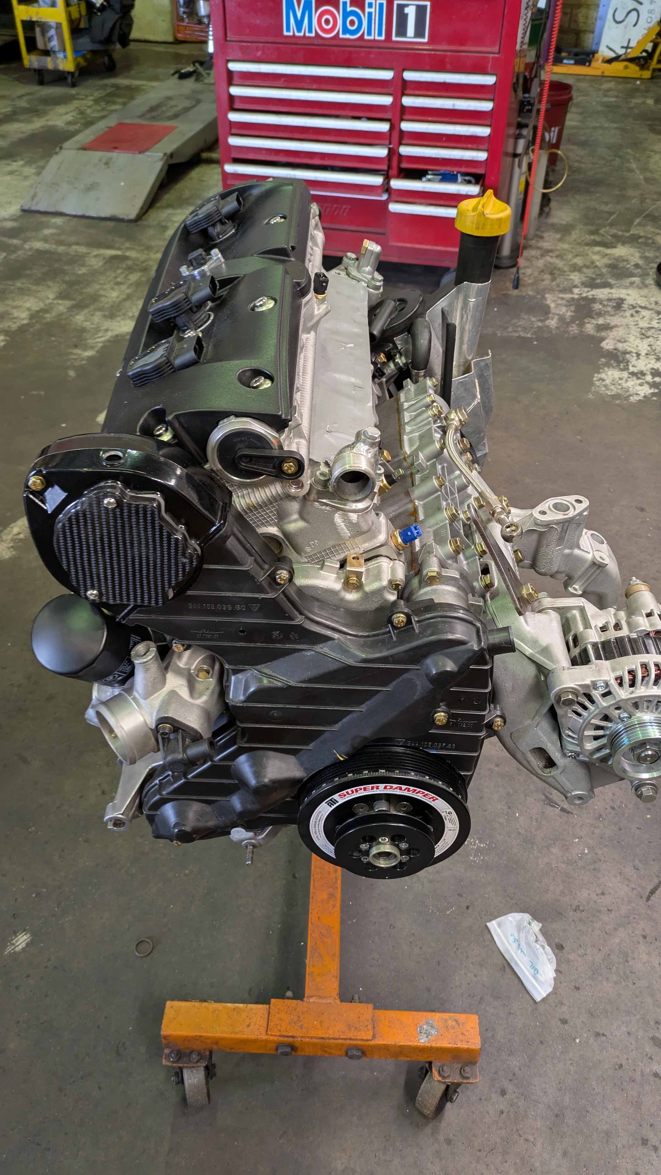

DRS development made a replacement hub that replaced all the crank pulleys and allowed you install a ATI Damper but it was a limited run and youd have to find one that someone didnt end up using it willing to sell. Jan may still have one but its a long shot.
Quite a few mods to the belt covers to make it work. Its also quite a bit larger so will be overdriving your Alternator/AC Compressor slightly
