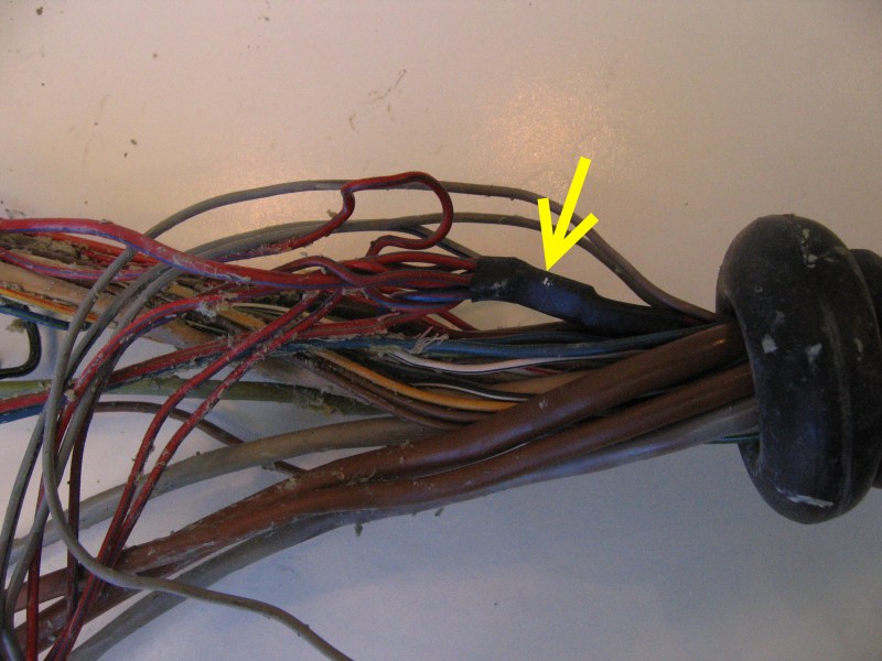

C50 is continuation symbol indicating that the rest of the circuit continues somewhere in the area of column C, row 50 in the diagram (conveniently located on the same page). The use of a diamond shape indicates that the circuit is connected to a welding point that is shown at that coordinate.
A welding point is a junction of multiple wires that is made by compressing the wires together using a press. Here is a glimpse of the positive welding point (WP #3) in the engine harness:
If you were to peal back the insulation, you would see a mass of wire strands pressed tightly together in the shape that looks like a little brick. It's essentially a form of compression weld.
In your case, the circuit in question connects to welding point #4, which is a ground junction located in the snorkel section of the engine harness. This circuit ultimately connects to a ground point at the back of the engine (MP VIII).
Based on what I'm seeing in the pictures, I'm gonna guess you have a later model 951 (87 or later), into which someone has installed an early (86) engine harness. The red 4-pin connector was present in the 86 harnesses. But at some point (MY87) Porsche switched to the black 8-pin connector.
It looks like there has been an attempt to adapt the two harnesses (the single green junction wire between the red and black connectors). But the job is incomplete. In theory it should be possible to connect the rest of the wires to restore operation of the boost gauge.
