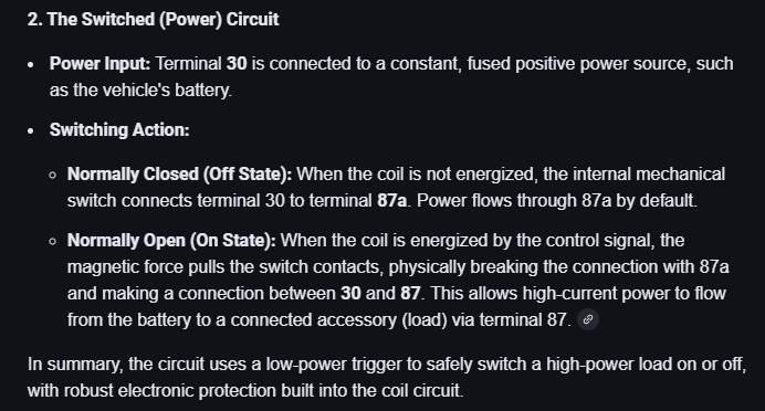

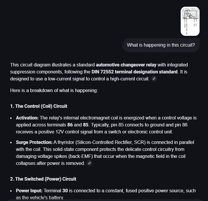

For the backup light relay:
Backup Light 1.png (88.24 KiB) Viewed 1755 times
Backup Light 2.png (57.66 KiB) Viewed 1755 times

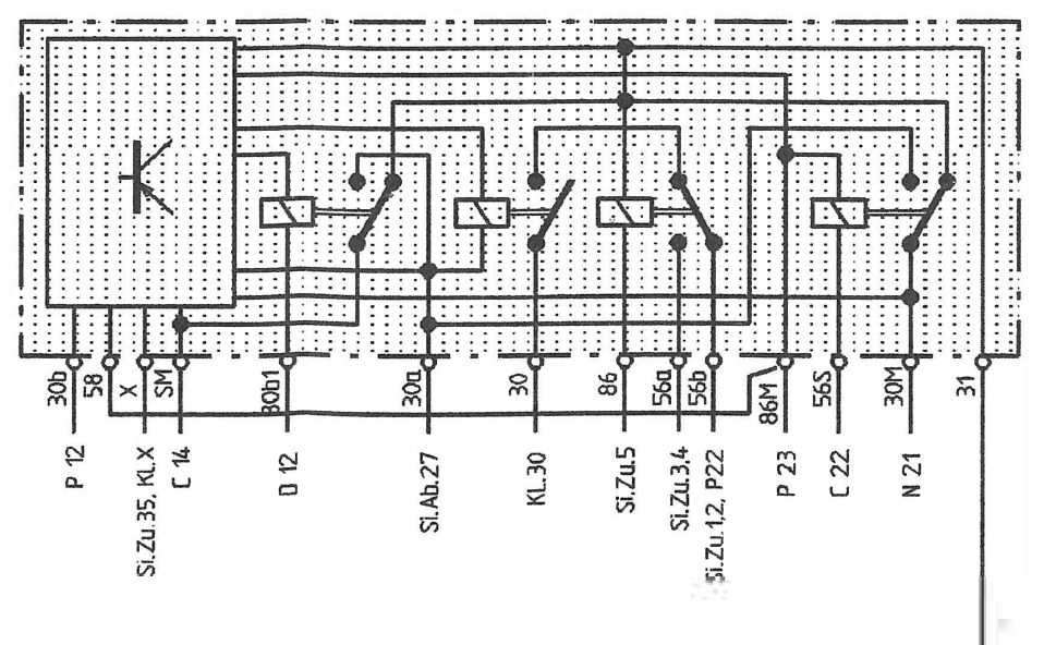

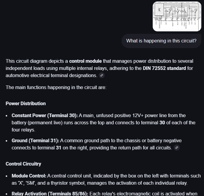

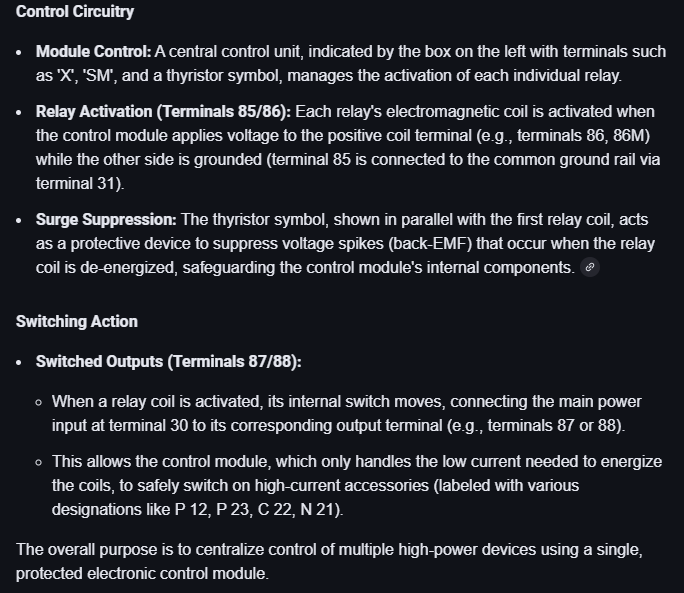

A more complicated relay, the Light Combination relay:
Light Combination Relay 1.png (509.1 KiB) Viewed 1755 times
Light Combination Relay 2.png (99.55 KiB) Viewed 1755 times
Light Combination Relay 3.png (83.94 KiB) Viewed 1755 times
I still need to make up my mind about this usefulness; being generally not on board with AI makes me sort of hate having it be actually useful.

Oof ... usually AI is a little better than that. It is explaining things that don't exist. Like the thyristor across the first relay coil. I don't see that. I do see a PNP transistor symbol loosely in parallel with the coils. Term 30 is defitnitely not the main common power. Even 30a, b, c ... we can't be sure based on that. This makes my brain hurt
I need to look through it in detail later
