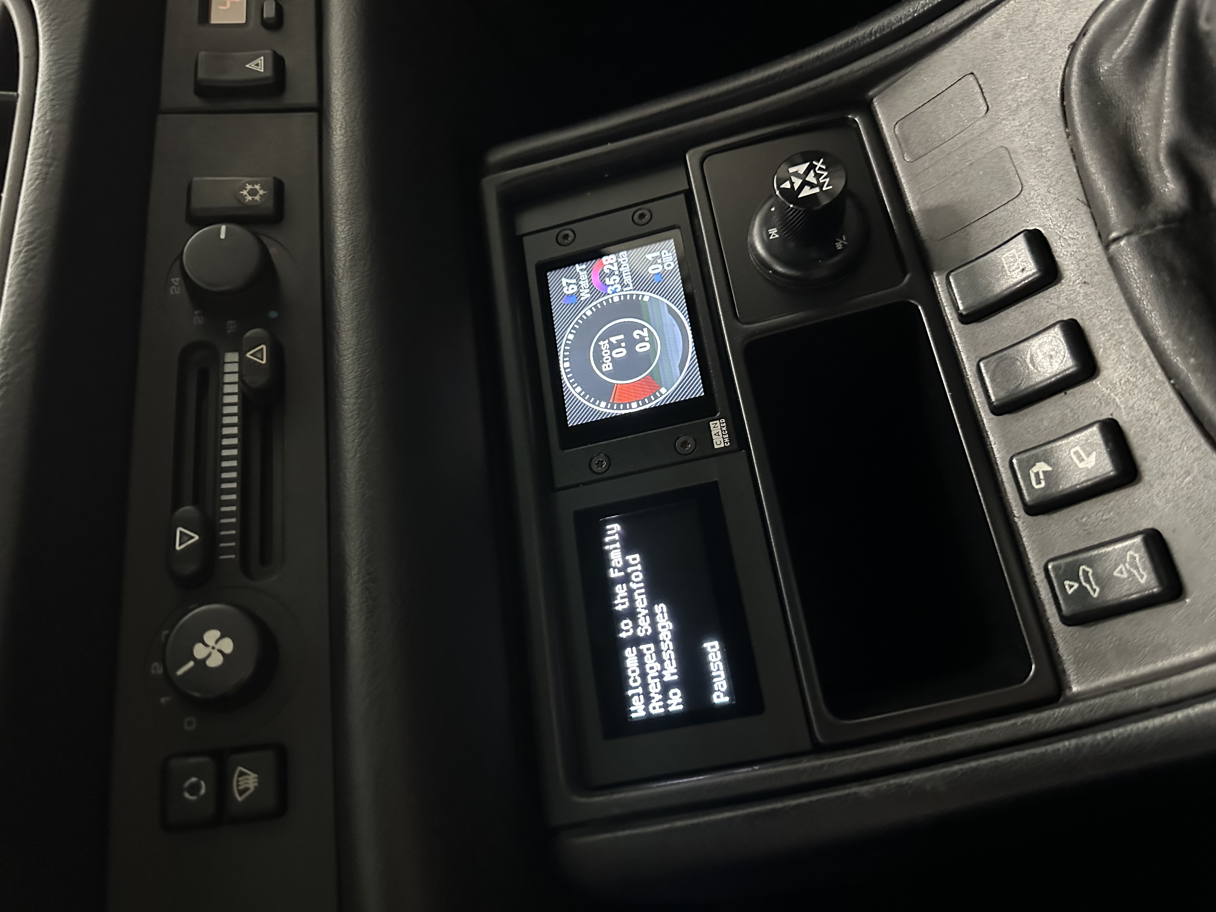

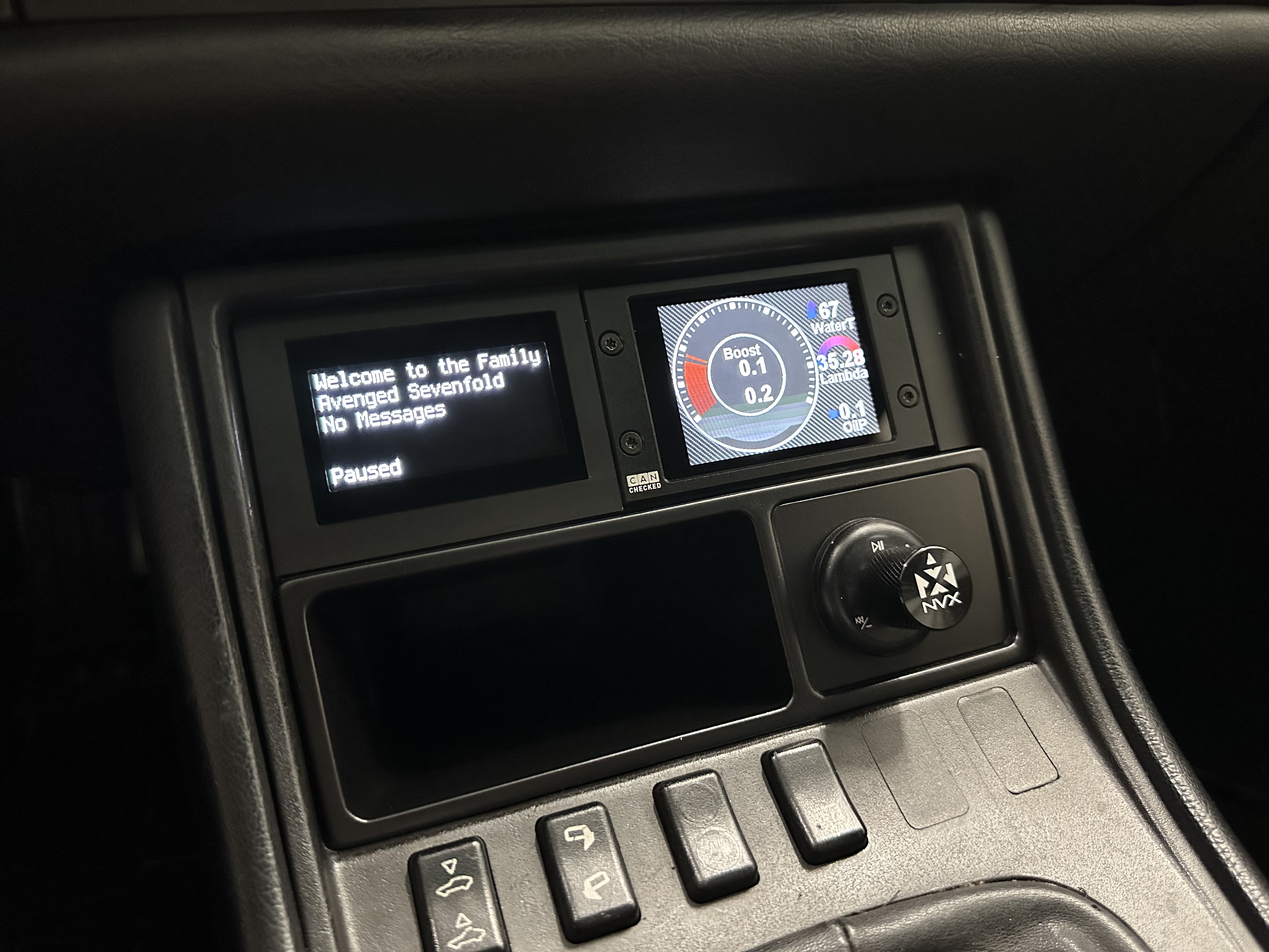

Ordered custom glass to cover the OLED screen.
Modified the 968 pocket and click to hold a Bluetooth knob.

I love it! And I'm envious of the OLED. My zeitronix gauge gets washed out in even mild sun. Very tidy install! What drives the display?

Adafruit Itsybitsy with code I wrote to connect to the iphone bluetoth and use the Apple Media services to pop notifications and show song info and play/pause status. Hidden amp and the bluetooth knob where the clock was on the 968 pocket. I just had my custom silkscreened edge glass show up today, so that's why I'm showing it off :). DIN housing was done in Fusion360 and printed on my P1S
If you meant the gauge unit, that's CANchecked connected to MaxxECU. Sorry, the title might have been misleading, I meant the whole assembly.
