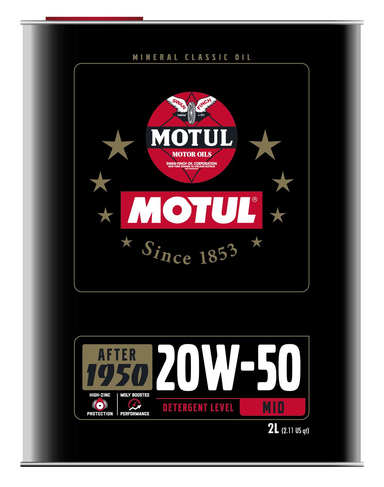

As concise as I can be: you want something with a higher zinc (ZDDP) content to protect the cam and flat lifters; and either 10w40, 10w50, 15w50 or 20w50. Valvoline VR1 20w50 is a popular choice that checks all the boxes. If the motor is vulnerable to leaks, mineral oil tends to leak less in my experience. I recently switched to the new Motul mineral (dino) oil marketed to older cars:
motul (1).jpg (126.62 KiB) Viewed 629 times
