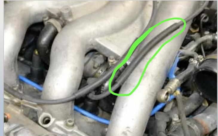

Hmmm... What exactly fell down there? I’m struggling to figure out what broke and fell down and what you mean by “heat protection” -- metal or plastic? Here’s an image - can you circle or describe.
My general advice would be if it’s metal = Problem and you need to get it out before you start that motor. If it’s plastic, you leave it and the motor will ingest it and chew it up and there will be little risk for any damage (I suspect it’s plastic, since you said “brittle”)? But -- before I make that determination if you can be more descriptive about what fell... that would help.
It's this piece that's a protective cover on one of the spark plug wires. It's maybe 1-2mm wide and maybe 4-5mm long. As brittle as it is I think it would turn to powder almost instantly. Plug wires and a new rotor cap are on my list of things to do but right now I want to clear my no start condition before moving on to the next task.

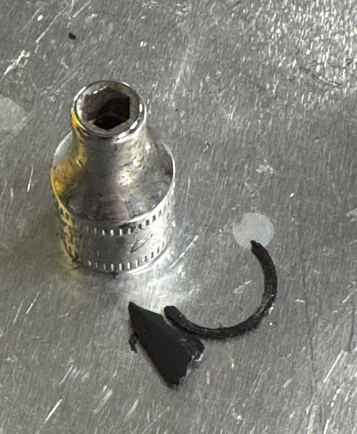

I got it out and there wound up being two pieces in there. I used an inspection camera with a hook attachment and some grease on the end of it. One piece was on the valve and the other down in there. It was easier to knock the piece on the valve down on top of the piston then pick them both up from there.
It would have probably worked its way out but I had an excuse to buy another tool I needed anyways.
For reference this is 4mm 1/4" socket next to the two pieces.
