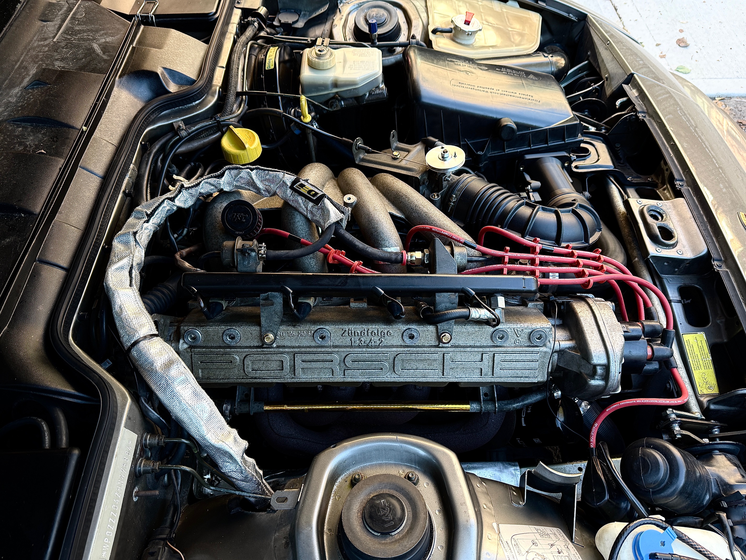

To me, biggest risk and immediate inspection on ANY car, are engine bay fuel lines. Fuel injection is high pressure and every car has rubber fuel lines traversing hot engine parts. The 944 has at least 2, the feed and return lines, that cross over the engine head and in some cases the exhaust headers, lol?
I recommend checking all of your fuel lines, specially the engine bay ones, and if you have original feed/return lines, buy a nice replacement kit. I recommend one with extra hose so you can route the lines around the head (photo attached).
