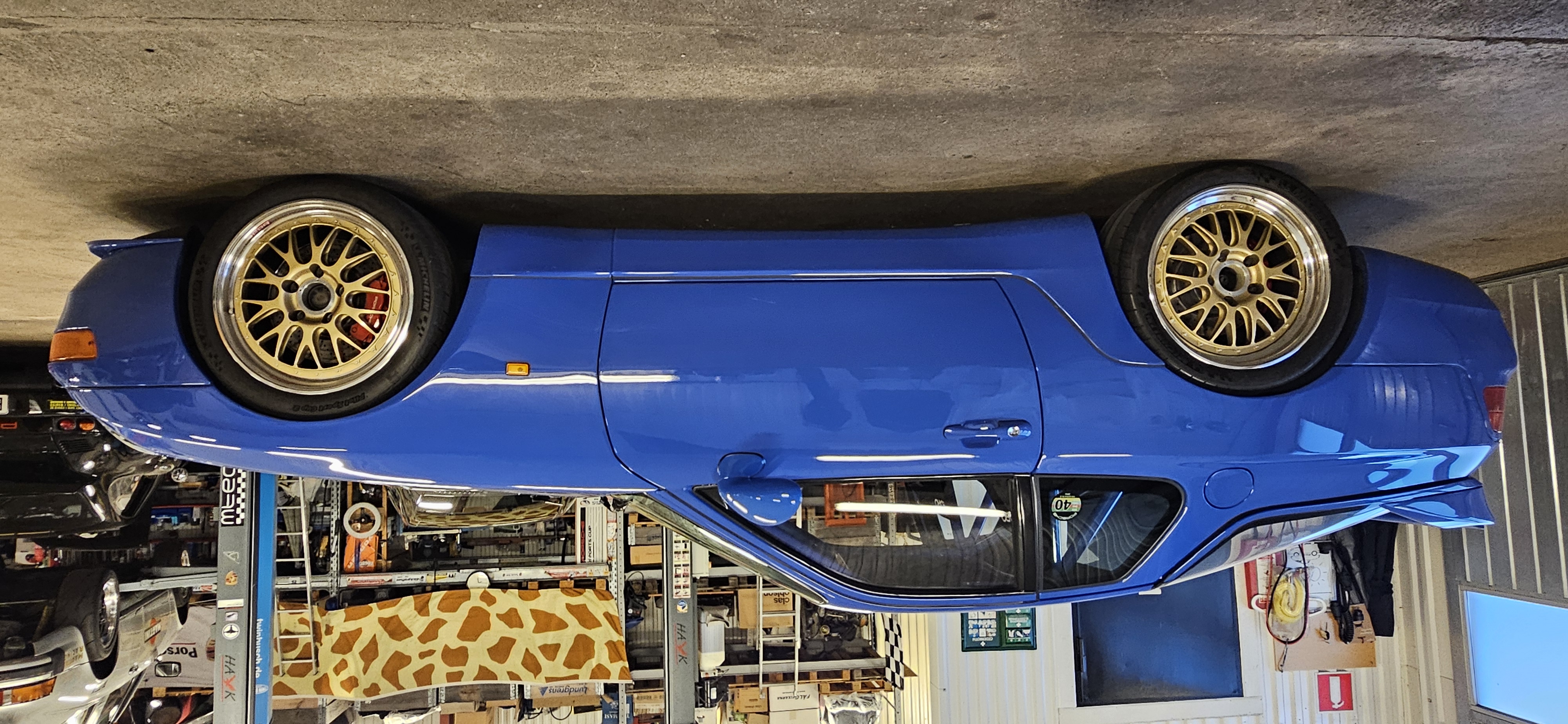

Hi guys.
I am searching for a really good suspension setup for my 968 Turbo RS replica. I want modern suspension fully adjustable.
I built the car for the track with the occasional street use. Goal was to put some pressure on drivers with modern cars which sofar has worked well🙂
I live in Sweden so parts that are readily availible in europe is best for me so you racers out there what are you using?
Car as is: 1150kg, 420hp crank, no rubber bushings only uniballs, HR nurburgring suspension kit
Michael Mount pointed me towards Racers edge and Moton but it gets really expensive from the US to Sweden.
Suggestions appreciated.
