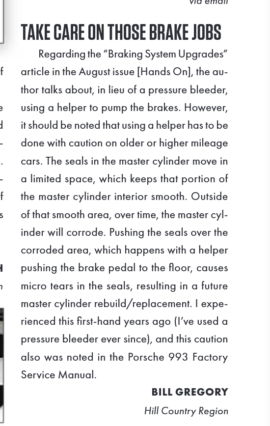

I read the following last night in the new issue of Panorama. May not apply but it is plausible.
