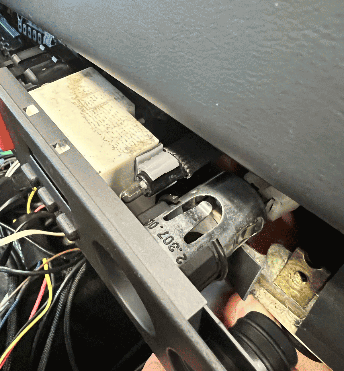

Well after searching high and low, I cannot find any discussion about the change-over, so here's a carpoke's exclusive. :) Porsche eliminated the bulb socket on the trim piece (which broke off my old trim piece anyway) and, in it's place, they integrated a bulb holder into the electrical connector for the cigarette lighter (see pic, part number 944 612 439 00). I'm guessing the light shines brighter into the lighter this way, and is surely less likely to snap off like mine did. At any rate, mystery solved. Pelican sells the new socket with bulb holder for $5, but I'll probably just print a bulb holder and be done with it....

On my original trim, the mounting holes were cracked, and the mounting hole on the end was completely broken apart, meaning I could not install that whole trim piece securely to the dash. The bulb holder molded into the back of the trim was also broken half off, not that I realized that until after studying up. I ordered a new trim piece from Porsche (same part number as the one with the bulb holder) and discovered that it is now made without the bulb holder. As best I can tell, all of the new trim pieces are missing the bulb holder (and have the same number molded into them as the original versions). After studying up, I discovered that Porsche moved the bulb holder to the connector that plugs onto the back of the lighter. I image somewhere there is a TSB from Porsche that says if you change the trim piece, you now need to change the cigarette lighter connector too.
If your bulb mount is broken, your options are to find an original trim piece with the bulb holder still intact (good luck), or replace the cigarette lighter connector with the new version that has the bulb holder built into it, or cut off the remnants of your bulb holder and use my 3D printed holder, or get creative with glue/zip ties/etc....
