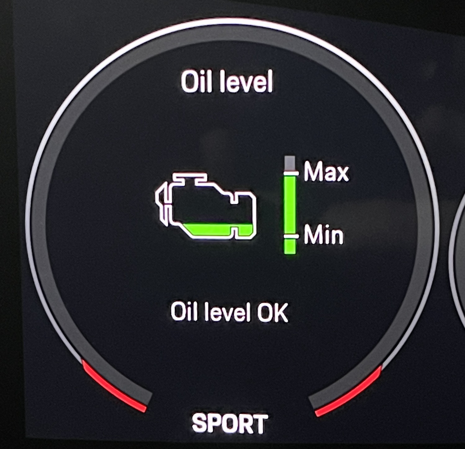

I finally found the display for the oil level in my 911.
To display the oil level use the rotating the thumb wheel on the right side of the steering wheel to display the temp screen then depress the thumb wheel and scroll & select oil level measurement.
Engine should be at operating temp to accurately measure oil level.
You can see my level indicates max.
I'm at just under 400 miles since taking delivery.
BTW I always select SPORT mode :lol: :lol: :lol: :lol:

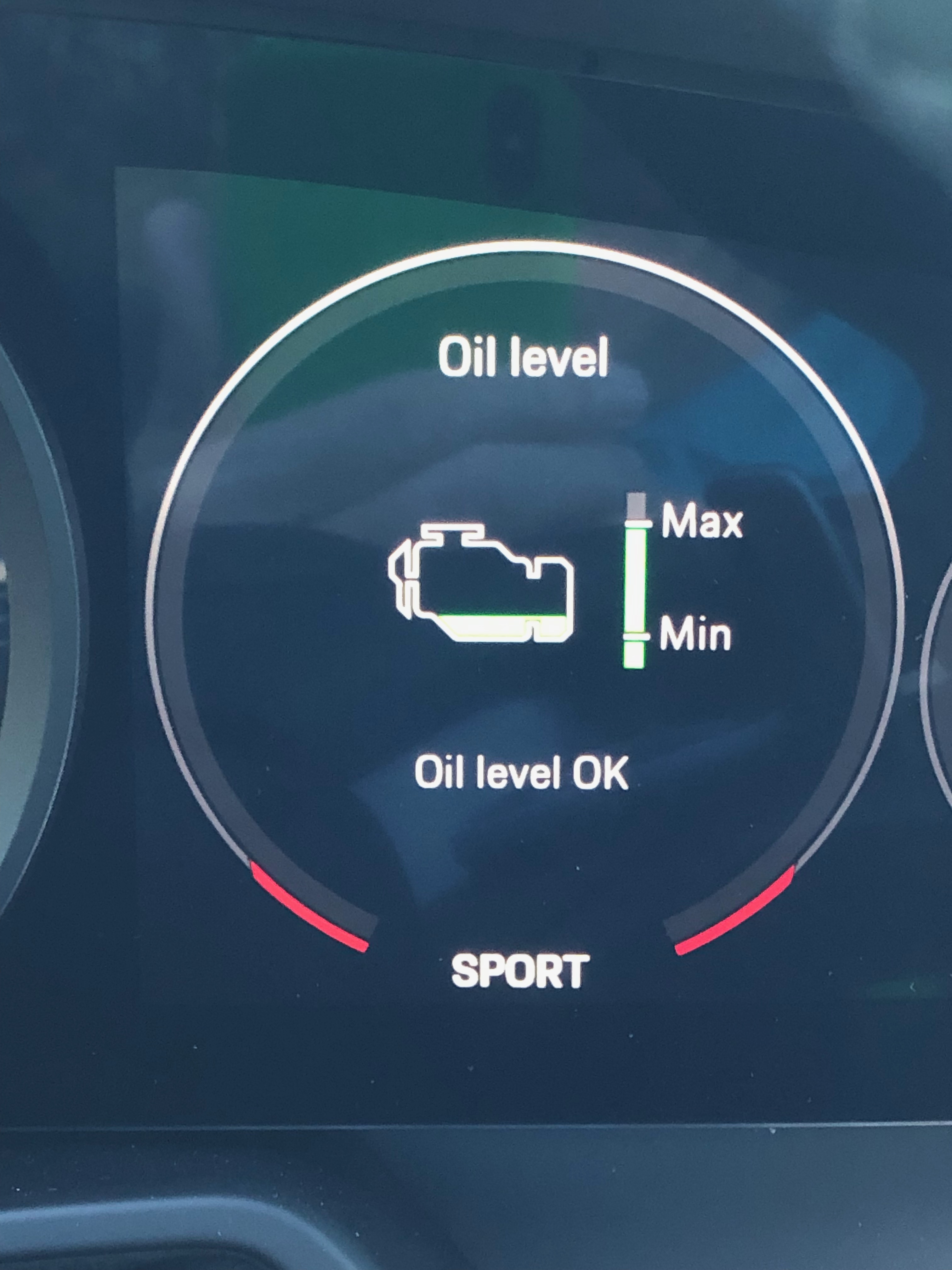

Hey I found it! :)

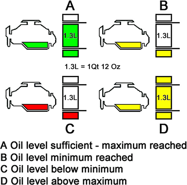

Here's something I put together. Hope it helps.
Porsche 992 Oil Change - 0000.jpg (109.81 KiB) Viewed 1390 times

Bluehighways wrote: Mon Mar 21, 2022 8:55 pm Here's something I put together. Hope it helps.
Nice work, thanks for posting. Keep in mind this is for the non-Turbo (capital T) cars. For my Turbo S, the difference between the min and max is just one quart per the manual. We recently changed @Crazy Eddie's oil and if memory serves the difference on his 981 was 1.8 liters. Just like Porsche to make it a little different on all cars. On the other hand, it's kind of a sun dial, so not sure the variations translate into any actionable information. Check level, if low add about a third of a quart, check again after it settles in, repeat ad nauseam.... :wtf: :shock: :? :shifty: :problem: :crazy:
I wonder if the lack of dipstick was a cost-savings thing, or part of the effort to block all top-side access to the motor, or just Porsche wanting to be modern and high tech, or maybe an emissions thing? Sure seems like an elegant solution in desperate search of a problem, but at least it's not a wifi-enabled wine bottle...
