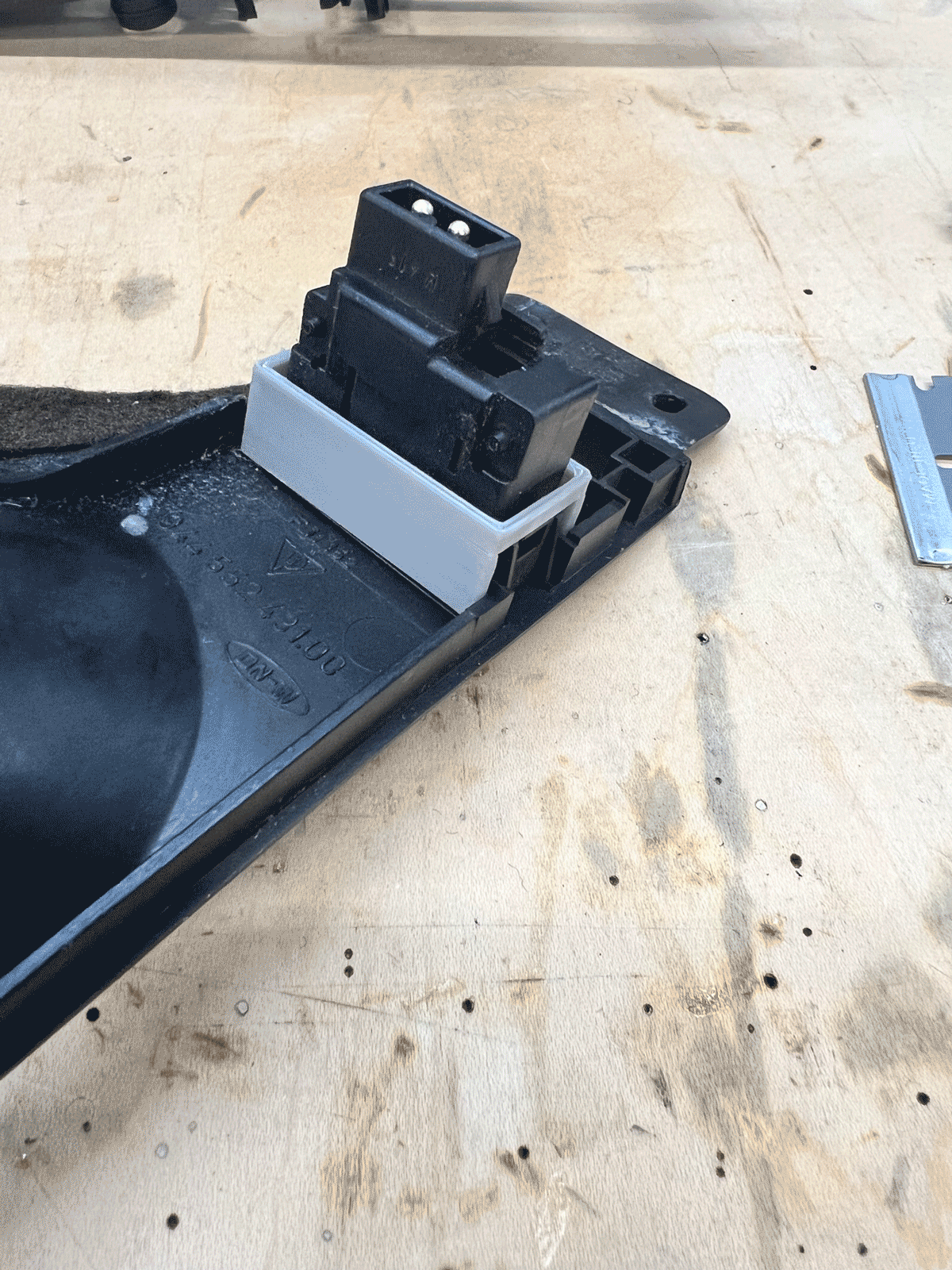

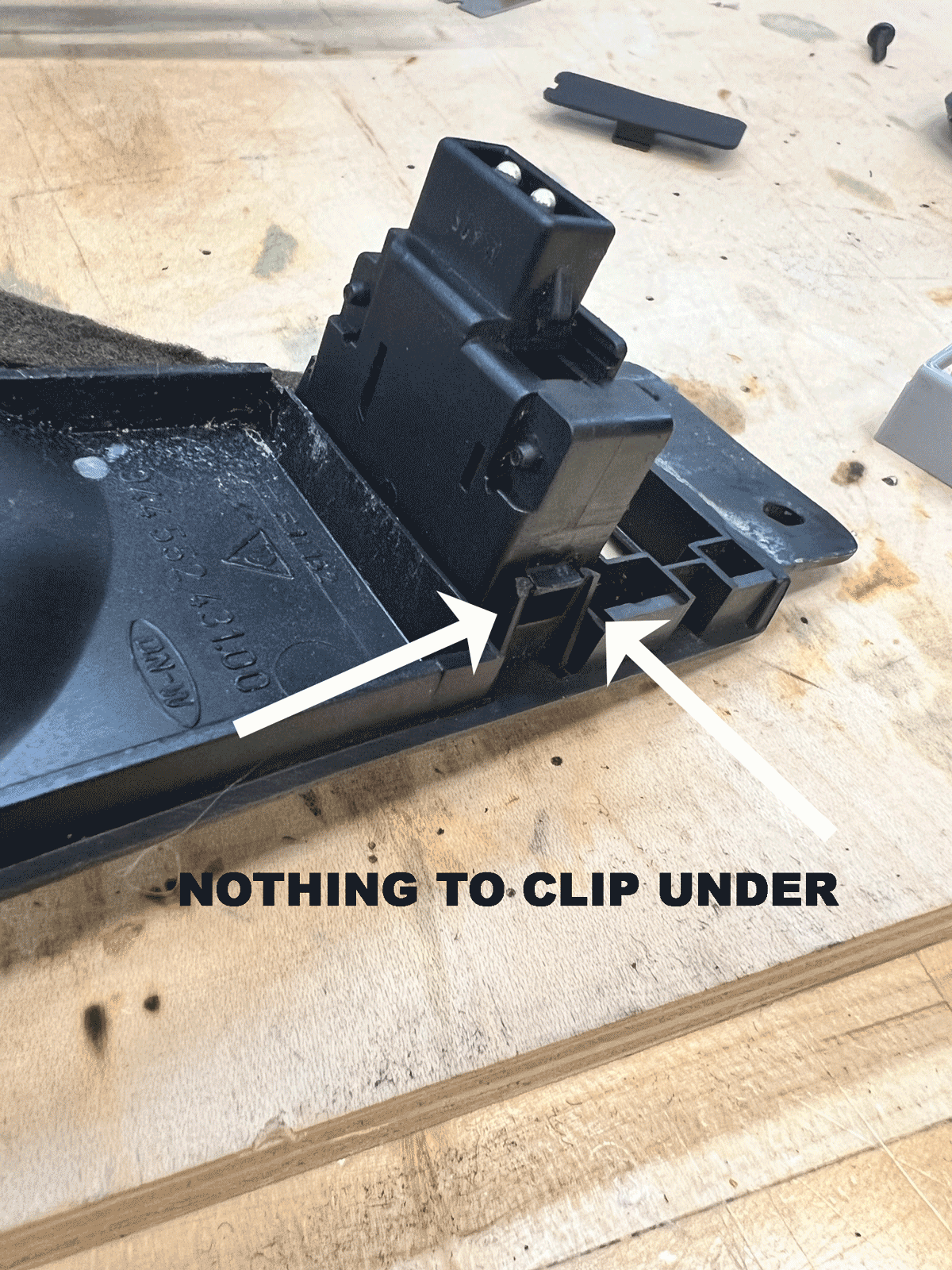

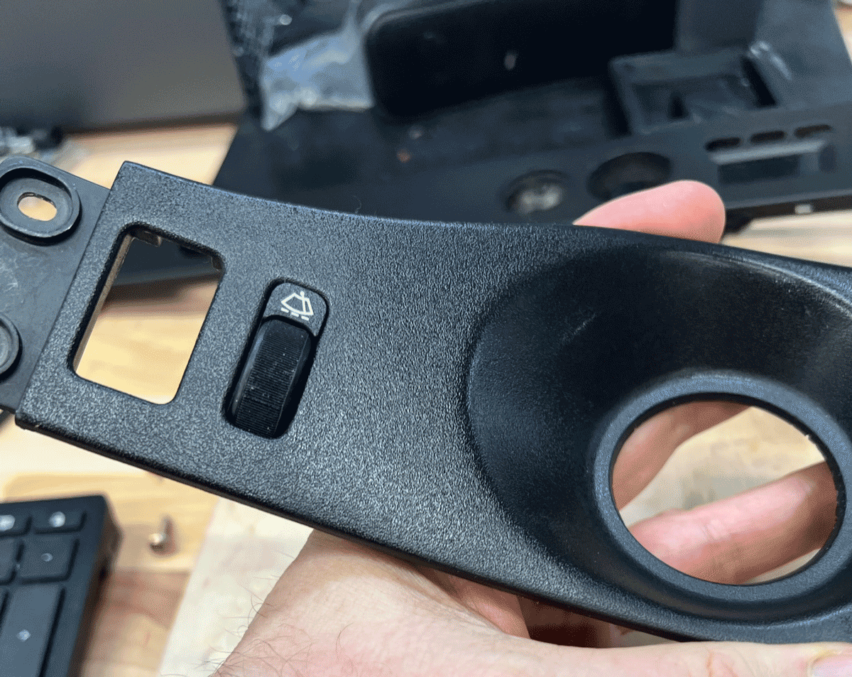

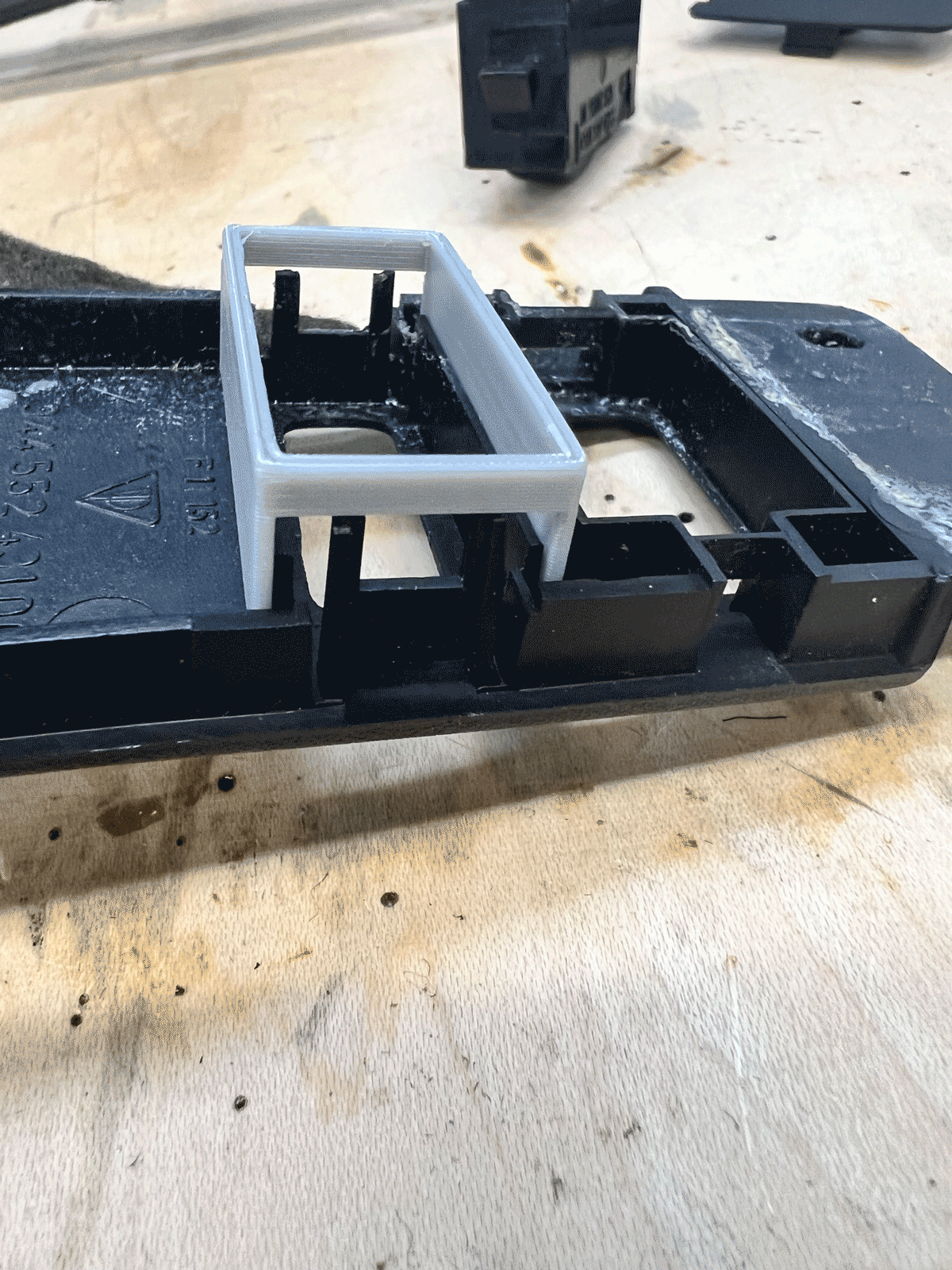

When I removed my dash, I broke the little clips that hold the windshield wiper intermittent speed control dial in place. So...as is my way.... I 3D-printed a little bridge piece in ABS that fits snugly over the original mounting port (and allows the two flat walls to be super-glued together for a crazy strong bond). The bridge has new cross bars that catch the tangs on the switch and hold it tight, while still allowing it to come out like the original. The trick is getting the cross bar height just right, and the trick to that is to put the switch in the trim and then push the bridge on over the back and hold it tight until the super glue dries. I used an impact resistance Gorilla-brand super glue, which hopefully won't crack over time. Time will tell. I can honestly say I've never used that dial in over 20 years of owning the car, but it's nice to know it's secure anyway. :)
