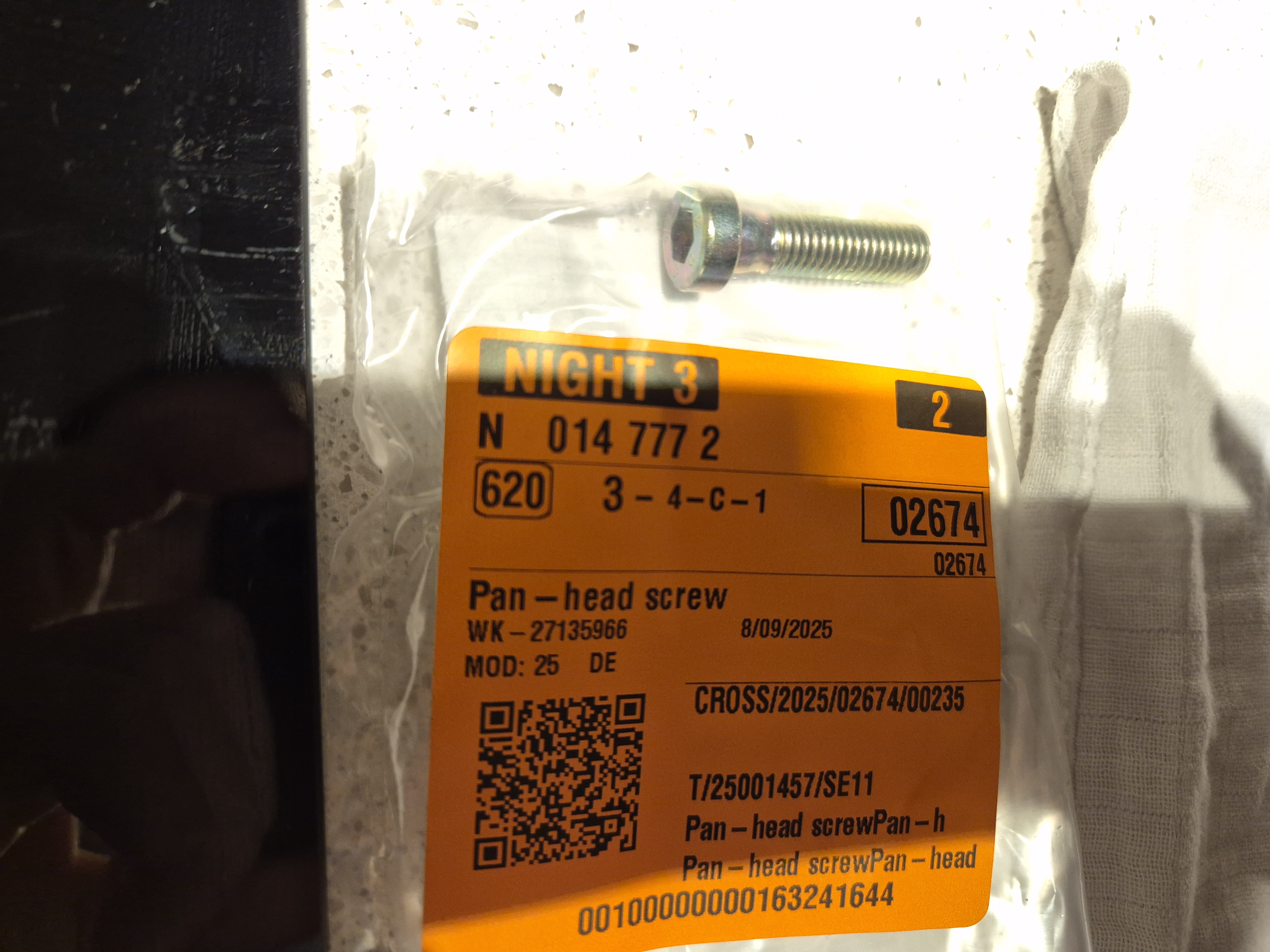

Apparently, the bolts that hold the water neck to the cylinder head have to be a bit thinner because otherwise the hose would hit them. @Tom mentioned to me that he didn't receive these thinner bolts when ordering from a Porsche dealer and they told him they don't make them anymore.
I just ordered all parts from a Belgian official Porsche dealer to replace the gaskets and the coolant hose. Here are the numbers
The line is 951 106 239 01(order one)
The gaskets are 951 104 311 03 and 944 104 311 06 (order one of each)
The actual cooling water socket is 951 104 315 0 (order one)
The washers are N011 525 13 (order 4)
N044 704 1 (pan-head screw, M8X28) (order 2)
N014 777 2 (these are the flatter pan-head screw, M8X30) (order 2)
I hope this will be helpful for someone.
