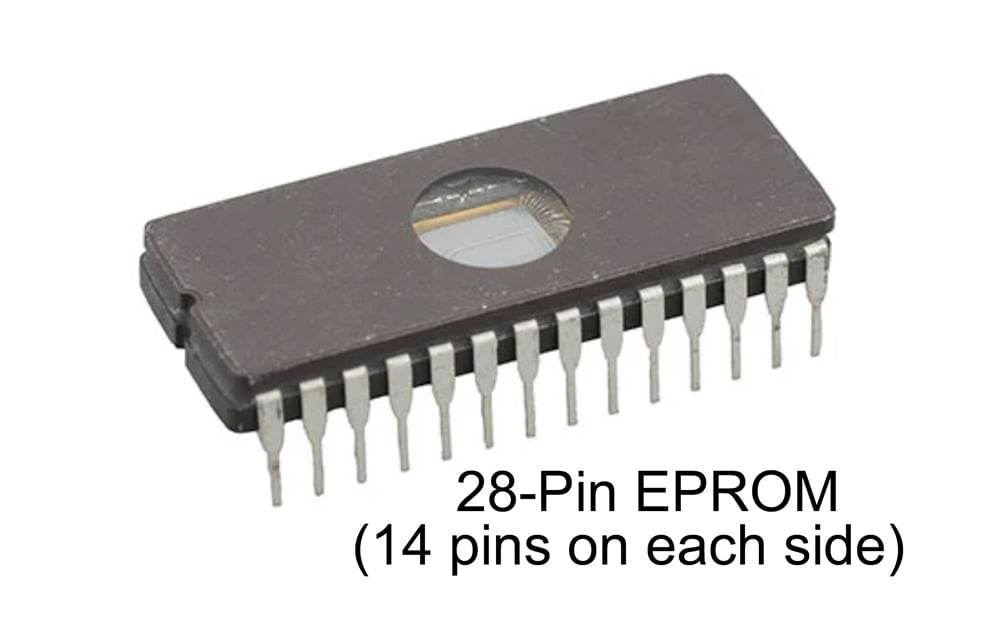

A. EPROM Chips
In the 944 Turbo DME, there is an old-school EPROM chip (Electronically Programmable Read Only Memory) that holds all the ‘maps’ needed to tune the car, such as fuel and timing maps, among other things. The DME in the early 944 Turbo uses a 2732 EPROM, which holds 4096 8-bit numbers (i.e., 4k bytes, or 32k bits). The later cars use a 2764 EPROM, which hold 8,192 8-bit numbers (i.e, 8k bytes or 64k bits). You can easily tell the difference because the 2732 chip has 24 pins, whereas the 8k chip has 28 pins. On the 28-pin chip, the first 4k of memory contains the machine-language instructions/program needed to run the DME’s processor, and the upper 4k holds the tuning data you edit when making your own chips. On the 24-pin chips, the only information on the chip is the tuning data, with the DME’s programming code residing elsewhere in the DME.
Importantly, the tuning map structure is the same whether residing alone on a 4k chip or in the upper half of an 8k chip. As such, if you have a good tune on a 24-pin chip, you can copy it over to the upper half of an 8k chip without problems, as long as you preserve the programming data in the lower 4k of that chip. Similarly, you can copy the tuning map data from the upper half of a 28-pin chip and burn it onto a 24-pin chip.
These EPROMs were made by most of the big chip manufacturers back in the ‘80’s, each with their own unique part numbers. They are out-dated technology today, however, so you may not find them at the big electronics suppliers. You can typically find them on Amazon, eBay, etc. by searching for 2732 or 2764 EPROM. I get mine from Jameco Electronics in California. The actual chips tend to have additional letters in their part numbers, signifying the manufacturer, the type of technology used, etc., but just about any of the variants will work. Here are a few that I’ve used:

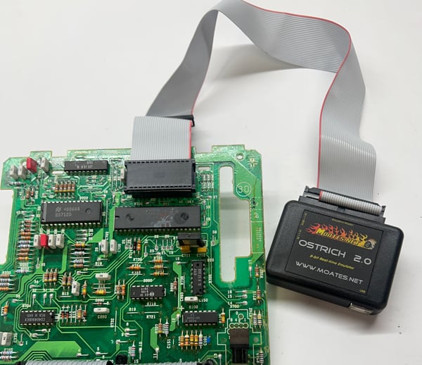

B. EPROM Emulator – Moates.net Ostrich 2.0
The Ostrich 2.0 is an EPROM emulator with a long ribbon cable that plugs into the DME in lieu of the normal EPROM chip, and connects to your laptop via a USB port. You can then make all tuning edits straight from TunerPro RT to the emulator and see the results immediately, even while the motor is running. Once you are happy with your tune, you can either leave the Ostrich in the car permanently or burn an actual EPROM chip with your final image. Without the Ostrich, every edit requires you to remove the EPROM from the DME, erase it with a UV eraser, burn a new image onto it using the EPROM programmer, and then re-install the newly-burned chip in the DME. Either way works, but the Ostrich speeds up the tuning process exponentially and avoids wear and tear on the DME. The Ostrich only works with 28-pin DMEs, however, but it’s cheap and easy to convert a 24-pin DME into a 28-pin DME. See instructions for doing that here. Once converted, the Ostrich will work fine – just remember you will need to use 8k chips/maps, and not the 4k chip/maps that came with the DME.
As of the summer of 2025, the Ostrich 2.0 is available for $175 directly from its maker, Moates.net. You can buy it here.
The Ostrich is not the only EPROM emulator available, but it’s particularly well-suited for this application, and is specifically supported by TunerPro RT. RT is the ‘real-time’ version of TunerPro that interfaces with the Ostrich, not to be confused with the regular non-RT version. Beware of a company called BoostedNW, which makes a series of claims about selling the Ostrich and/or a similar replacement. I originally believed their claims and tried to order from them, and it was a frustrating exercise in futility. Google for ‘BoostedNW reviews’ if you want to get a sense of their reputation. You’ve been warned!

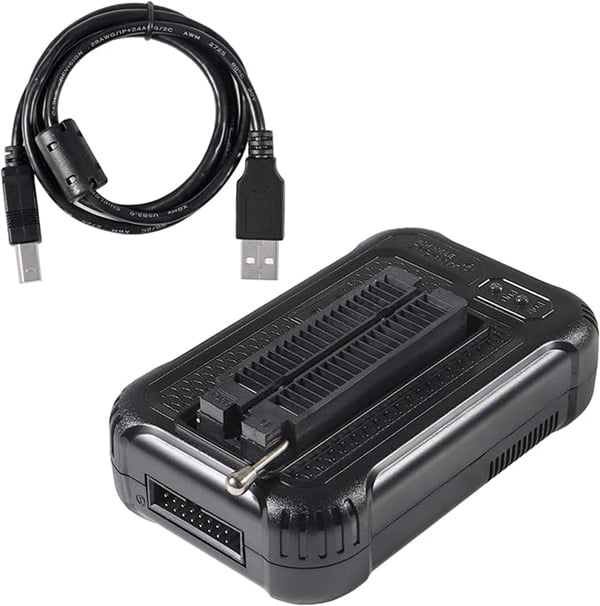

C. EPROM Programmer
If you want to program an actual EPROM for your DME or KLR, you will need an EPROM programmer. Fortunately, these once-expensive devices have been commoditized and are available on the cheap from places like eBay, Ali-Express, and Amazon. There are many programmers available, just be sure you confirm that you buy one capable of programming 2732 and 2764 EPROMs. I use a generic programmer made in China and sold under various names like ACEIRMC T48 TL833-3G and Xgecu T48 TL866-3G, shown here.

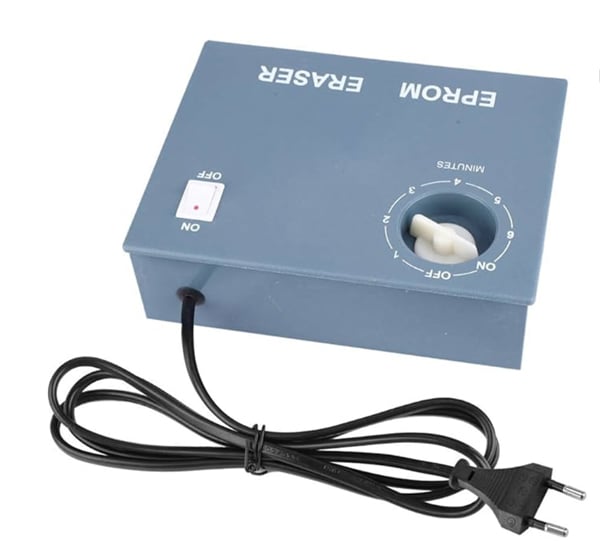

D. EPROM UV Eraser
To erase an EPROM chip, just about any UV EPROM eraser will do. These erasers have a light inside with a specific wavelength (253.7nm) that erases all data on the EPROM. You just pull out the sliding drawer, put your EPROM(s) inside and let the light zap it for about 15 minutes. If you google for EPROM eraser, there are 2 or 3 popular units that appear all over the Internet, each so generic they generally don’t have brand names. If you shop around, you can get one for about the cost of lunch at McDonalds. I use the one pictured below as it tends to be the cheapest and works just fine. When you erase an EPROM, be sure to remove the sticker on top to expose the clear glass window, so the UV light can get inside to erase the memory. Once erased, be sure to re-cover the glass window to keep unwanted sunlight or other UV light out.

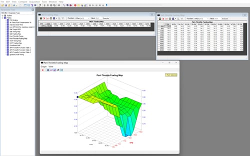

3. Software Needed
TunerPro is free software you can use to modify the maps in your chips. If you plan to use the Ostrich emulator, you want to get the ‘real time’ version called TunerPro RT. You can download the latest versions of TunerPro and TunerPro RT here: https://www.tunerpro.net/downloadApp.htm
Once you have TunerPro, you will also need a chip image to use as your starting point for tuning, and something called an XDF file. The XDF file is essentially a table of contents to the maps on the chip. When you tell TunerPro you want a 920 RPM idle speed, for example, the XDF converts 920 into a number the DME interprets as 920, and stores it in the specific memory location used for that purpose. We can thank our reverse-engineering pioneers for unearthing the important map locations! There are at least two community-developed XDF files in general circulation for the 944 Turbo, although both have some errors that prevents certain maps from working. We've combined the best of those XDF files into one, corrected the errors, added more maps, and posted our own XDF files in the download section here on Carpokes.
In many cases, when you enter a value in TunerPro, the software will convert that number to something different for DME use before entering it into the BIN. For example, if you look at the fuel scaling locations in the BIN for the FQS switch (e.g., 0x17B), you’ll see 0x80 (decimal 128) in that location. The DME is coded to interpret 128 as the base case for fuel flow, and will increase or decrease fuel in proportion to any deviation from 128 found in that cell. It’s logical, but not all that human friendly. As such, the XDF files are set up to do some math behind the scenes, so that the numbers you see and edit in TunerPro make intuitive sense (where possible). For the FQS cells, for example, our XDF allows TunerPro to show flow in pounds per hour. If you ever need to dig into the hex BIN values, just keep in mind they may or may not match the numbers you see in TunerPro. If they don’t match, you can see the conversion used for any particular parameter by clicking on the XDF tab > View/Edit Parameter XDF Info >Conversion.

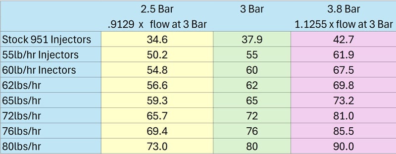

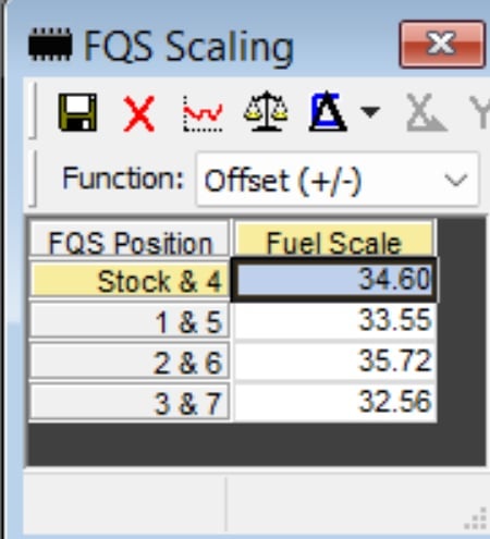

5. Fuel Pressure and Injector Size Adjustments
The stock 944 Turbo chips are mapped for use with the stock 384cc/min injectors and stock 2.5 Bar fuel pressure regulator. To change that for different fuel pressures or injectors, you can adjust the fuel quality switch (FQS) settings in TunerPro. The FQS is a rotary switch on the DME with 8 positions (0 to 7), which can be used to make global scaling adjustments to the fuel flow, as well as ignition timing adjustments. The factory included it as a way to accommodate different levels of fuel quality around the world, but we can repurpose those settings to account for bigger injectors and more fuel pressure. In TunerPro, you'll need to adjust the flow rate for the particular FQS switch position you plan to use.
In our XDF file for TunerPro, the FQS numbers are entered as injector flow rates in lbs./hr. In the table above, it shows the flow set at 34.6 pounds per hour for FQS positions number 0 and 4 -- i.e., the flow rate of the stock injectors at 2.5 Bar fuel pressure. If you were running 62 lbs./hr. injectors at their rated pressure of 3 Bar, for example, you can simply enter 62 in the desired FQS position and all the fuel maps will be scaled accordingly. (But see injector dead-time adjustments below.) Flow ratings for nearly all injectors are based on 3 Bar of fuel pressure. If you keep the factory 2.5 Bar fuel pressure regulator, or run anything other than 3 Bar of pressure, you will need to adjust the FQS flow rate to account for the change in pressure. The math for doing that is summarized below, but to make things easier, here is a chart showing the numbers to enter into the TunerPro’s FQS cells for various injector flow rates and fuel pressures. It shows 2.5, 3, and 3.8 Bar because those are the common fuel pressure regulators that fit the 944 turbo.
The Math: If you want to do your own math, you'll need to know what your injectors are actually flowing in lbs./hr. at whatever pressure you are running, and enter that in the FQS cells. As an example, the stock injectors are rated to flow 384cc/minute at 3 Bar of fuel pressure, which translates to about 37.9 pounds of fuel per hour (assuming a typical gallon of E10 gas weighs about 6.2 pounds). However, the stock 944 Turbo has a 2.5 Bar fuel pressure regulator, so the injectors will flow less than that.
How much less? The change in flow is proportional to the square root of the quotient of the new pressure (2.5 bar) divided by the original pressure (3 Bar). Doing that math: 2.5/3 = .833... and the square root of that is ~.9129. So if the injectors flow 37.9lbs./hr. at 3 Bar, they will flow 37.9lbs./hr. x .9129 at 2.5 Bar, i.e., 34.6. Not surprisingly, that’s the number you’ll see in TunerPro when looking at FQS position 0 on a stock chip. If you were running an adjustable fuel pressure regulator at 3.4 Bar, for example, you’d get ~40.3lbs./hr. using the same math. The square root of 3.4/3.0 is 1.0646, so the stock injectors flow 1.0646 x 37.9lb/hr or 40.3lbs./hr. at 3.4 Bar. Note that this is also what you’d get by interpolating between the entries in the chart above.
