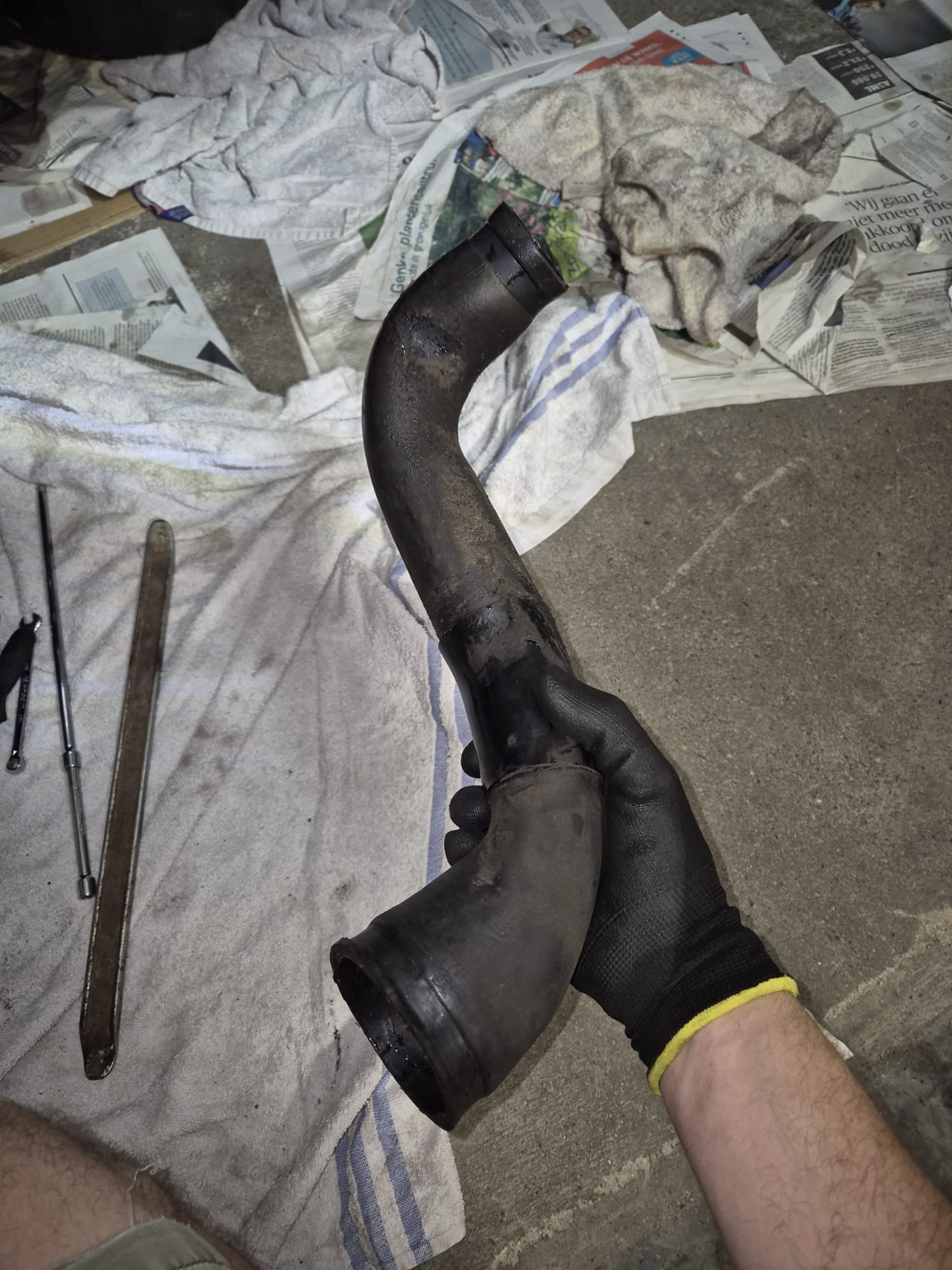

Unfortunately, the lower radiator to waterpump hose (which failed on me) was wrong in this set. It's way too short. After getting the faulty hose out of the car, I checked it for a part number: 951 106 237 03
This is the hose:
WhatsApp Image 2025-08-14 at 21.45.04 (2).jpeg (325.54 KiB) Viewed 1259 times

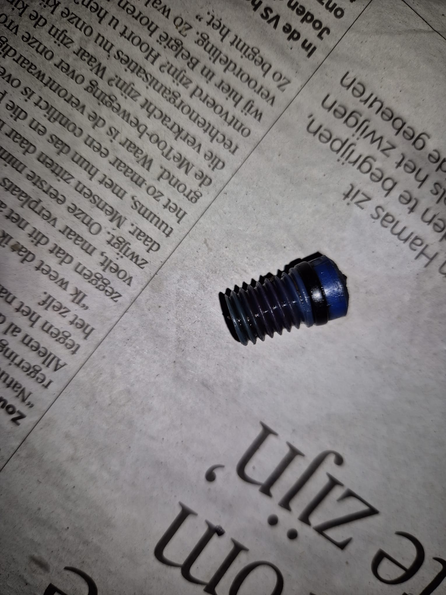

This is seemingly the hose for a post 89 951. So for a late radiator model... This is interesting (and very frustrating at the moment) because the radiator drain plug is also blue in my car, but is not exactly as either one pictured here: https://944online.com/radiator-drain-plug/ I actually bought the black one before, and it didn't fit.
This is the plug in my car (I reused it):
WhatsApp Image 2025-08-14 at 21.45.04.jpeg (270.36 KiB) Viewed 1259 times
WhatsApp Image 2025-08-14 at 21.45.04 (1).jpeg (206.35 KiB) Viewed 1259 times
Are there other tells to differentiate the early and late radiator? Will the other hoses from the partworks set fit my car? (I'm sure a few will fit from my visual inspection).

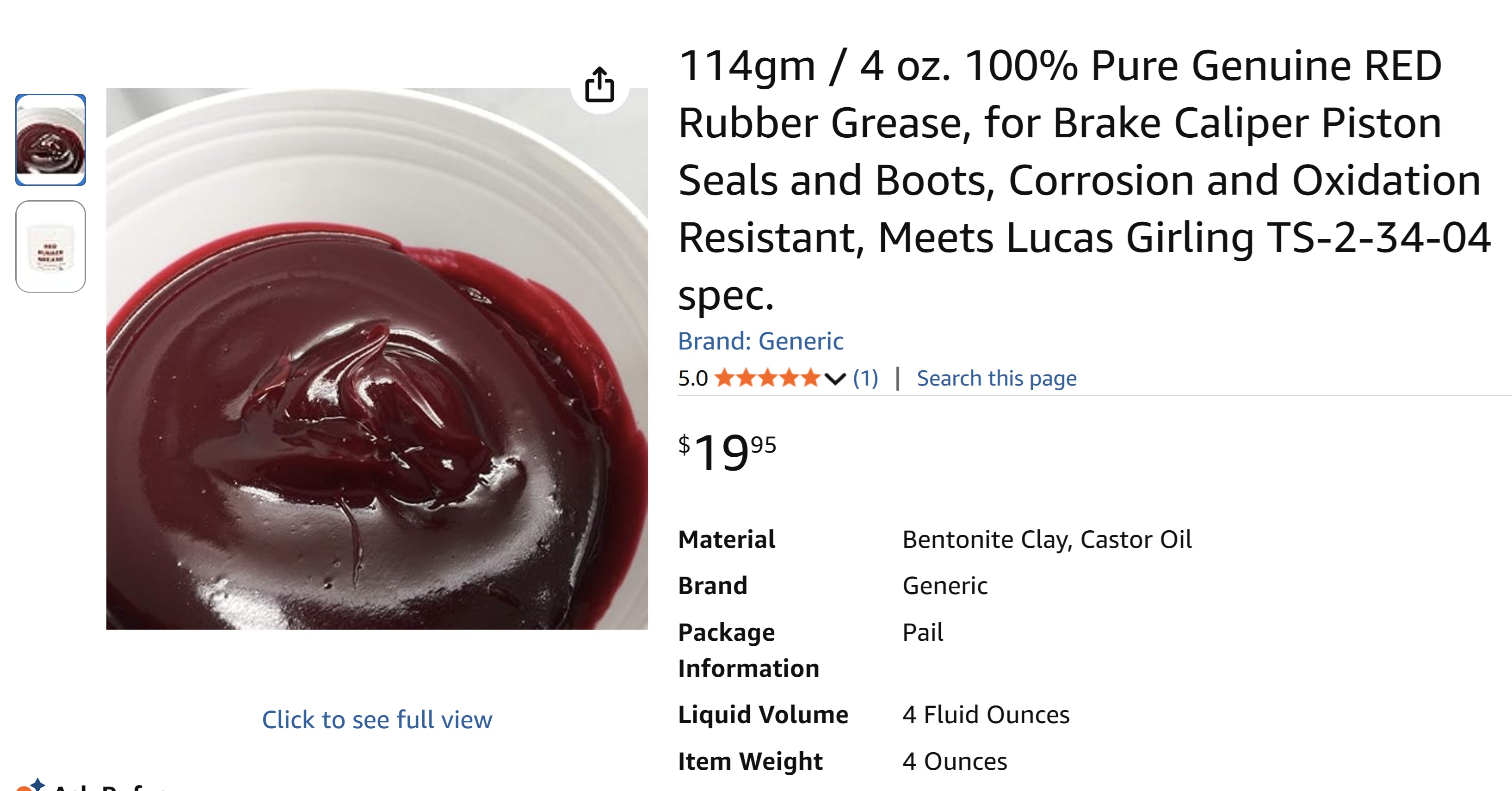

Another question is how can I get the hoses to slip on easier? I read silicone spray, but won't that foul the coolant system? Heat or boiling water will be difficult to access since the garage doesn't have access to neither.

The hose set pictured appears to be an assortment of hoses from the cooling system and the air intake system.
Posts: 8955
Has thanked: 936 times
Been thanked: 4020 times
As far as I know, all 944 turbo's use the same lower hose, which is the same as the one you removed with a superseding part number of 95110623704. There are some ill-fitting after-market hoses out there. Maybe that is your issue? Or maybe the part seller is just confused. That hose in the kit they sell doesn't look like the right part at all. Here is the 951 lower hose, as sold by Pelican and listed for all 86-89 turbos...

See the 16:15 mark in this video from Edd China regarding how to get the hose to slip on easier. He recommends Red Rubber Grease...
red rubber grease.jpg (571.88 KiB) Viewed 1231 times

Yeah they have the correct hose in their late model kit for the 250 HP version. I guess I should have checked the hose before I ordered the part.
I'm on the fence to order the hose... should I go for original Porsche or the URO hose? There's a "German" hose pelicanparts sells that has the same extra protective layer as the original (which the URO hose misses), but it's out of stock.
Thanks for the help.
