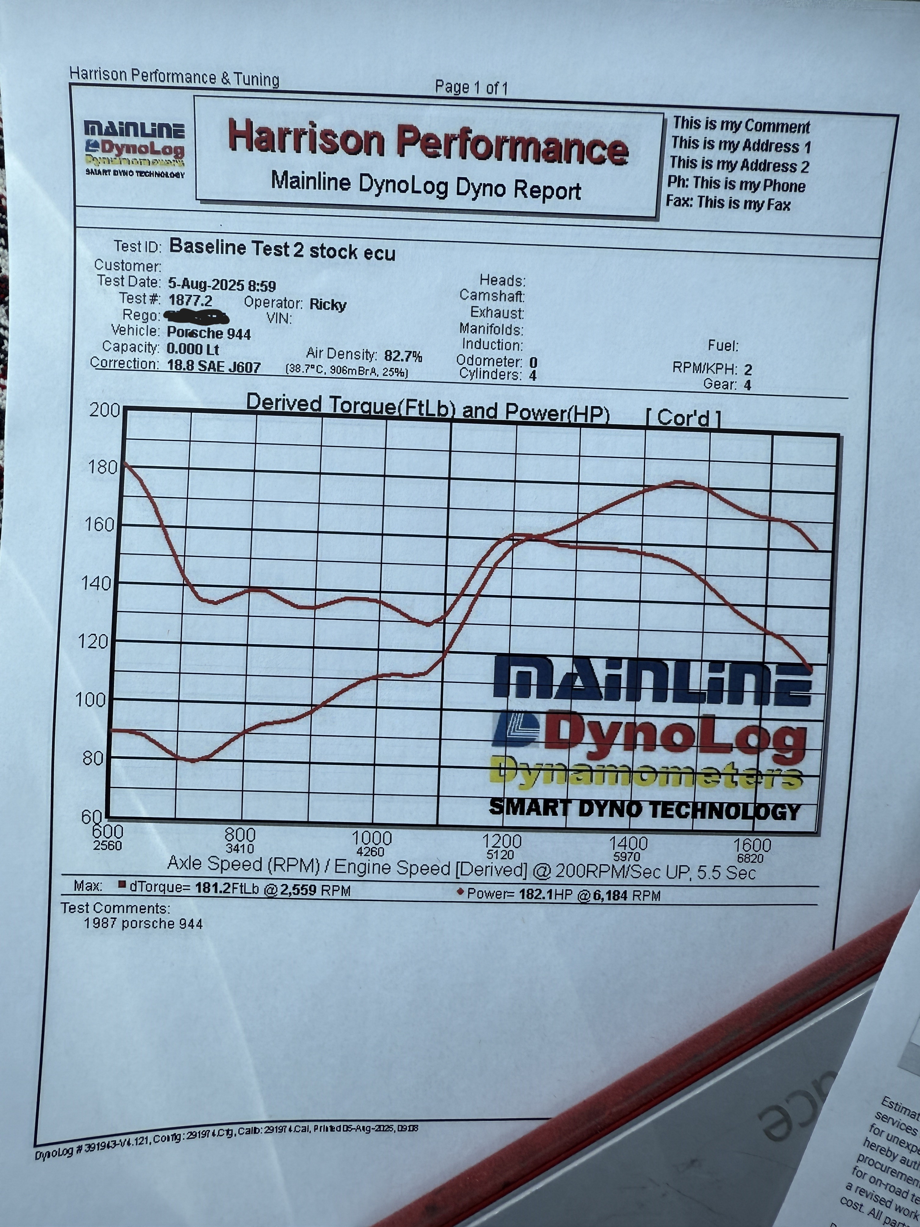

I just has my 97 944 S1.5 (87 944s with an S2 motor) dynoed. The motor was rebuilt without touching the bores about 40k miles ago and is bone stock but the ECU may have a Firehawk chip. The only changes to it are the exhaust (Magnaflow header back Y pipe, Boral resonator and Borla muffler). I'm happy with the numbers. I will be doing a MS2PNP ECU, a mild ported head and new Cat Cams 5220212 283 272 duration and a 968 intake.
The 182 HP and TQ in the 160 Ft/lb region is a great starting point. and this dyno is intended just as a baseline.

Looks like a solid S2 motor. Will be interesting to see what you get with those mods. Please do keep up posted. :angel:
