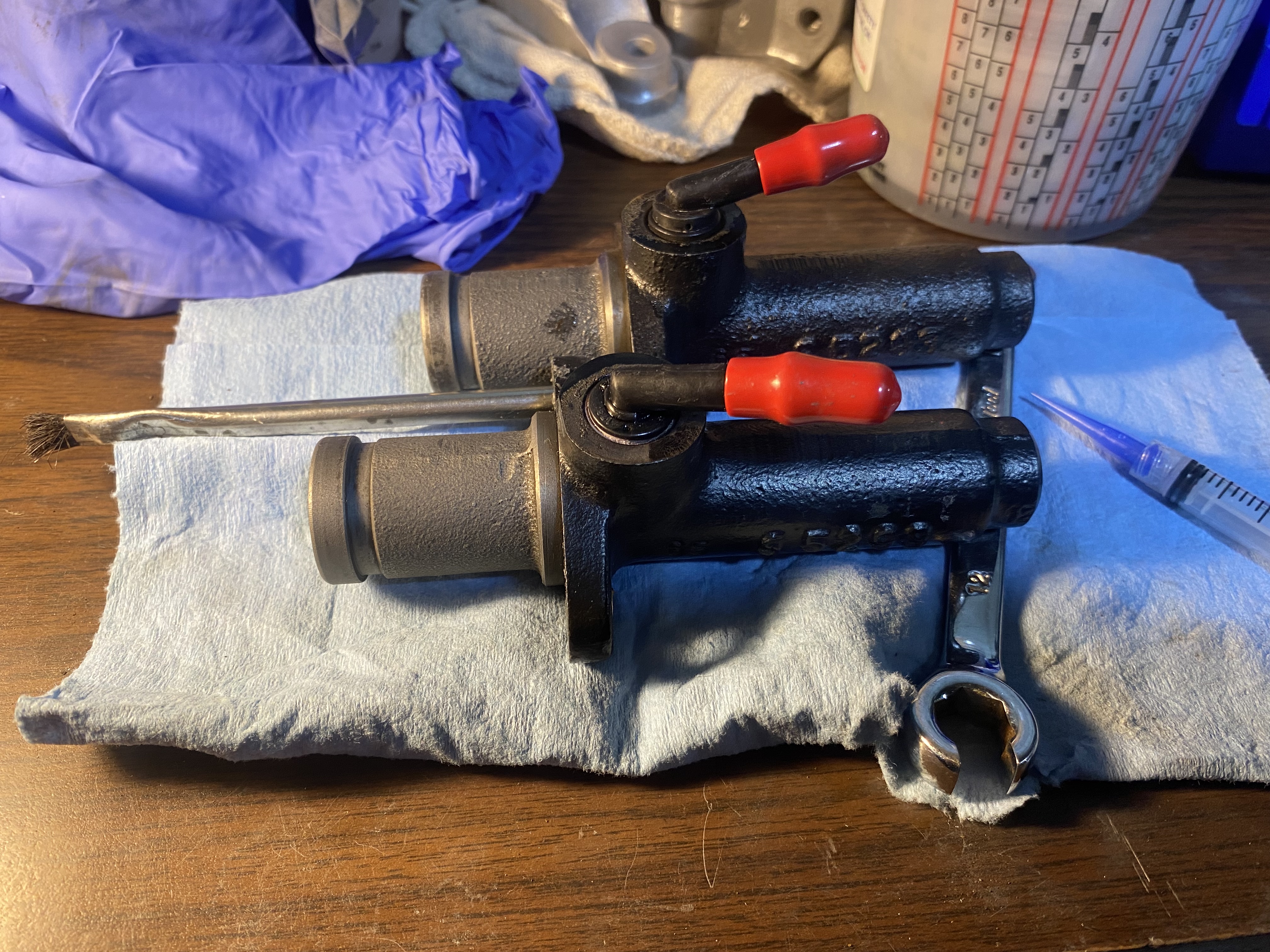

Removed some rust from a couple slave cylinders that are low mileage and relatively new.

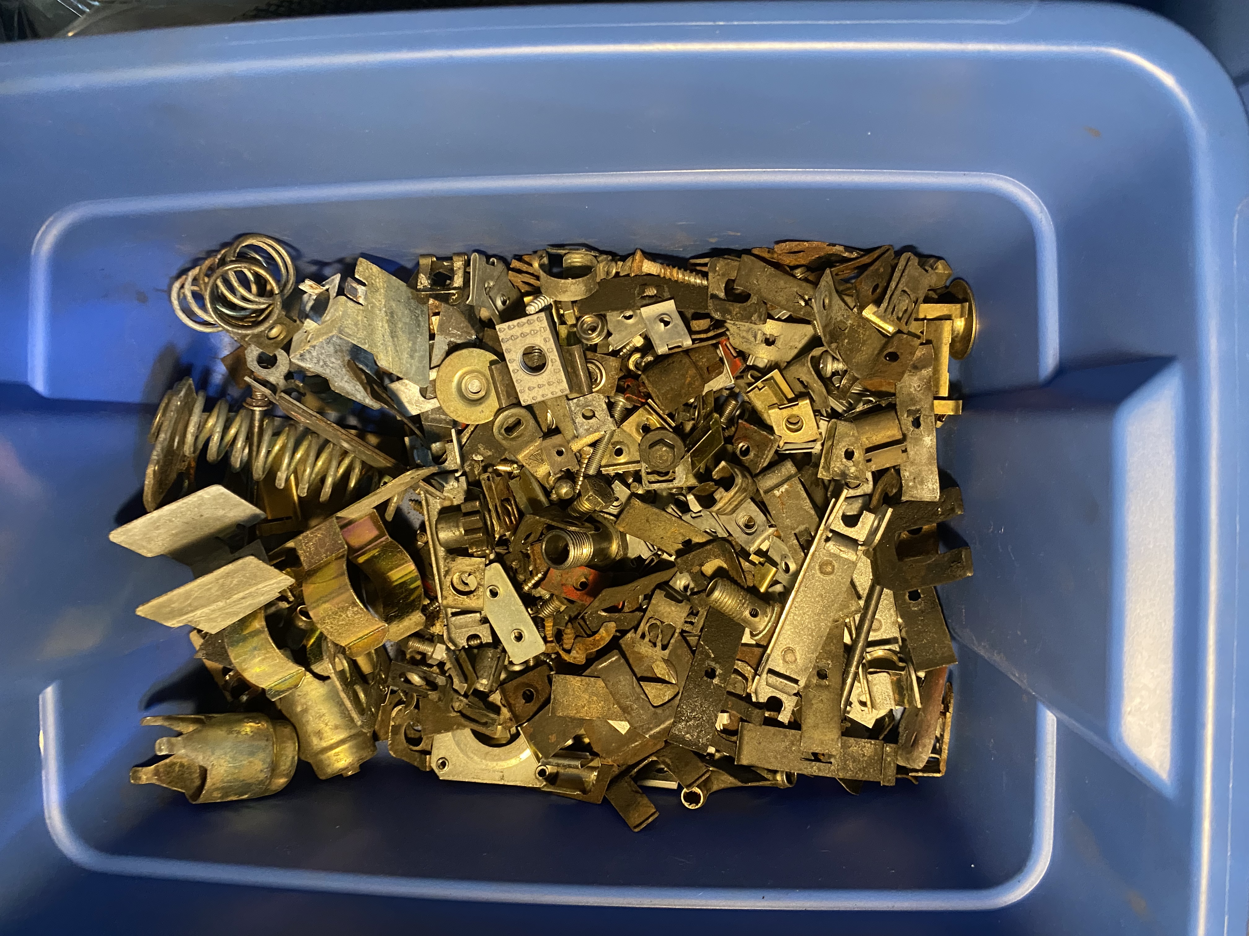

Also prepping some hardware for plating with a home kit. Small stuff amongst hardware in the pics that could easily be lost at the local plating shop.

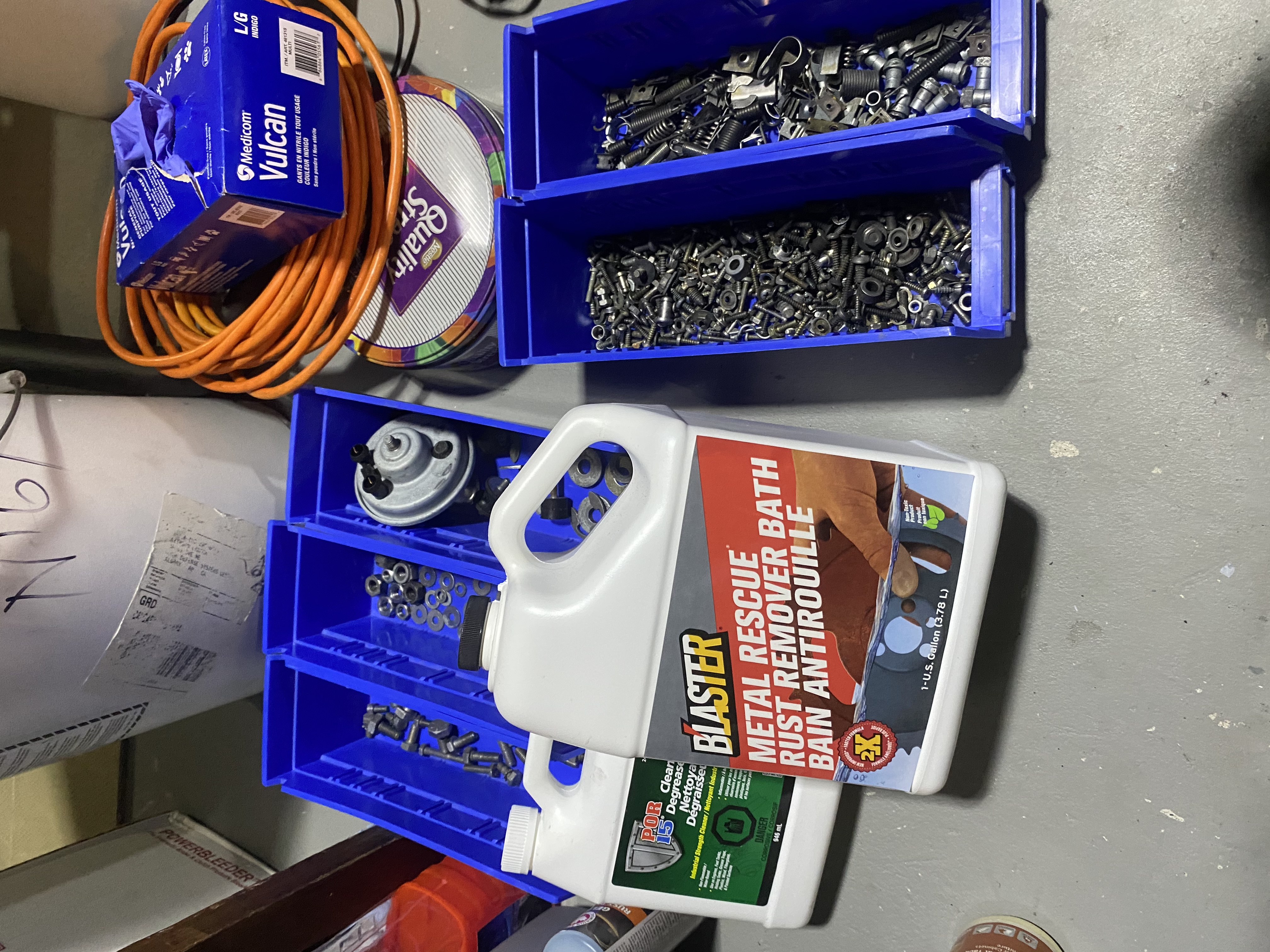

There are other rust removal liquids but this is the first one I have tried. Going to try some other rust removal products.
The Por 15 worked well to clean the hardware also 100% isopropyl alcohol.

Slave cylinders look better than new, literally. :) I got into caswell zinc plating a few years ago. It was a lot of work, but if you follow the instructions to the tee, it really does work. The minute I'd cut a corner, the zinc or yellow chromate would get blotchy and want to rub off. I've since learned that you can use their yellow chromate to make shiny silver hardware store bolts look like Porsche originals. :) I only got good results on mild steel parts. Anything made of spring steel or stainless just didn't hold any kind of plating for me. We have a plater pretty close by, so I'm still inclined to use them for bigger parts/batches (quicker and easier), but the Caswell stuff is nice to have, especially for little one-offs that don't justify the minimum charge at the plater and/or for things you can't risk losing....

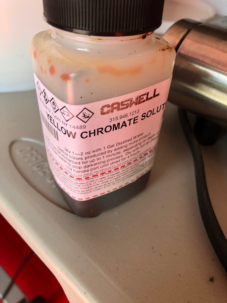

In case inspiring, here are some shots...
Hardware store bolt....before
After yellow chromate.....
yellow chromate.jpg (107.33 KiB) Viewed 1289 times
Mercedes alternator bracket, plated and yellow chromate at home....
yellow bracket.jpg (151.19 KiB) Viewed 1289 times
This bottle alone is all that's needed to transform hardware store bolts....
yellow chromate bottle.jpg (86.23 KiB) Viewed 1289 times

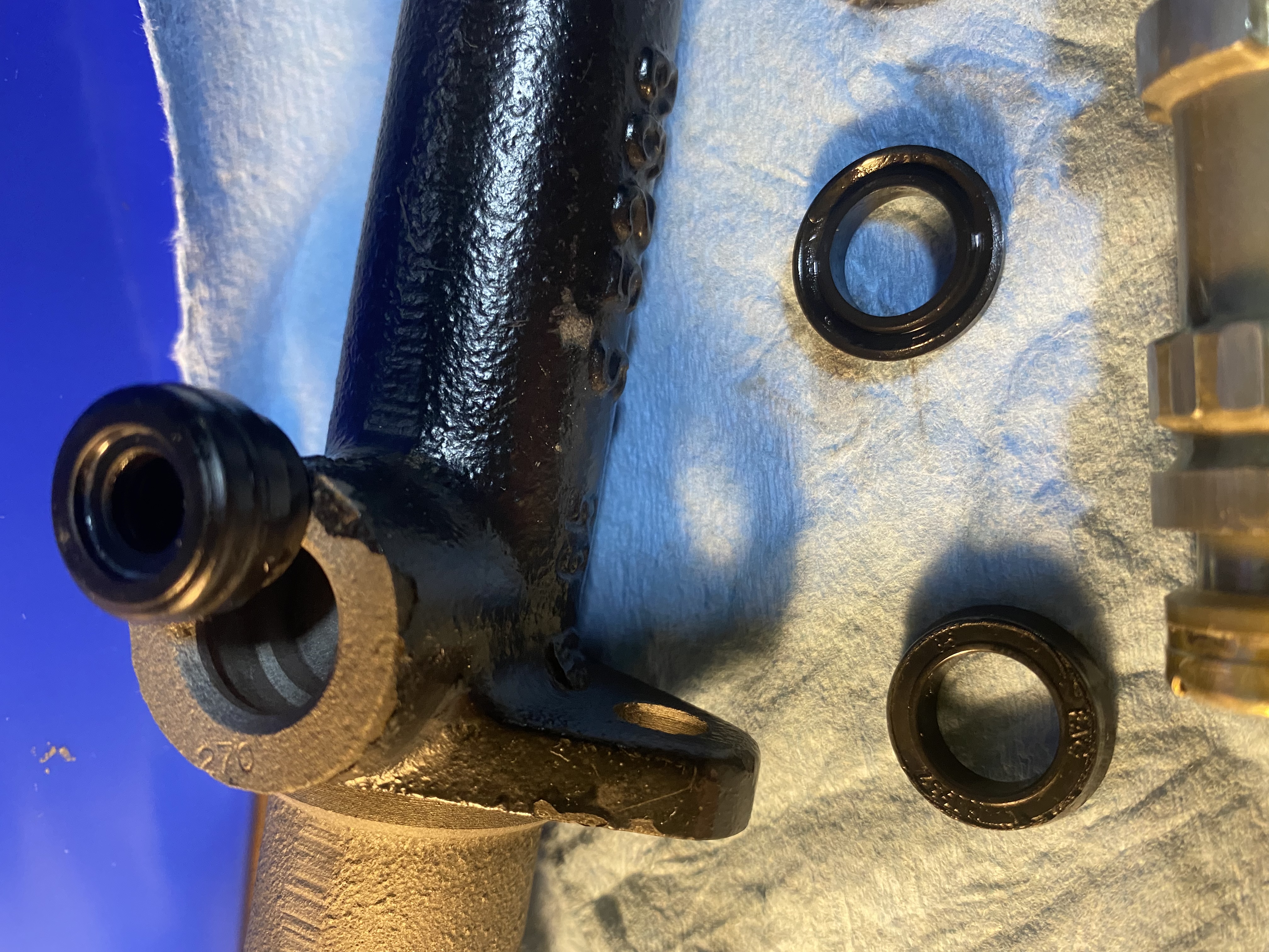

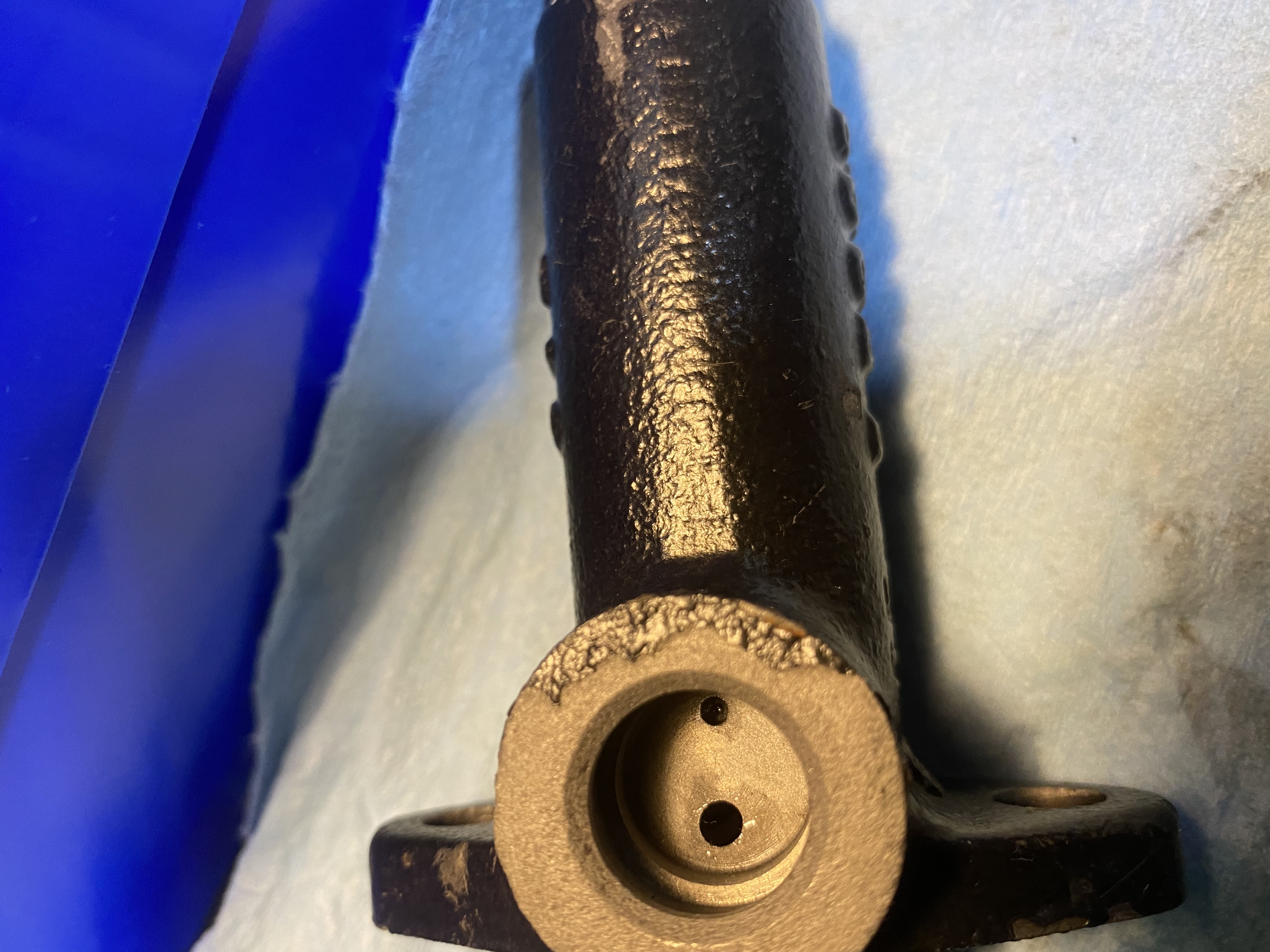

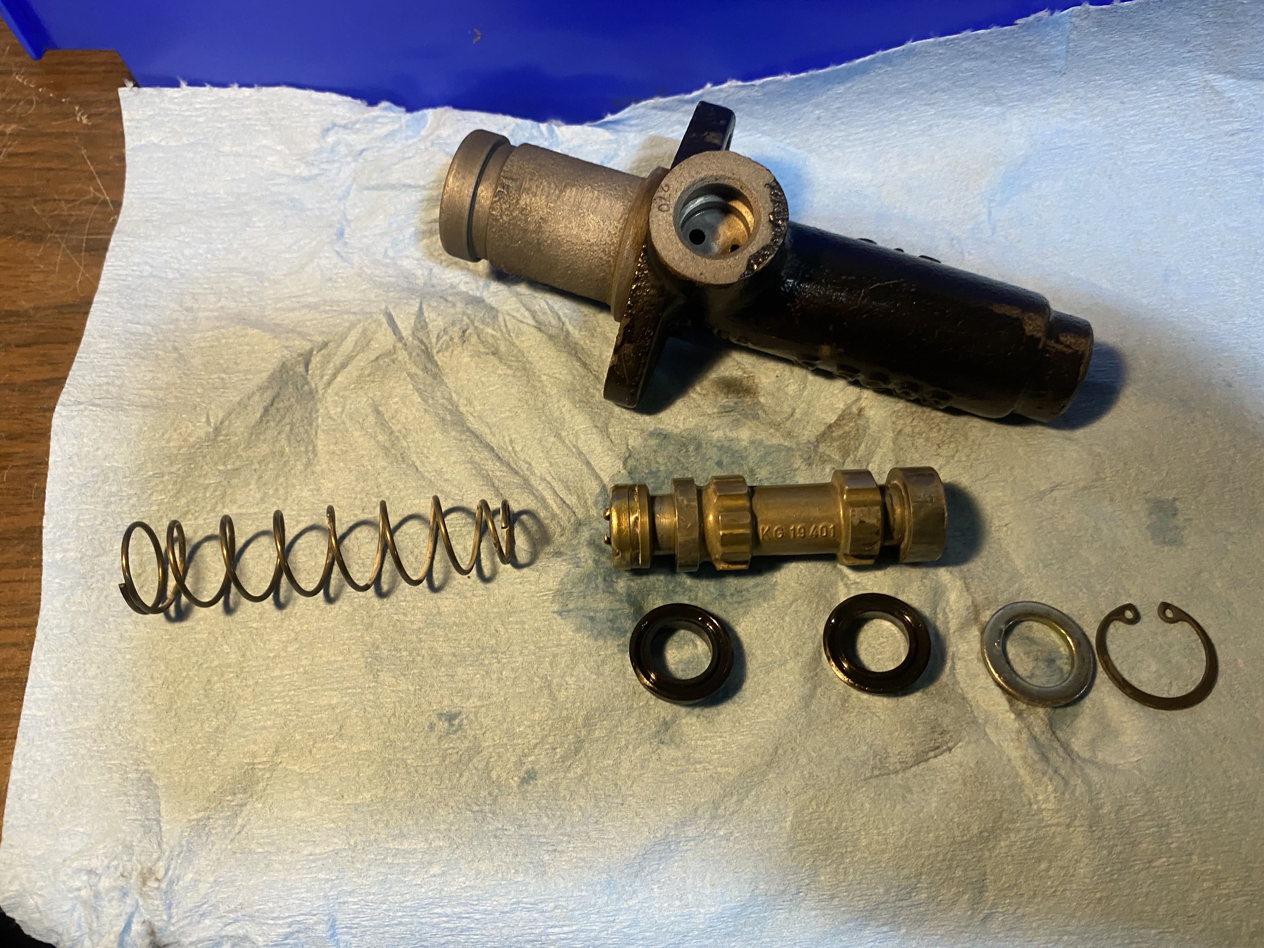

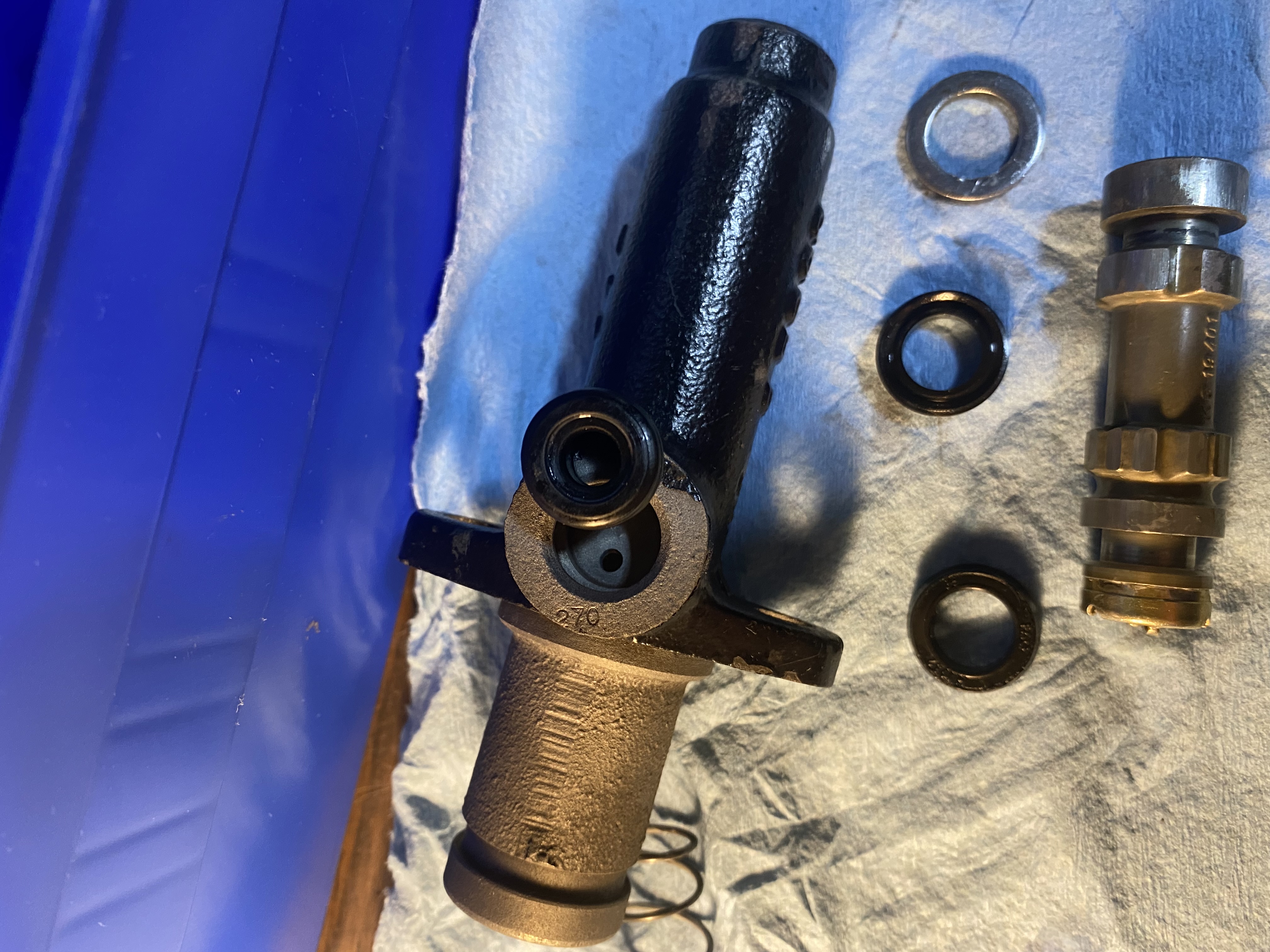

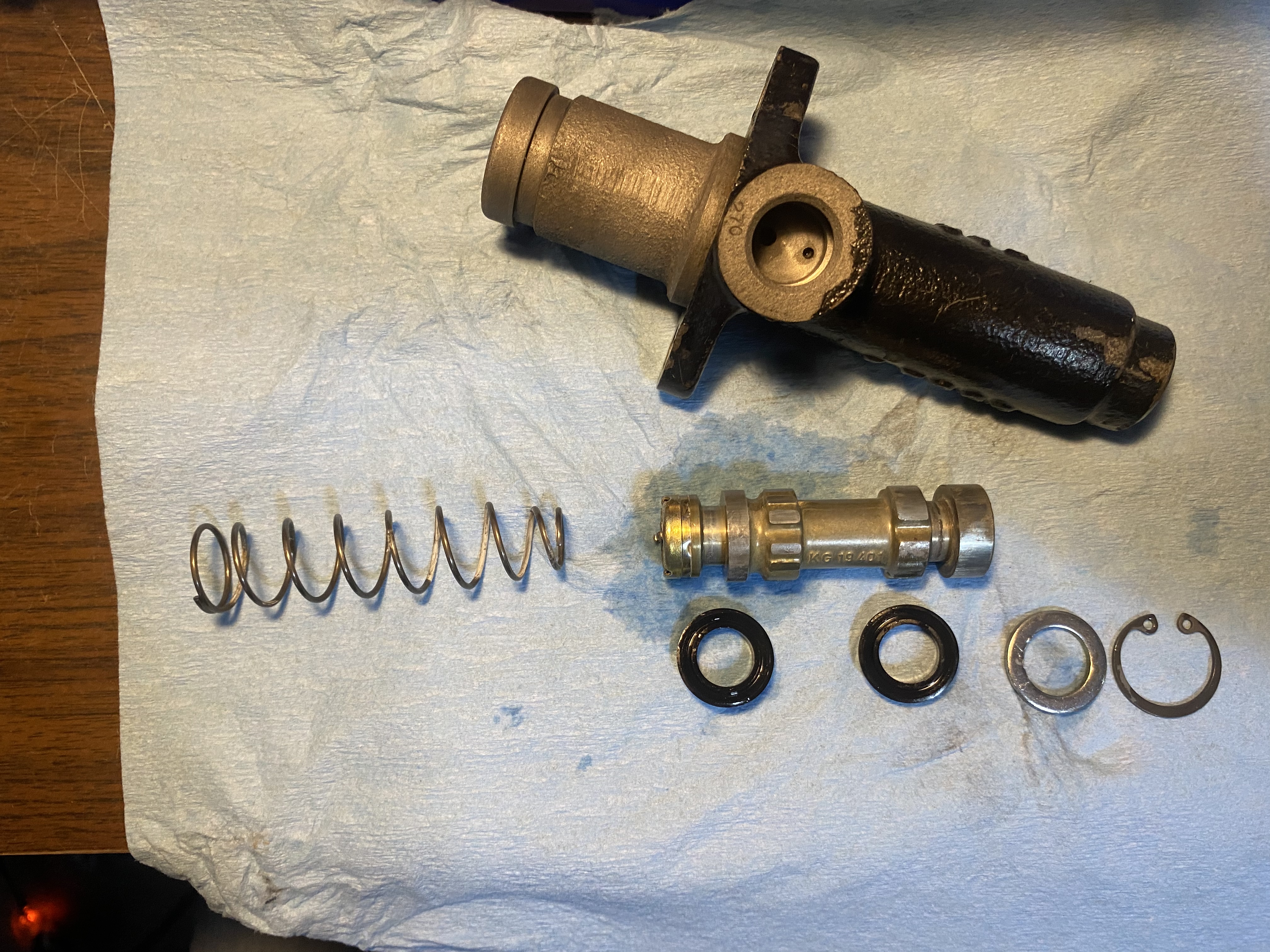

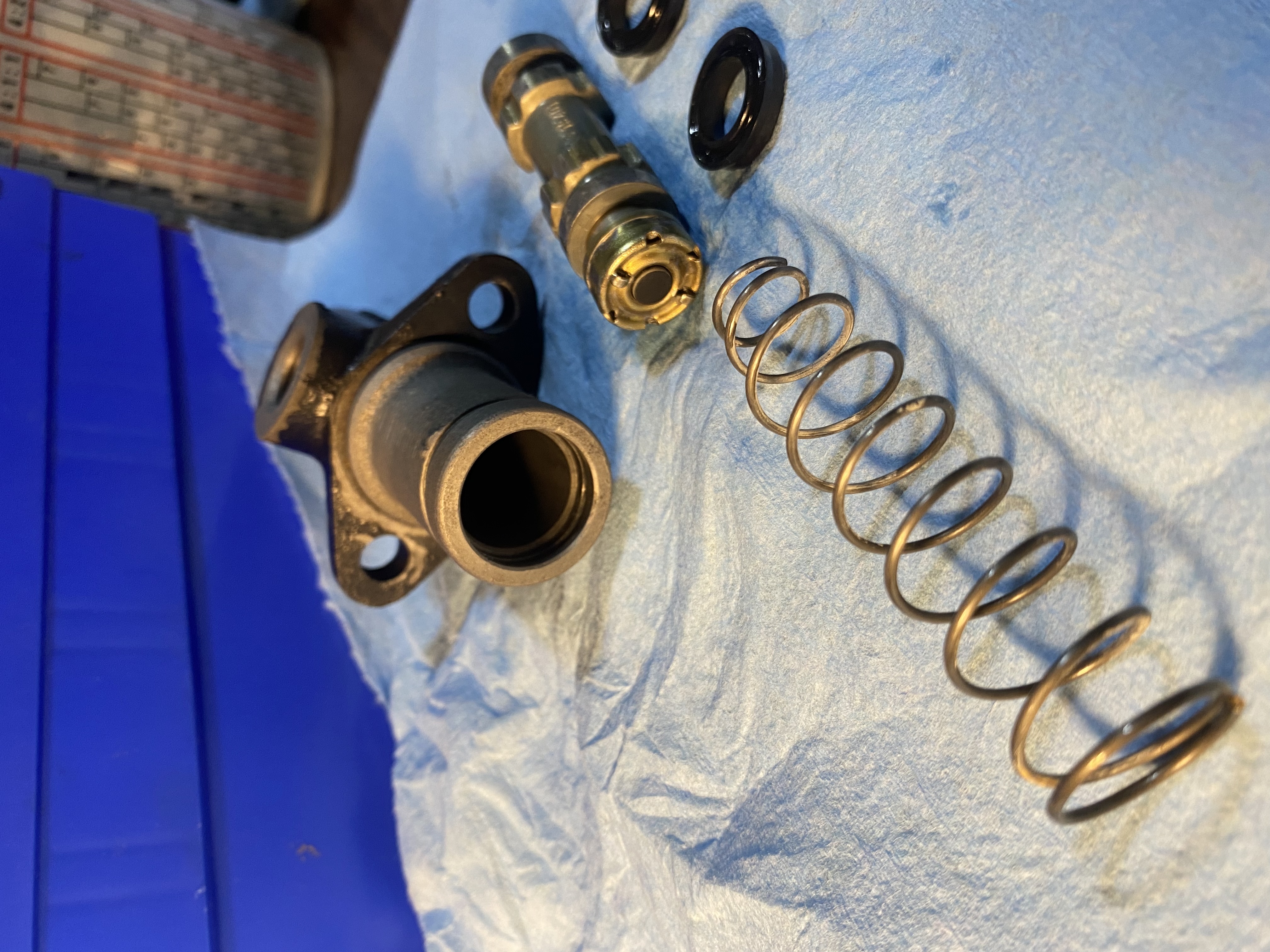

I dismantled the worst of the the 3 slave cylinders.
Can’t believe how much better it is.
Cleaned the hell out of the body then soaked it in rust remover.
Cleaned the 3 seals with alcohol and then with the rubber restoration products.
Just need to put back together and paint.
All the seals are in fantastic condition

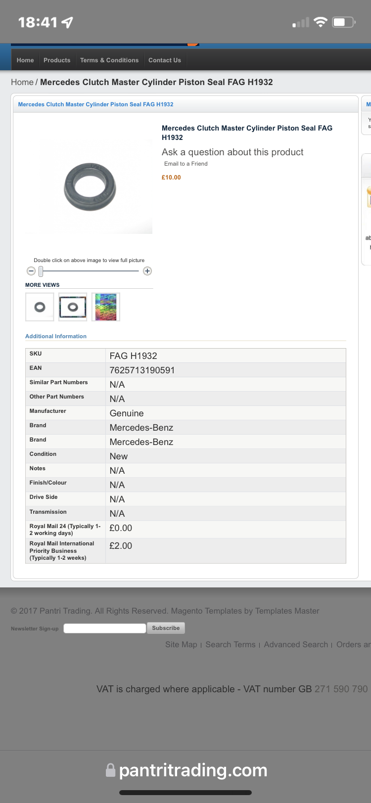

Slave seals are FAG H1932 which show up as a Mercedes seal
None of these were leaking they just had rust
