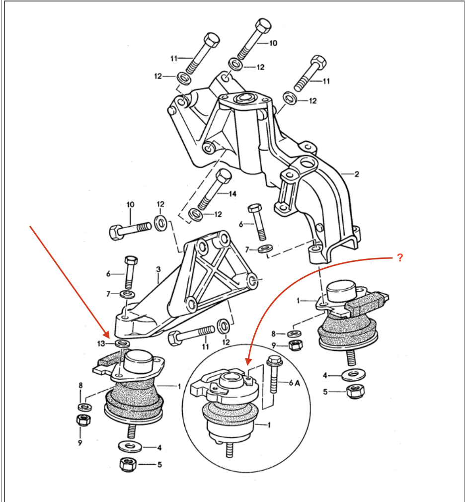

Does anyone know if the "new" style motor mounts require washers between the passenger side mount, and the passenger side engine carrier ? Upon removal at least one came off of my car, which had the old original style 40 year old mounts. The PET isn't incredibly clear to me.

Later style, hydraulic mounts need no washer, as per the illustration.

Thanks for clearing that up !
