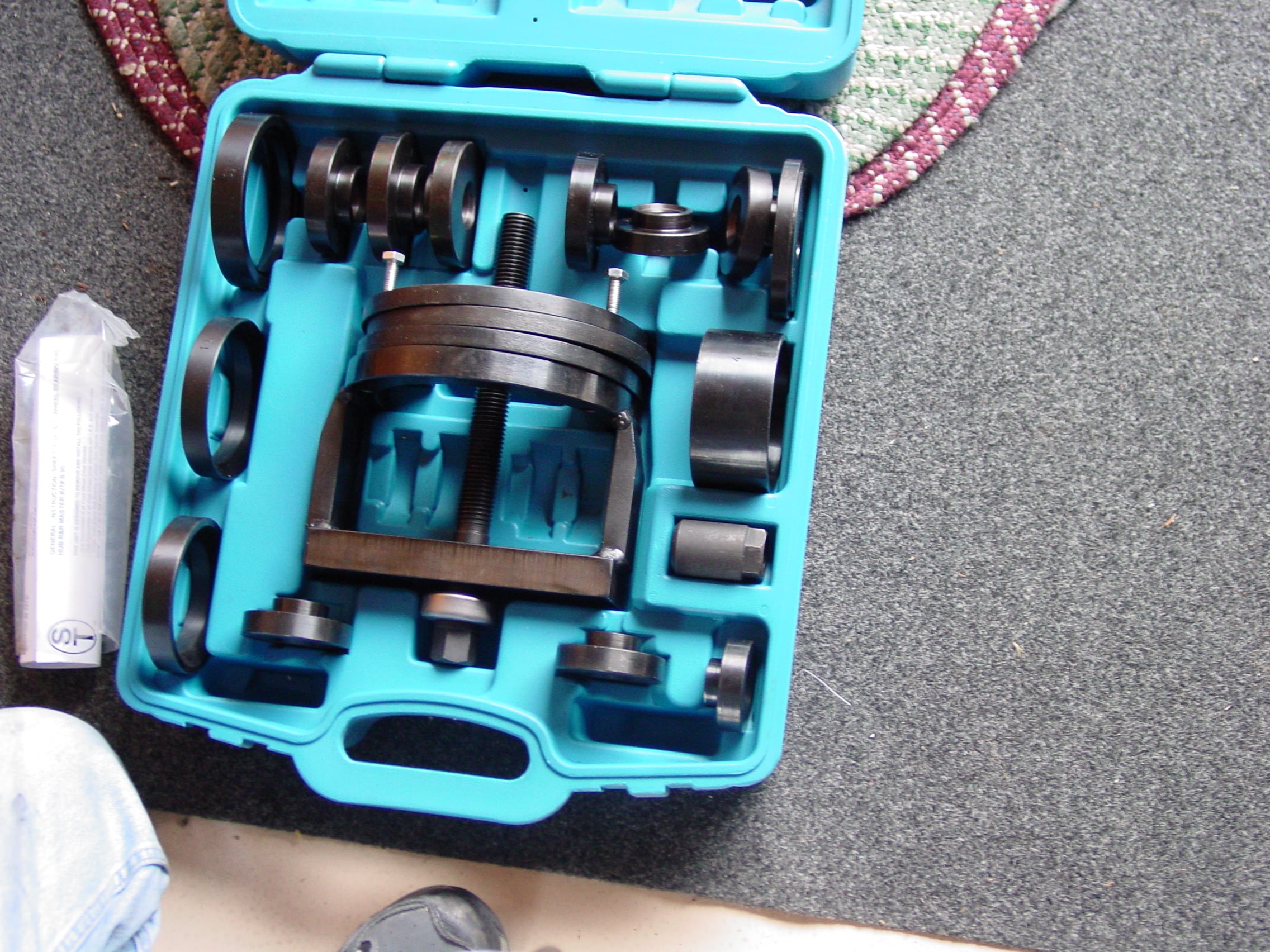

I'll share that I did manage to booger a rear wheel bearing on a clinic car, by forgetting to install the parking brake backing plate before starting the hub onto the stub shaft. Don't make that mistake I did, and save the cost of a bearing and in my case, a couple days before I could get a replacement.
Blue-gloves picture shows that backing plate, and my double-top-secret trick to using a nutdriver to manage the retainer pins. I figured out that I can assemble the whole parking brake assembly before putting the hub back in, avoid the mistake completely, and have much better and easier access for getting all the fiddly bits assembled correctly.
I bought one of the Sir Tools sets, and it made the project a lot easier. The cost of buying the tool then was about the same as a local shop quoted for the work. I added it to the collection, and in the first year we had three clinics of three cars each for the service, so easy payback.
This was ~~20 years ago now, when we lived in a little bungalow on a bluff over Los Angeles. Still have the tools. If you are in the central Oregon area, bring your parts and come use the tools.

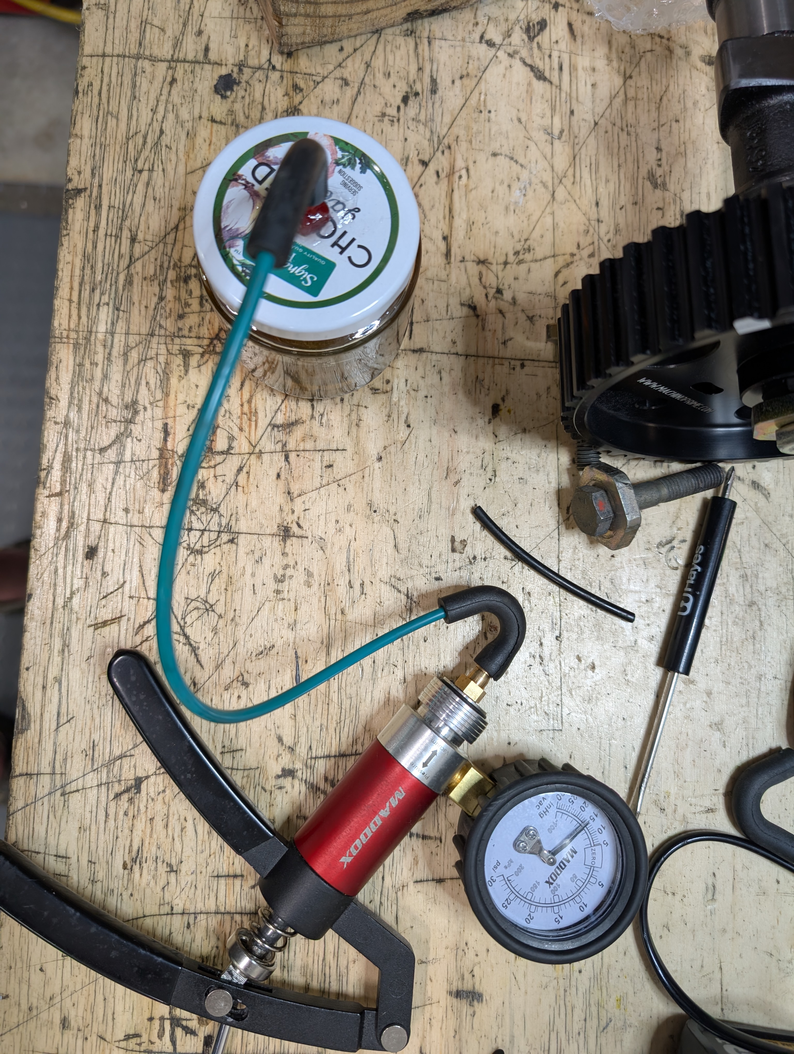

I came up with this years ago, after concluding that soaking didn't do much.... This was before all the cool kids were doing it, which is why this video has all the quality of a Bigfoot reel.....

:clap: :clap: I love the creative magic! I was thinking I could put them in a bag of oil in the ultrasonic cleaner, and let the vibrations do the hard work. The vacuum is much quicker-easier-cleaner! :clap: :clap:

Tom, I will need to find a jar and parts to create this. Love the idea. Can I squeeze the oil in and still let them soak or just do before I install?

That's actually a MityVac vacuum pump. So you are more sucking the air out of the lifter than forcing the oil in. I just drilled a hole in the lid and put a barb fitting in with a little RTV. Importantly, that's a Claussen quarter-spear dill pickle jar -- because they are noticeably fresher and tastier than pickles stored at room temp. :angel: Letting them soak really doesn't do anything -- other than make them harder to handle -- unless you let them sit all year and hope changes in temp and barometric pressure will eek out a few bubbles over a long period of time. I just put them in the jar and keep pumping until I can't get any more bubbles out. Helps to flip them around a few times while pumping to make sure the air has a good exit path.

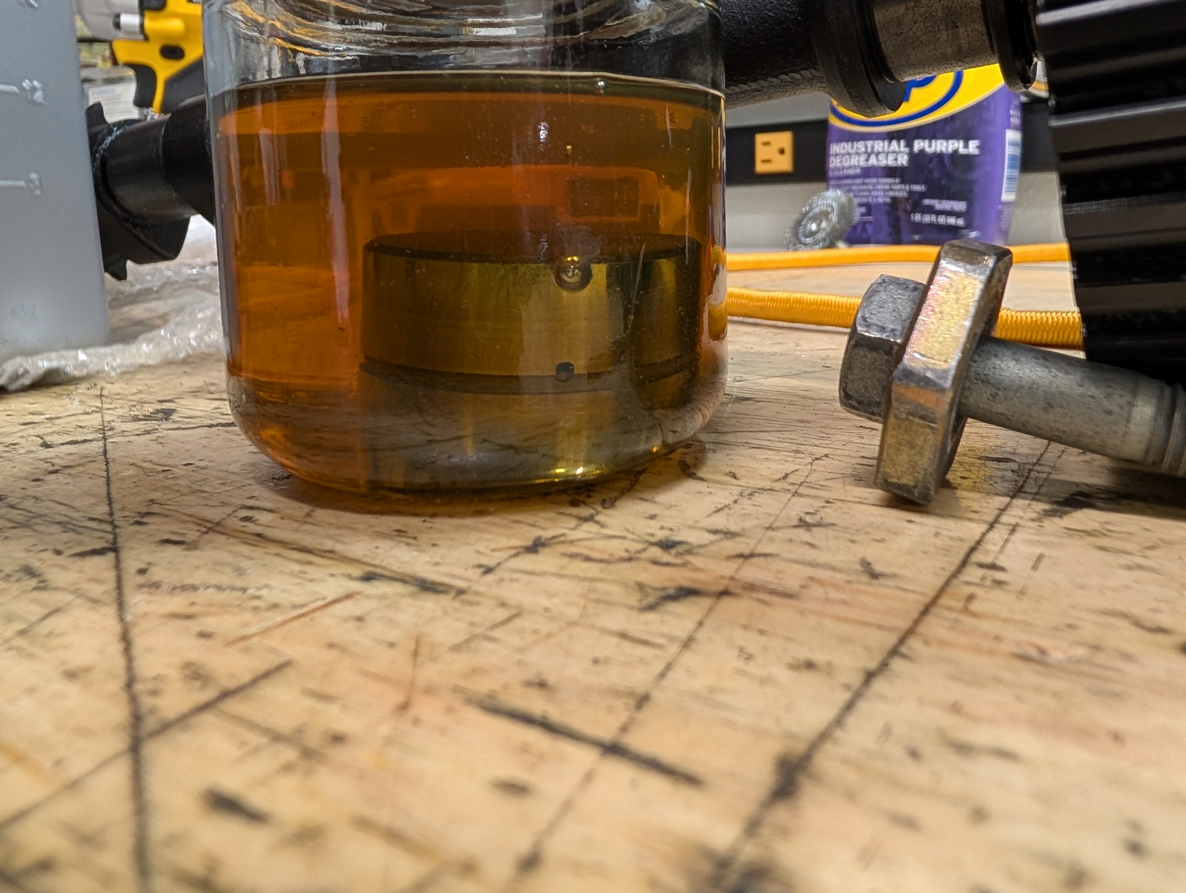

Here is my rendition of great idea!
Couldn't upload video to large but here a couple of photos. I'm ready for them to come in.

Nice, you're all set. For videos, it's best to upload them on YouTube and just post the link here. They embed and play right in the thread like mine above.

ummmm... Move that caustic Zep Industrial Degreaser bottle out to the shed, away from anything aluminum like Your Car. It's great for iron engines, only suitable for aluminum if you can limit exposure time to minutes, and completely rinse and neutralize it immediately. It darkens aluminum as it hydrolyzes the surface, a problem that continues once started. Not Good! Read the label carefully and completely, including the part where it warns against use on aluminum. It means it.
Back to your regularly scheduled browsing. ;)
