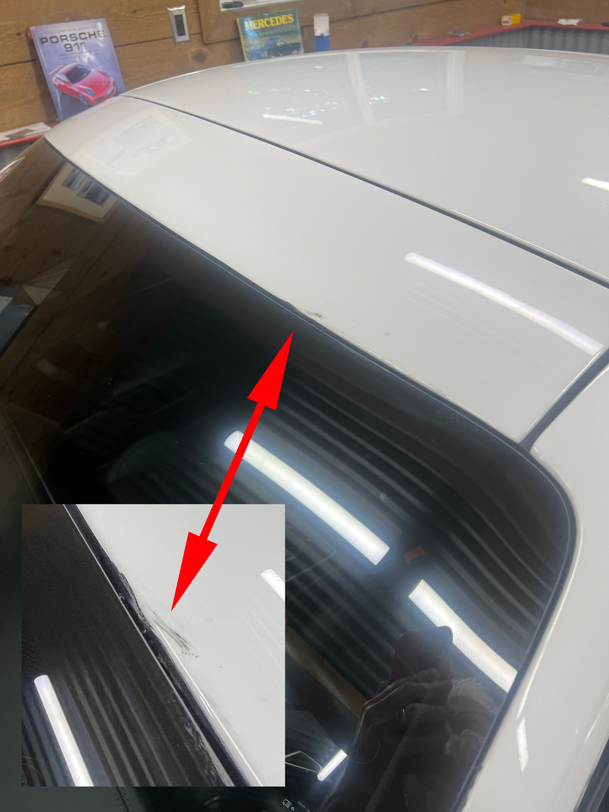

Anyone else notice the windshield sealant (butyl I assume) is soft and gooey on their 992 or other modern Porsche? I noticed it while washing the window -- it's all sticky and gets all messy if you rub it. Did mine get compromised somehow or is this normal? Any known solutions?

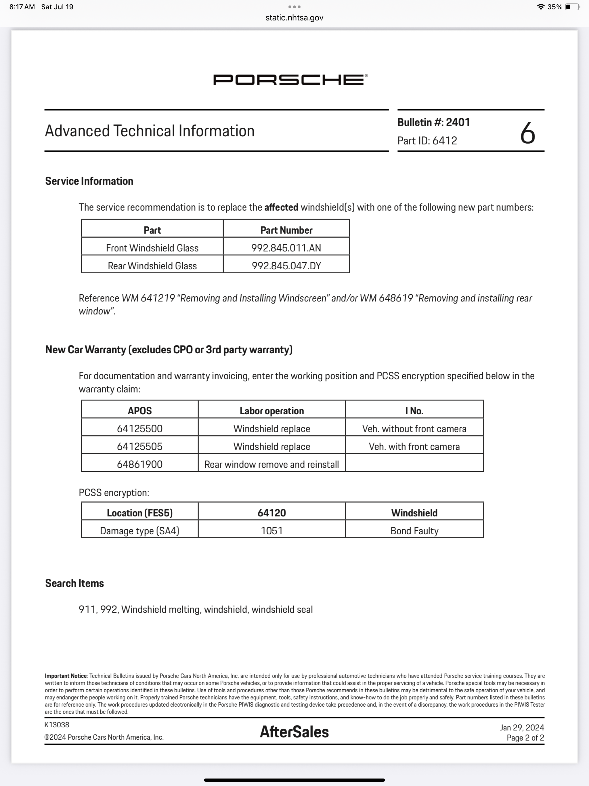

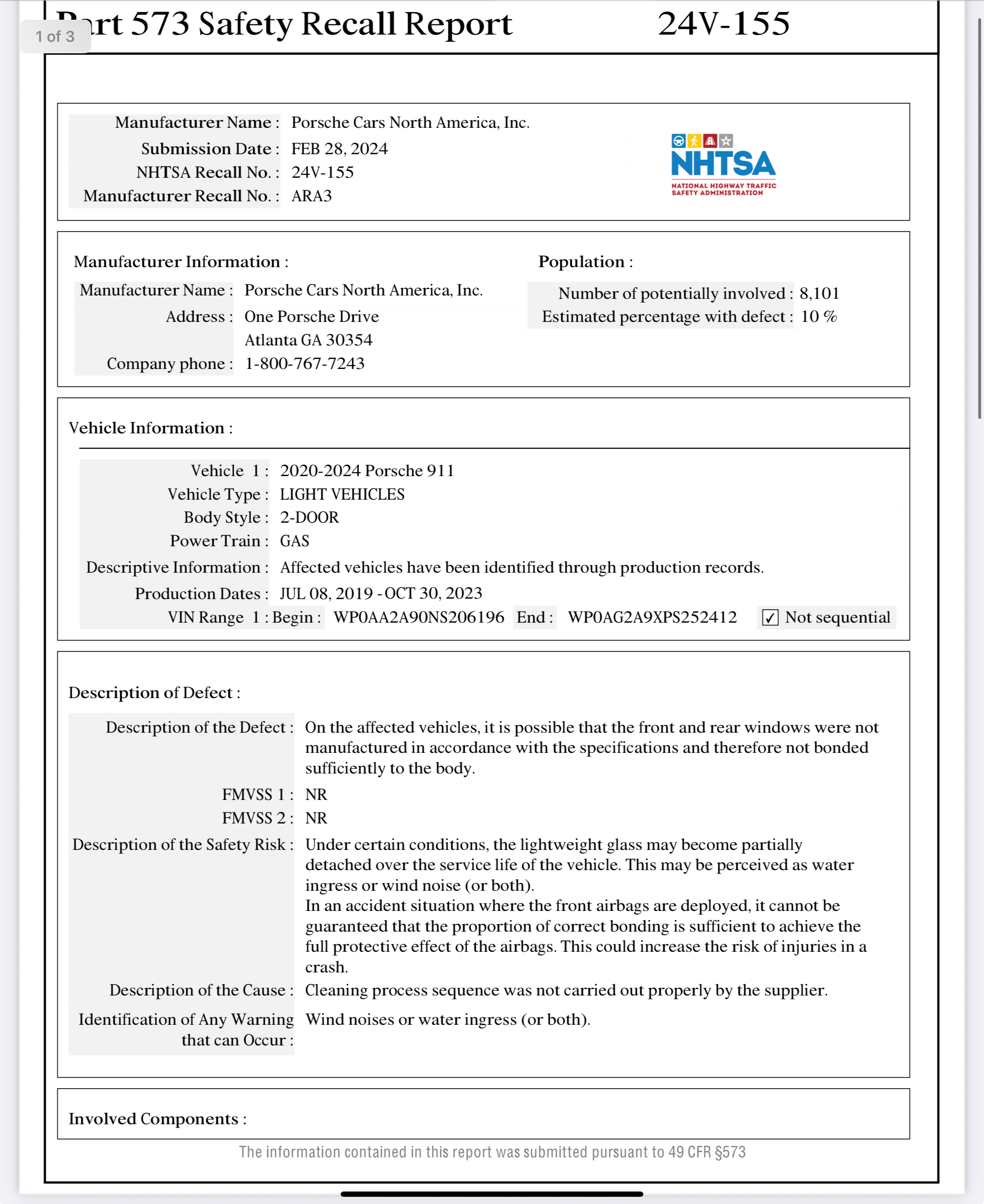

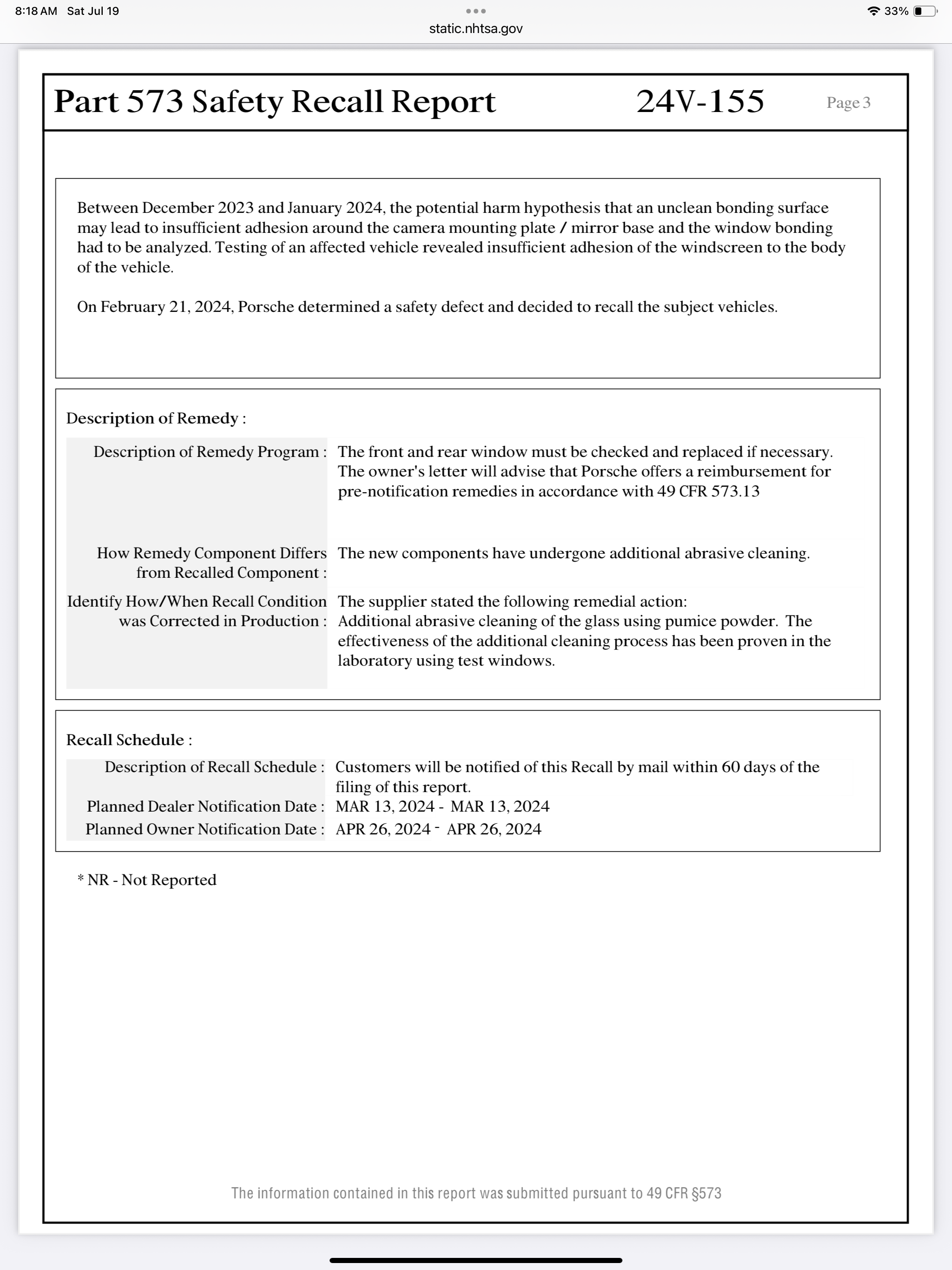

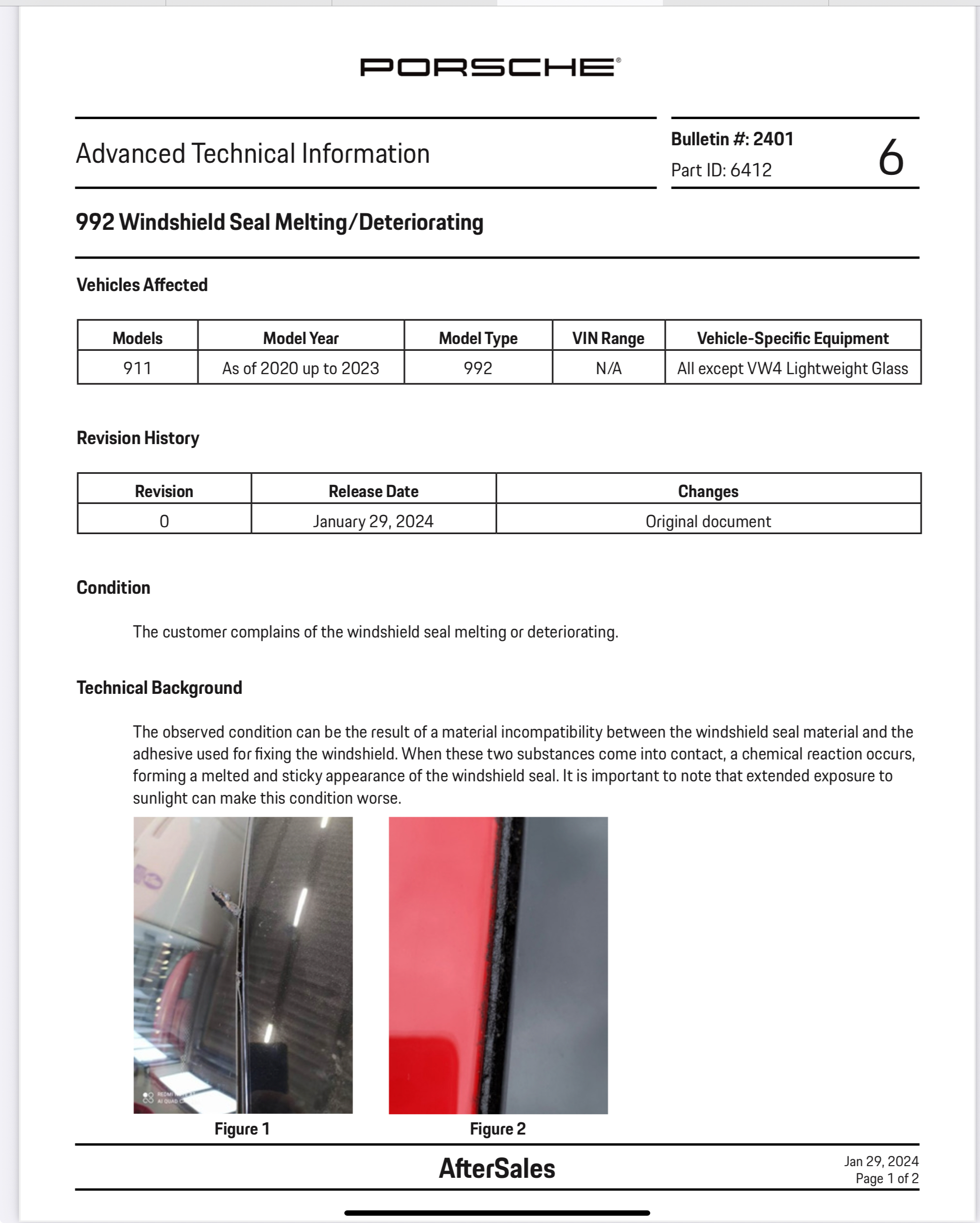

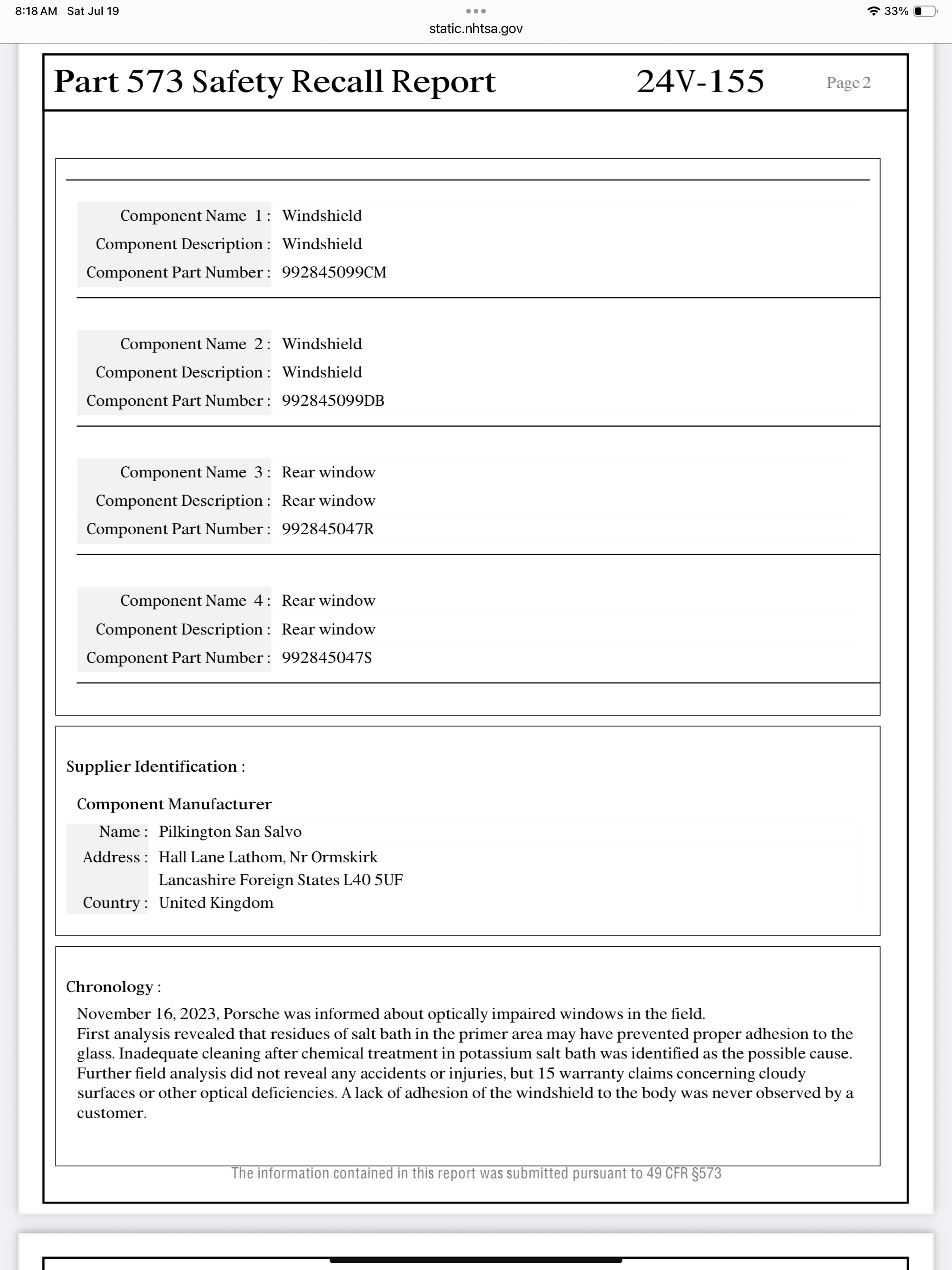

Just an update: had the windshield replaced this week by the dealer. The old one had 8k miles on it and seemed new to me without any pits, etc., so I was surprised the new one seems clearer. Imagination maybe, but I don't think so. Porsche paid for the whole thing. I've since researched a bit and discovered it is an NHTSA recall, with Porsche's advisory describing my exact symptoms. The NHTSA literature also says the windshields can be optically impaired (not sure how?) so maybe this one really is clearer... I'm guessing it's something they only fix when symptoms appear, as I never got a recall notice and the dealer never took it upon themselves to fix it (like they did the airbag sensor that was also under recall). So, check your windshield seals! I need to check the rear now too...
