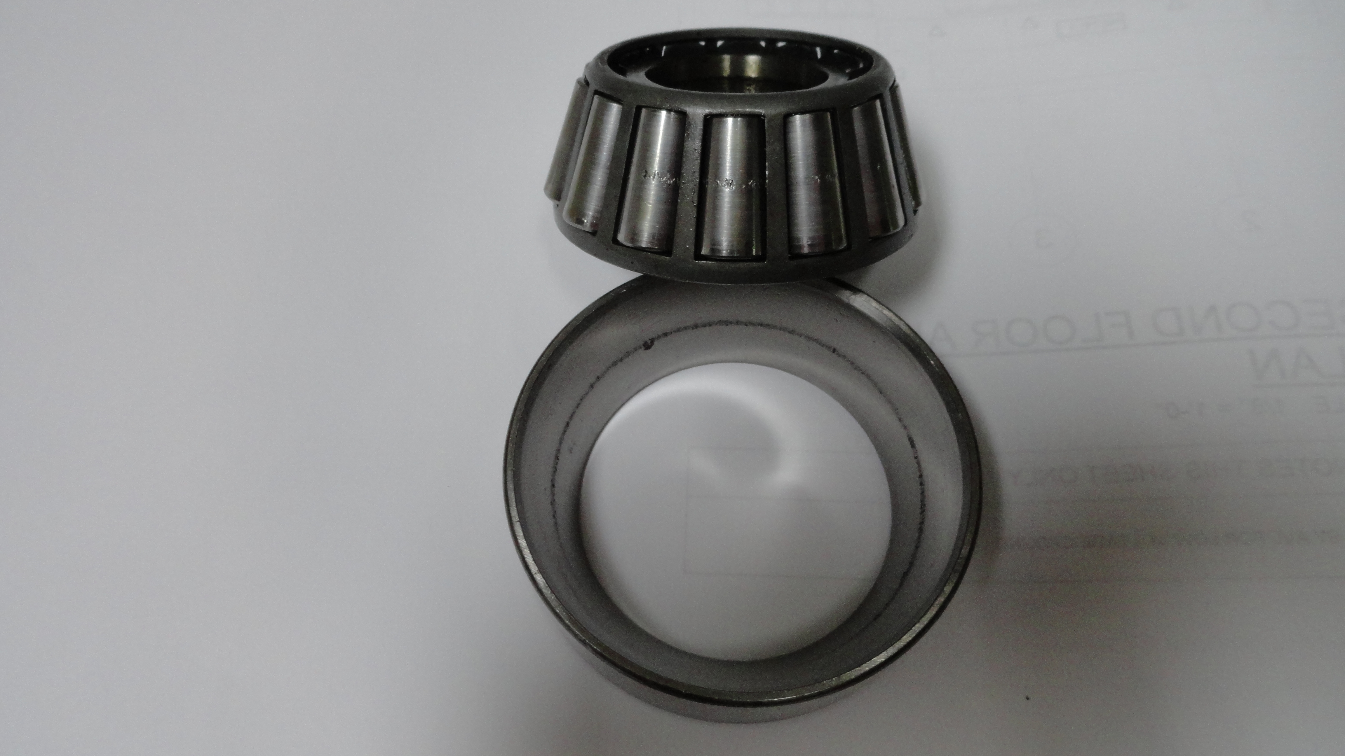

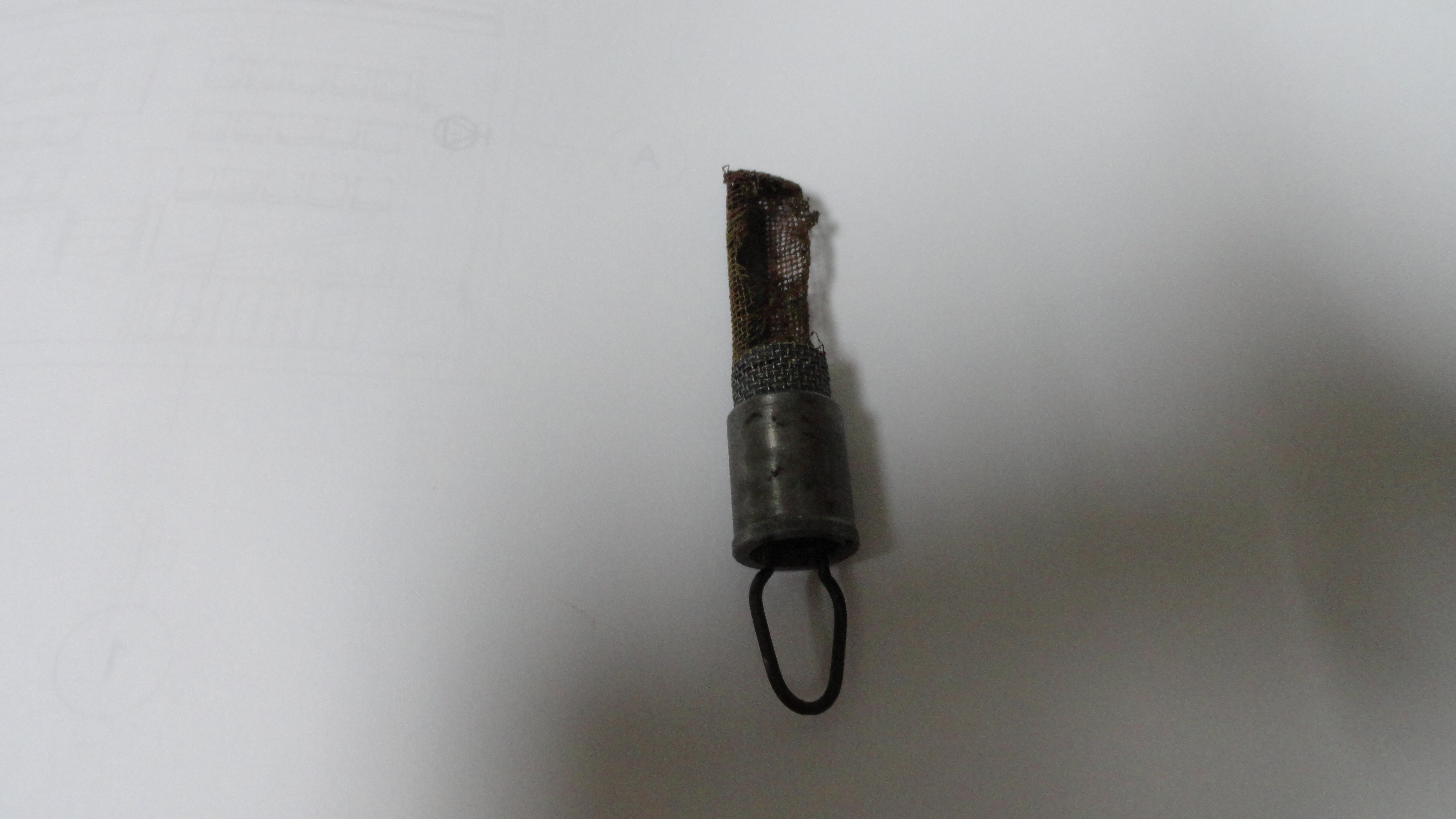

Not sure if I got lucky or not, but my transmission was leaking between the cases and since it was out during a clutch job, I sent it to be resealed. That turned into a rebuild. The screen was half gone and took the pinion bearing with it. No other damage was discovered. Just delays waiting on parts from Germany. Fortunately, the bearing and screen are still available, unlike lots of other parts in the gearbox. Second gear? - Nope! Pinion bearing #27 016 311 220L? No! The Chinese crap from PCG may be, but when is Porsche going to go back to making quality parts over profits?
If you have a transmission with the oil pump, consider this a PSA. Buy the pump cover gasket, some gear lube and check your screen!

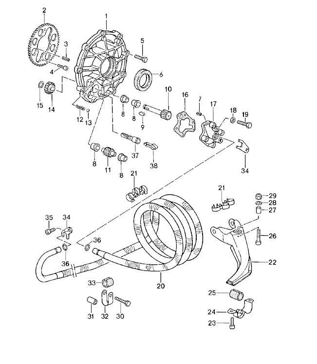

Item # 17 on the PET diagram.
Trans side case picture.JPG (65.81 KiB) Viewed 193 times

The screen that failed is #37

I used factory synchronizers and pinion bearing. Fortunately we caught it early. It makes sense that the pinion bearing failed first as it located adjacent to the cooling loop return line.
Funny thing is the transmission was quiet. It did have 200k miles on the screen.

Cruise98 wrote: Fri Jun 20, 2025 8:50 am The screen that failed is #37
Thanks, the gasket you mentioned is #16 then?

Yes. Use some 574 or something similar on it.
