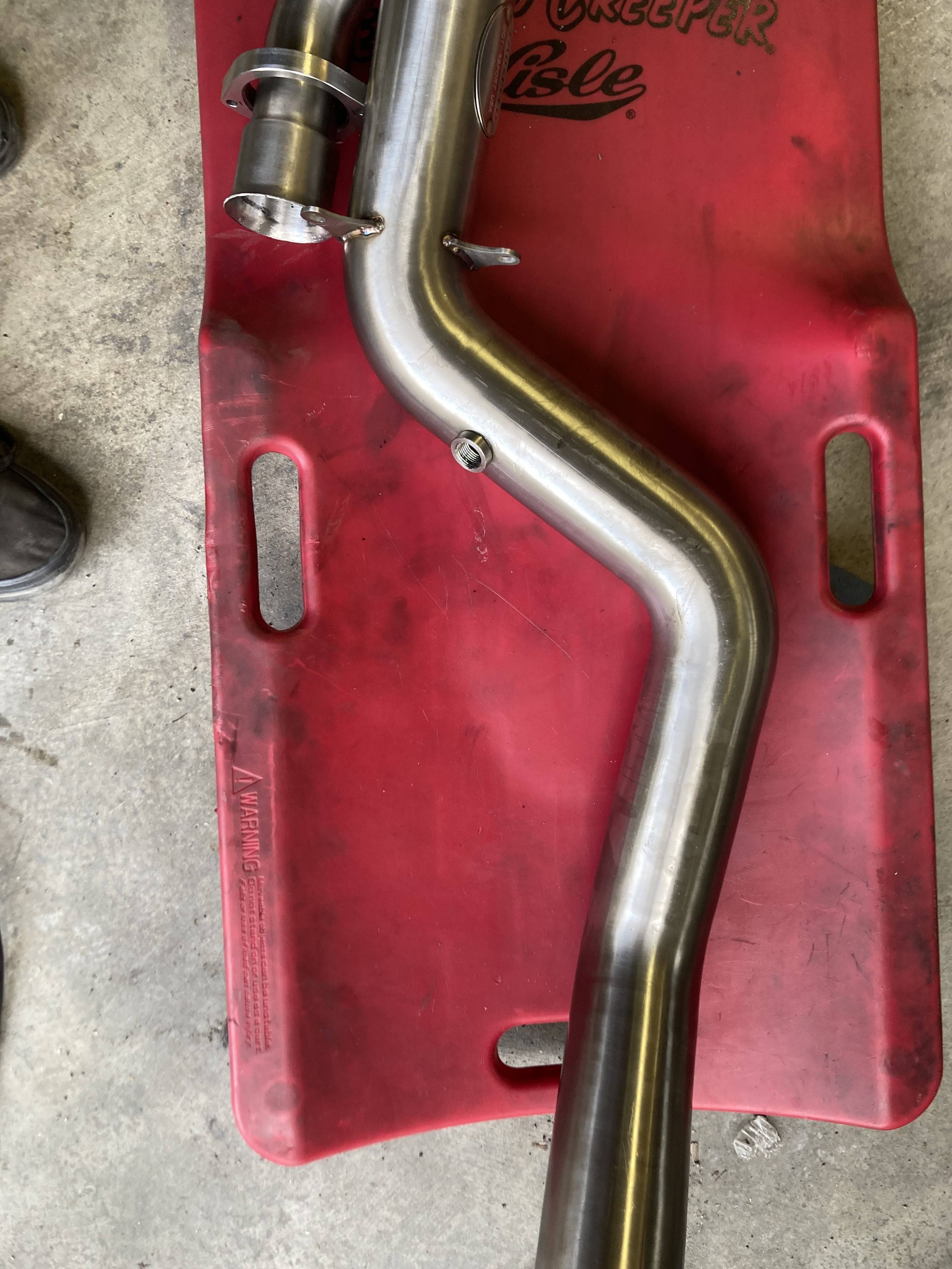

Absolutely relocate! The stock location is in the crossover, and wideband sensors are sensitive to pressure - you can correct for it, but you need to also be tracking crossover pressure to do so.
I think most folks stick it down on the bend before the wastegate tie-in. Here's mine, pre-welding:

Agreed -- most people put it where four0four shows above. You also don't really want to give up the factory sensor. It serves a different and worthy function.
