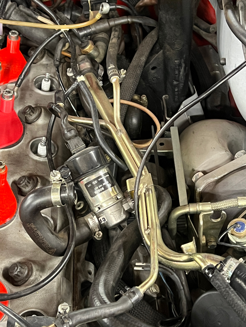

Nice kit, I hadn't seen that. I have lots of pictures, just need to dig them out. Does this one help?

The 3-pipe manifold varied a little bit among the 951 years, but they all have one that looks basically the same. Do you not? Maybe post a pic so we can see what you're up against?

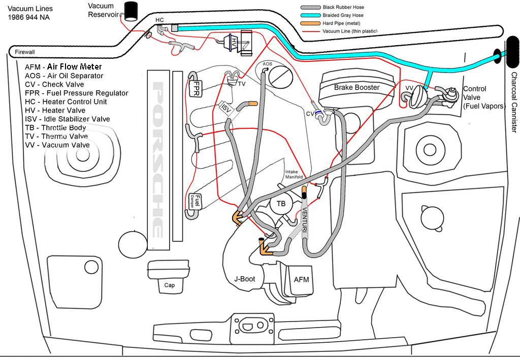

Reference Post," My new 944 and it's issues. Page 5 Vacuum line routing diagram

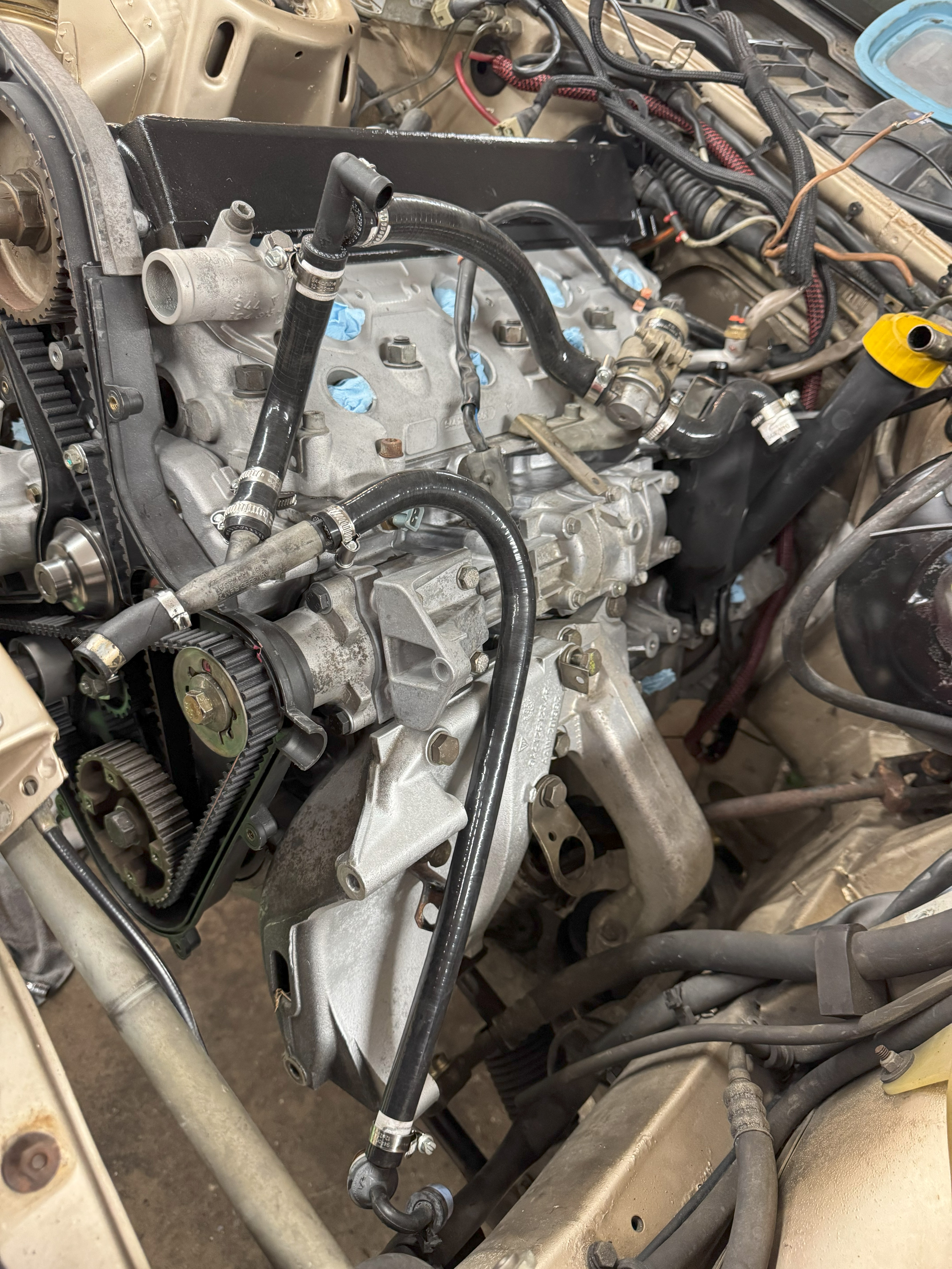

Here is a pic. I know the long tube ends up at the booster with the check valve but my configuration of it is a mess. Lol

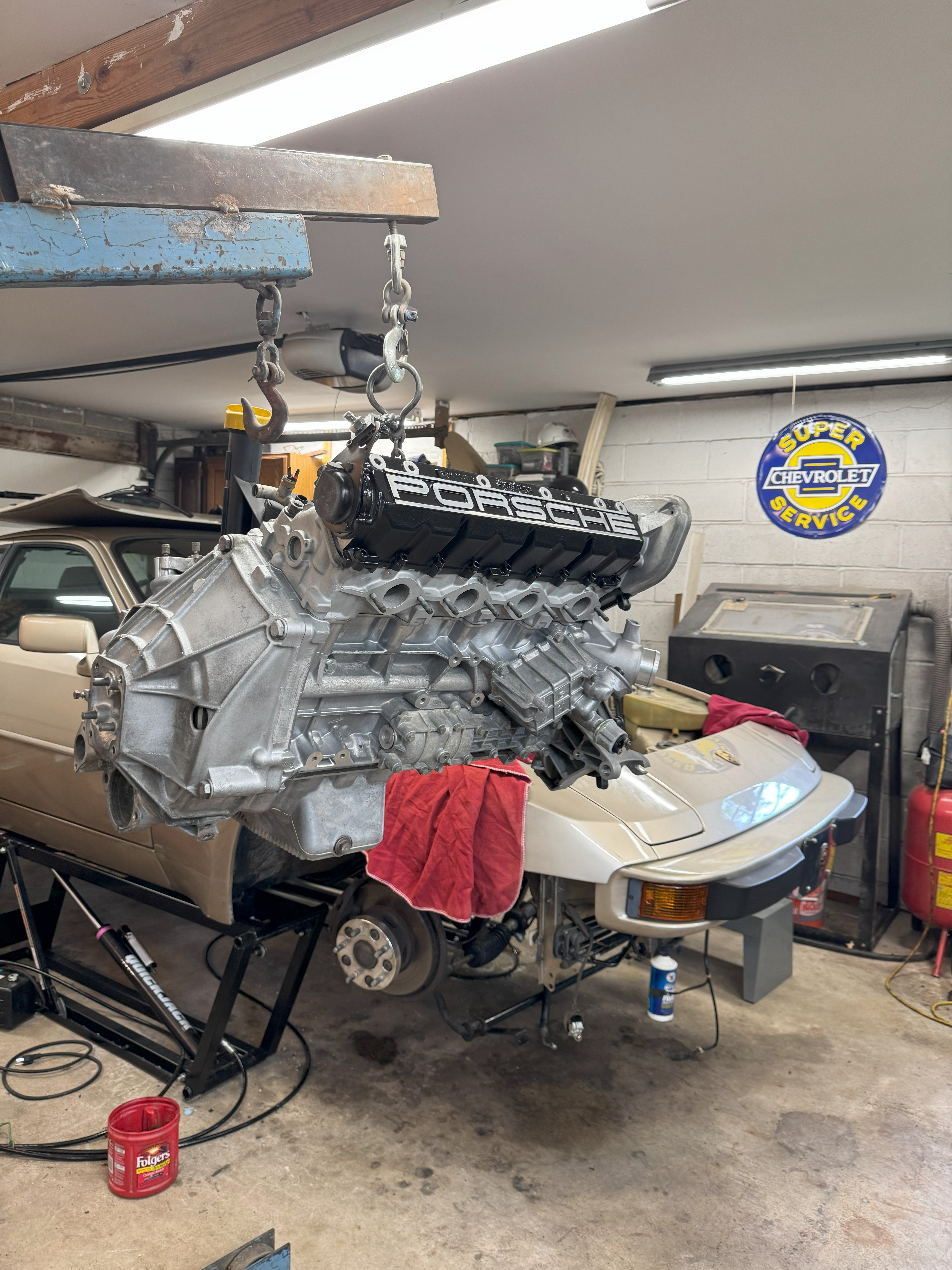

Just for fun this was yesterday Lol

Oh, my bad, I was thinking turbo. Here's the diagram Stoneguy mentioned....
