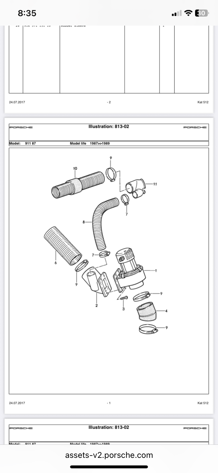

I recently bought an 87 Carrera cab. I am not getting fresh air thru the vents and discovered the air hoses under the dash on both sides are disconnected and damaged. Does anyone know how to replace the hoses that go up inside the dash area without removing the entire dashboard?

Can you post a picture of the hose ?
Or point it out from this diagram.

It is number 6 in the attached diagram

naustevenn wrote: Wed May 21, 2025 2:57 pm It is number 6 in the attached diagram
You may need to remove the cover in the trunk to access the top section of the hose. Should not be a big deal.
