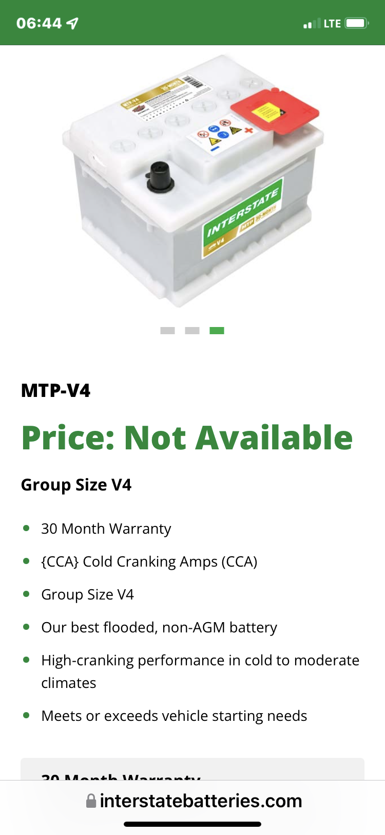

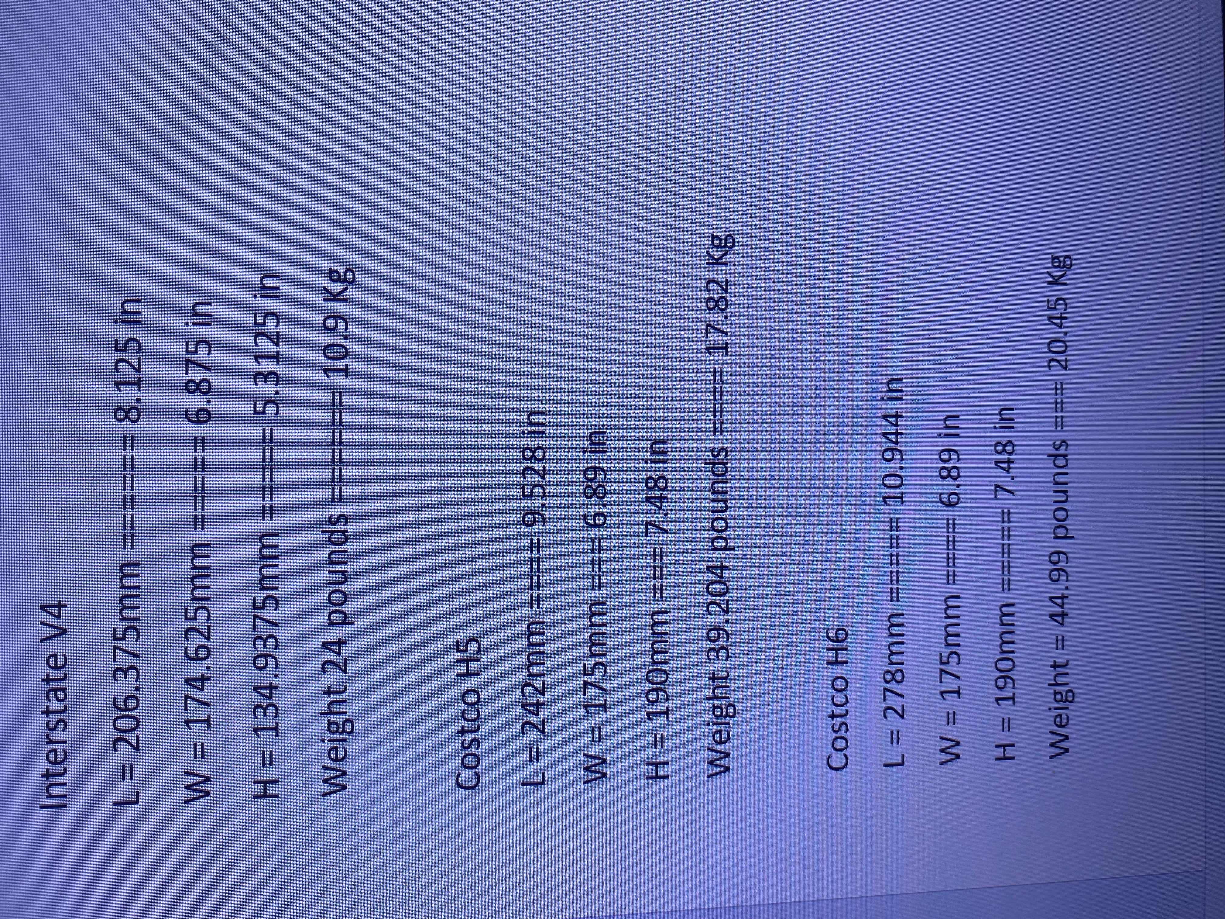

Battery size difference if anyone is interested
V4 battery idea from this car thread
https://grassrootsmotorsports.com/forum ... 90/page12/

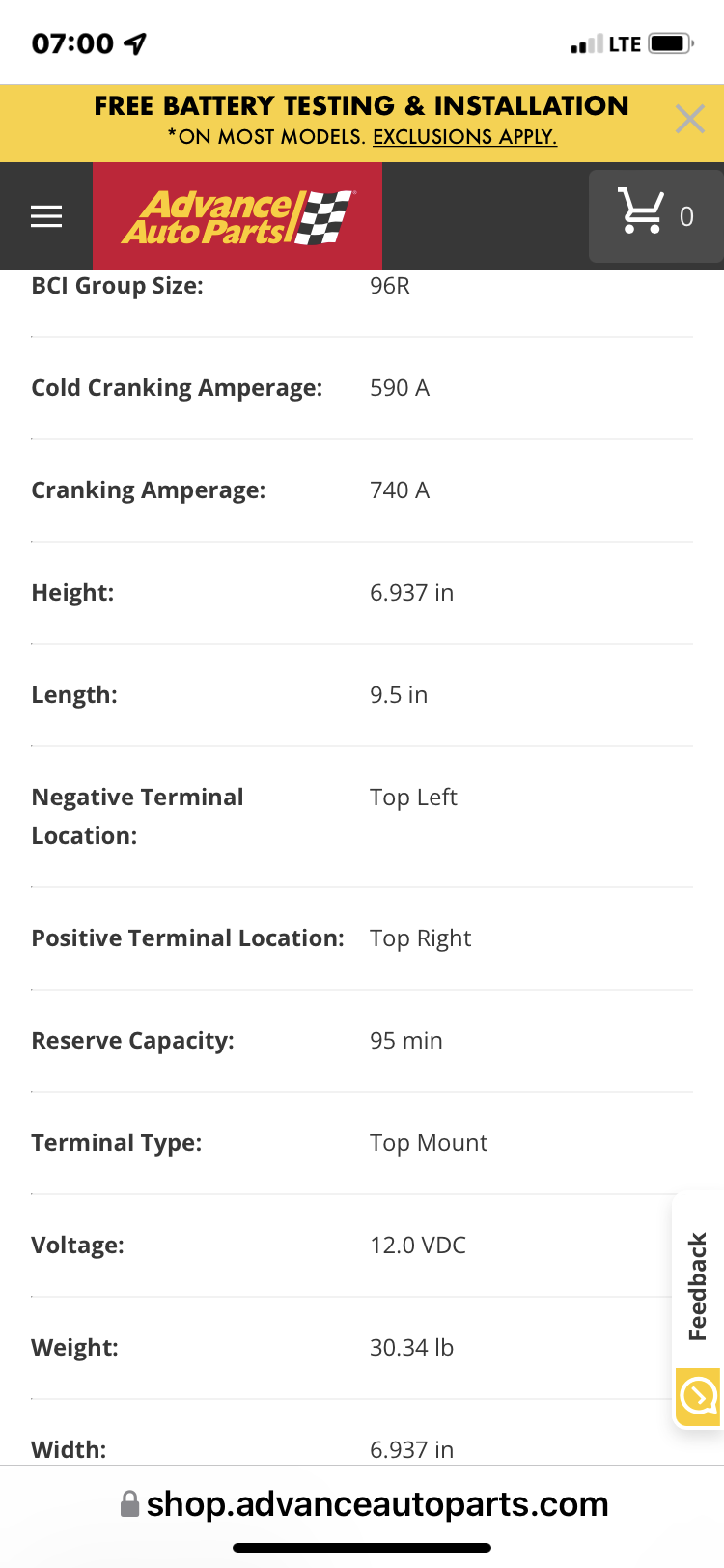

The DieHard AGM is a 96R I'm using also fits the factory mounts no problem and is a bit shorter for more clearance FWIW.
gruhsy
Posts: 517
Has thanked: 48 times
Been thanked: 81 times
AudiSport wrote: Mon Feb 07, 2022 5:55 am
gruhsy wrote: Mon Feb 07, 2022 5:49 am Battery size difference if anyone is interested
Here is a screenshot of the 96R I found
Comes in as second lightest if the specs from the site are correct for mode data👍
