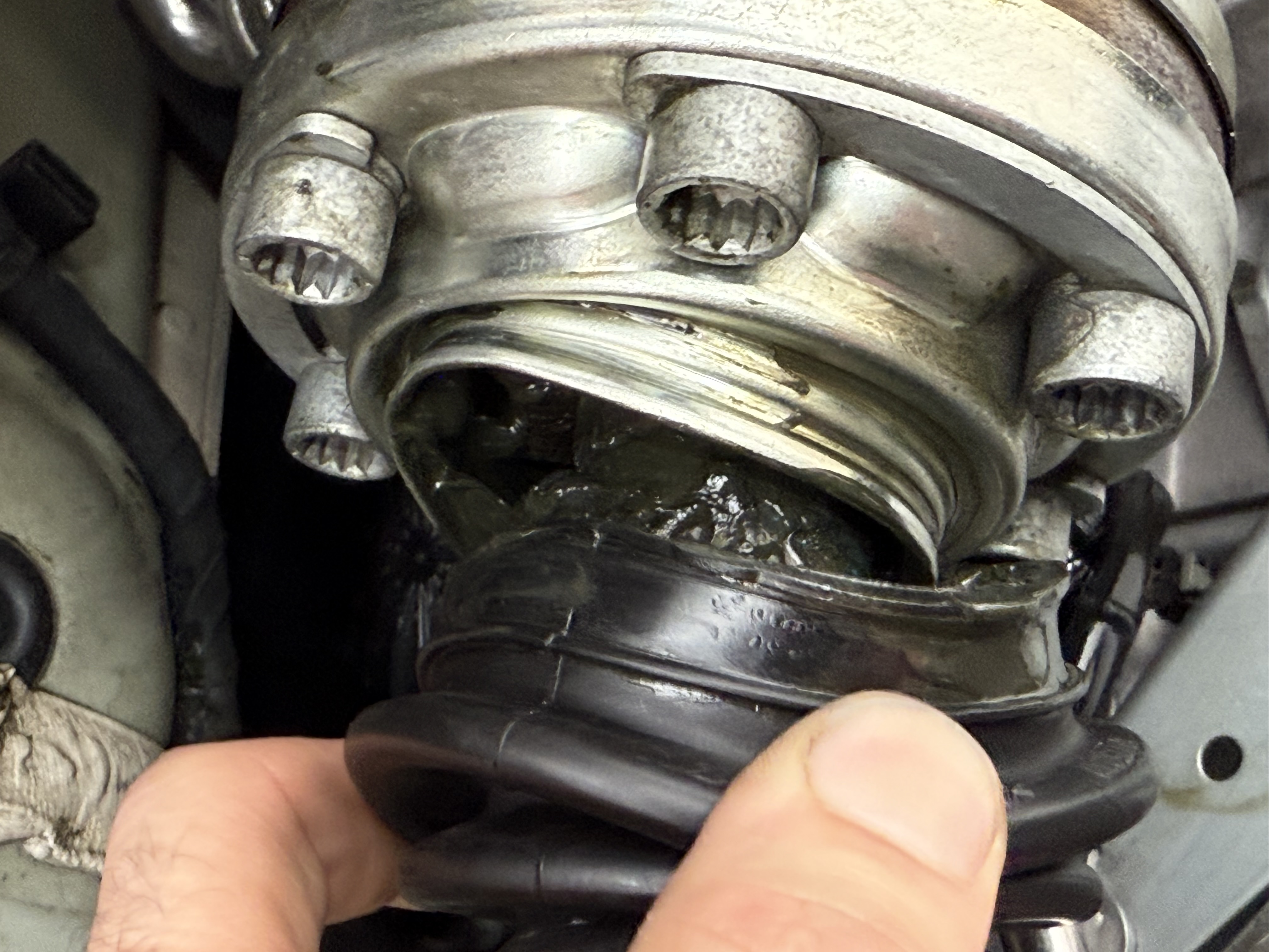

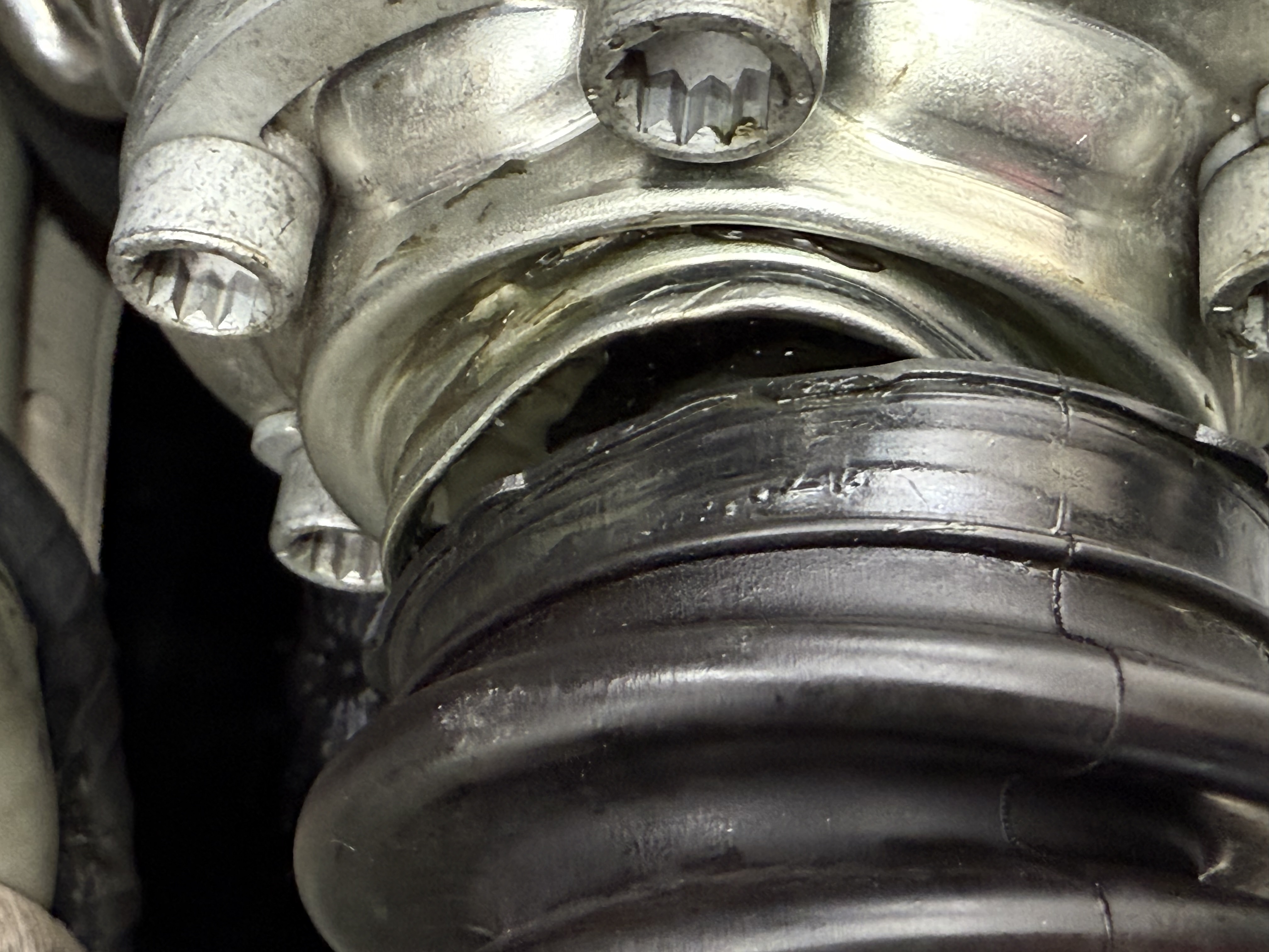

Decided to do my first oil change, roughly 3500 miles and one track day after I bought the car. The oil change itself was pretty unremarkable, but I found some damage to the CV cover. I tried to tighten the band just a bit as I'm planning on rebuilding both axles in the near future, and the inner band just came off. I then realized that the housing was bent pretty badly, see pics.
What would even cause this? I don't see any other damage under there.

As for the CV joint -- a rock or something must have gotten caught in there, no? Can't think of anything else likely to do that, unless it was installed that way....

Regarding CV boots, several of us have had heat issues as you know from previous posts that you responded to, but I have never seen a bent housing as in your picture. I cannot even think how something like that would happen. Maybe J-Dub will have some thoughts on this.

I think I might have figured out what caused the damage to the cap. I visited the servicing dealer after I bought the car and the SA told me the previous owner brought it in to have the factory PASM struts put back on after having an aftermarket suspension. I bet the tech moved the axle past where it should move and bent the cap. It’s a $7 part on its own and not very sturdy.

I have bent one of those inner CV caps, ran it dented like that for a year. Replaced it when I changed out all of the boots.
The inner cap and boot are available as an assembly. I could likely find the part numbers from my order history if you need them.

Thanks, I found the assembly and it’s on order. Called Porsche Chandler and the parts guy was listing all the parts individually and was coming up over $200 and I’m like can you check if it’s the same as the $80 kit. It was.
@J-Dub Curious as to how you bent yours? There is no other signs of damage on that side of the car.
