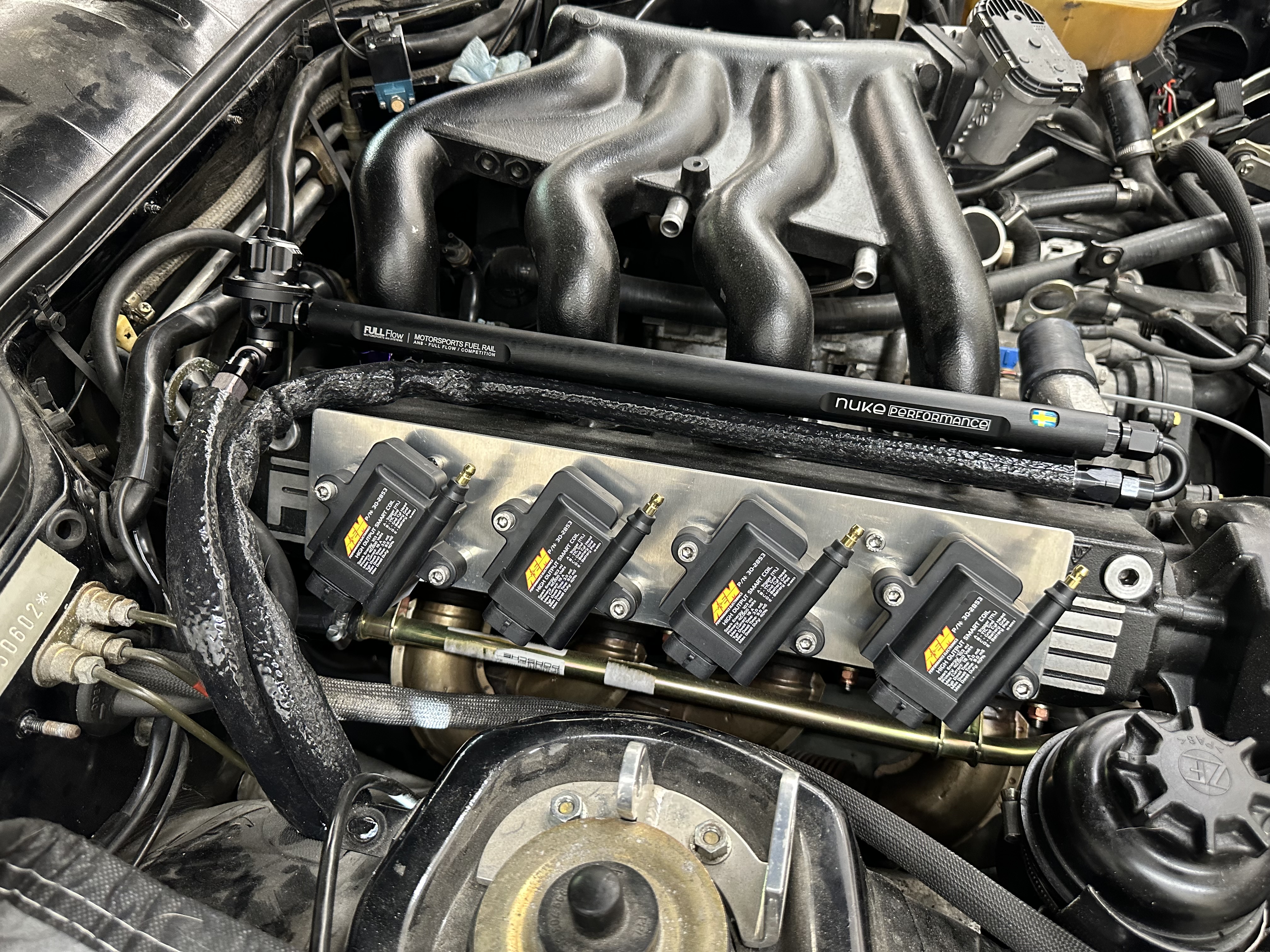

Bought all the parts from BAT and built my own

AudiSport wrote: Thu Apr 17, 2025 2:19 pm Bought all the parts from BAT and built my own
Nice FPR!
