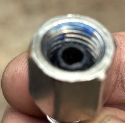

I'd also been having a problem with long cranking on startup and the fuel pump and check valve are brand new, so that was another symptom that pushed me towards wanting to check. I looked on Amazon and found that the kits are listed as having a 12x1.50 adapter so I figured I was good and pulled the trigger. Unfortunately it didn't exactly work. Tightened it down and got a reading a bit lower than was expected, but was accompanied by a steady drip, drip, drip from the fittings. I tried everything I could think of to get it to seal -- o-rings, cut up silicone tubing to serve as a washer, various sealants and still with the drip. Some people have had success with hose clamping some fuel line over the fitting, but a trip to AutoZone was uneventful as all they had was 1/4". I'd resigned myself to ordering up the parts to custom fabricate an adapter and waiting a week or so to get it done when I decided I had one more trick up my sleeve. The fitting really wants an internal flare on the female adapter so I decided to print one.
Screenshot at Jun 01 20-44-57.png (69.36 KiB) Viewed 1257 times
I figured I'd give PLA a shot first as proof of concept before I cracked open a fresh spool of TPU, but there was no need to go that far as after a test fit and a quick redesign it snugged up and was finally drip free. Unfortunately it really wasn't bleeding off any pressure and PSI at idle was still 30. I'd already pulled the FPR to see if I can figure out which one it was, definitely an aftermarket regulator (looks like WVE based on the markings) and already suspected someone had replaced with an 8V unit, which seems to be confirmed.
2025-06-01 20.53.32.jpg (91.08 KiB) Viewed 1257 times
I have a set of 4-hole Volvo 33lb injectors squirreled away for my planned microsquirt conversion that I could probably swap in and be ok (high z, so theoretically safe but not optimal). But, in the end I decided to just replace the FPR , so a correct pressure Delphi FPR should be on it's way tomorrow morning, so we'll see if that helps with my issue, but it seems like it can't hurt. Especially as the pressure bleeds down instantly after you shut the pump off, so if nothing else it'll hopefully help with my extended cranking on every start. Pretty happy I was able to find an $18 + pennies in PLA solution to checking my fuel pressure too.
