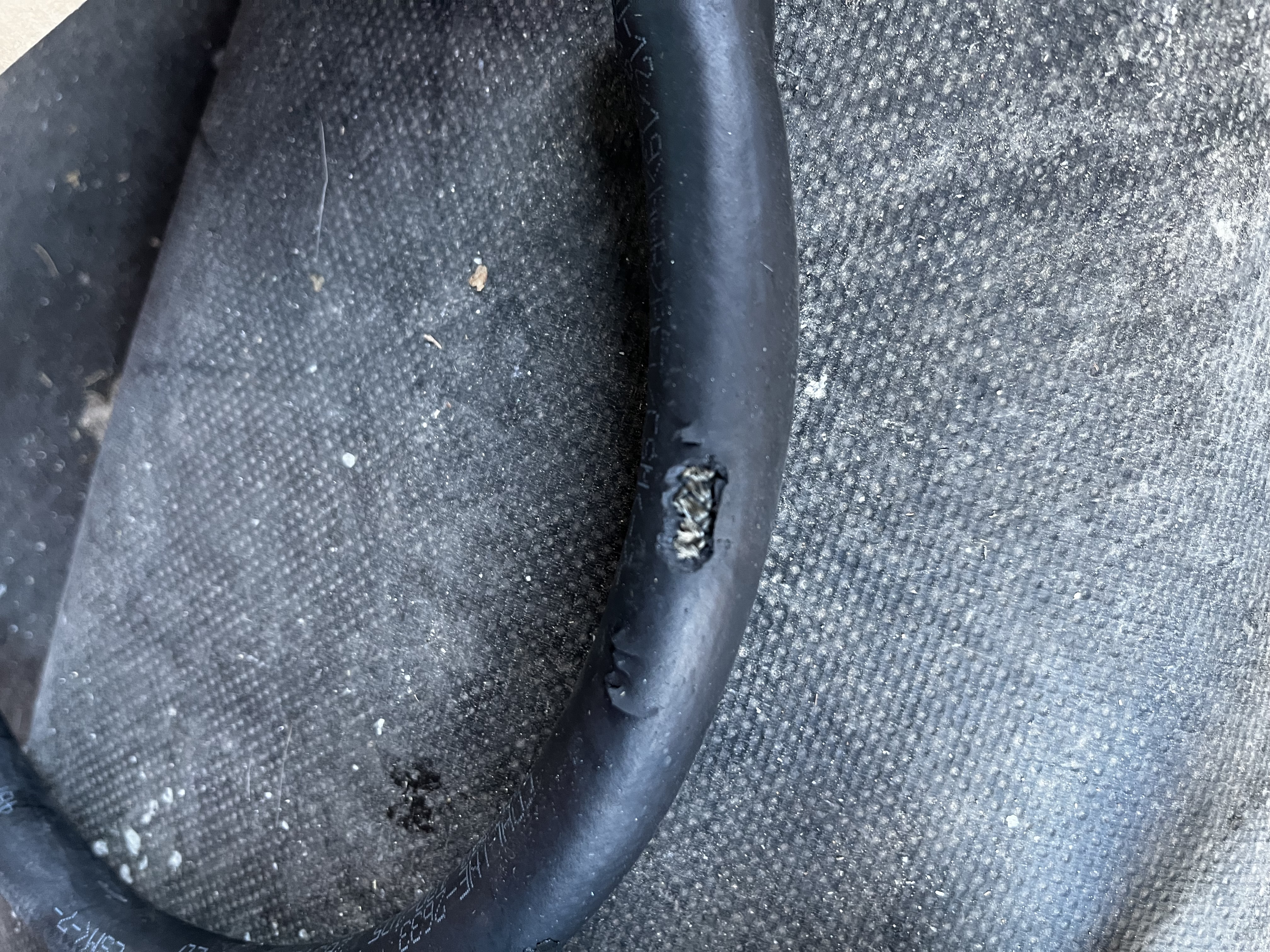

Well, in the critter's defense, it does look tasty. Squirrels have been doing that to the irrigation lines in my yard. Their behavior is rewarded by a refreshing drink of water when they're done. In your case, the critter must have had a much different experience when it got to the gasoline!Poorsche44 wrote: Sat Mar 01, 2025 7:20 am Well it turns out my issue wasn’t related to those crush washers fortunately! It looks like someone got hungry and decided fuel hose would be a good snack. IMG_6213.jpeg

I can't see enough of the hose markings to tell, but... Unless that's a low-pressure fuel return hose, all the real work is done by a polymer tube inside that armored shell. The outer layers offer abrasion resistance, some structural support to limit kinking, and apparently to limit teething damage. Unless and until that inner plastic tube is breached, leakage won't be a problem.
If it is a low-pressure return hose, the structural description is the same except the liner is not a hard plastic. It will fit safely on sharp-barbed fittings and requires clamps though.

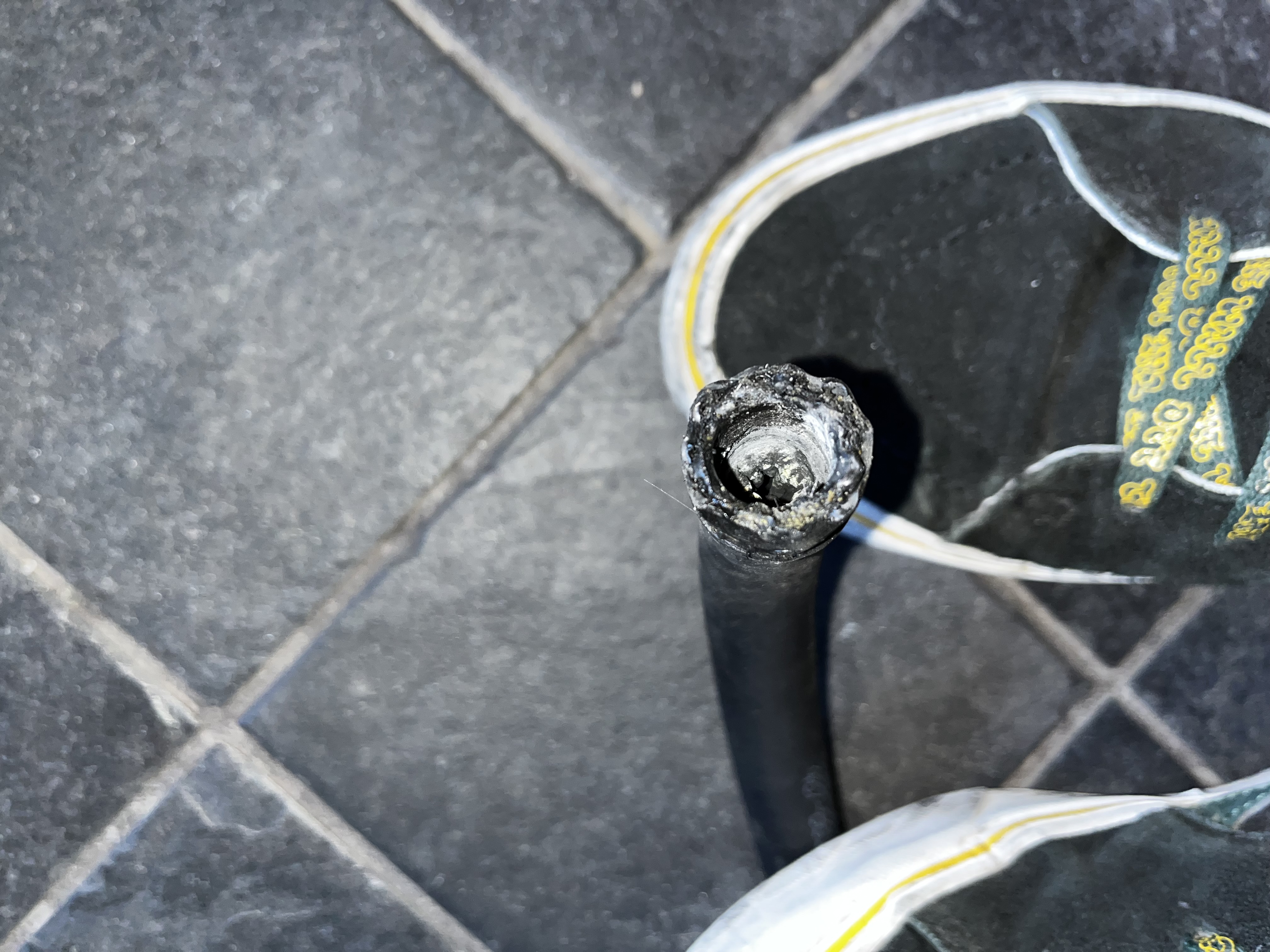

That’s all good to know Dr Bob! Digging up some research on the hose it appears to be Cohline 2633 high pressure hose, which I don’t believe is even fuel safe. Pretty sure this was replaced at some point by the PO, as it wasn’t the traditional fuel line with two different sized ends. The end that was connected to the fuel strainer was pretty damaged internally too.
