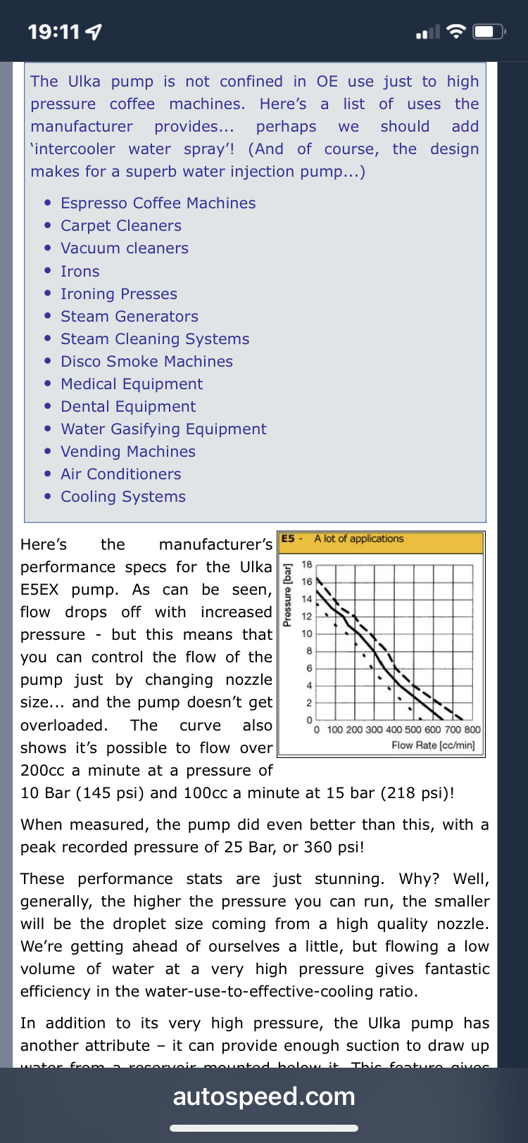

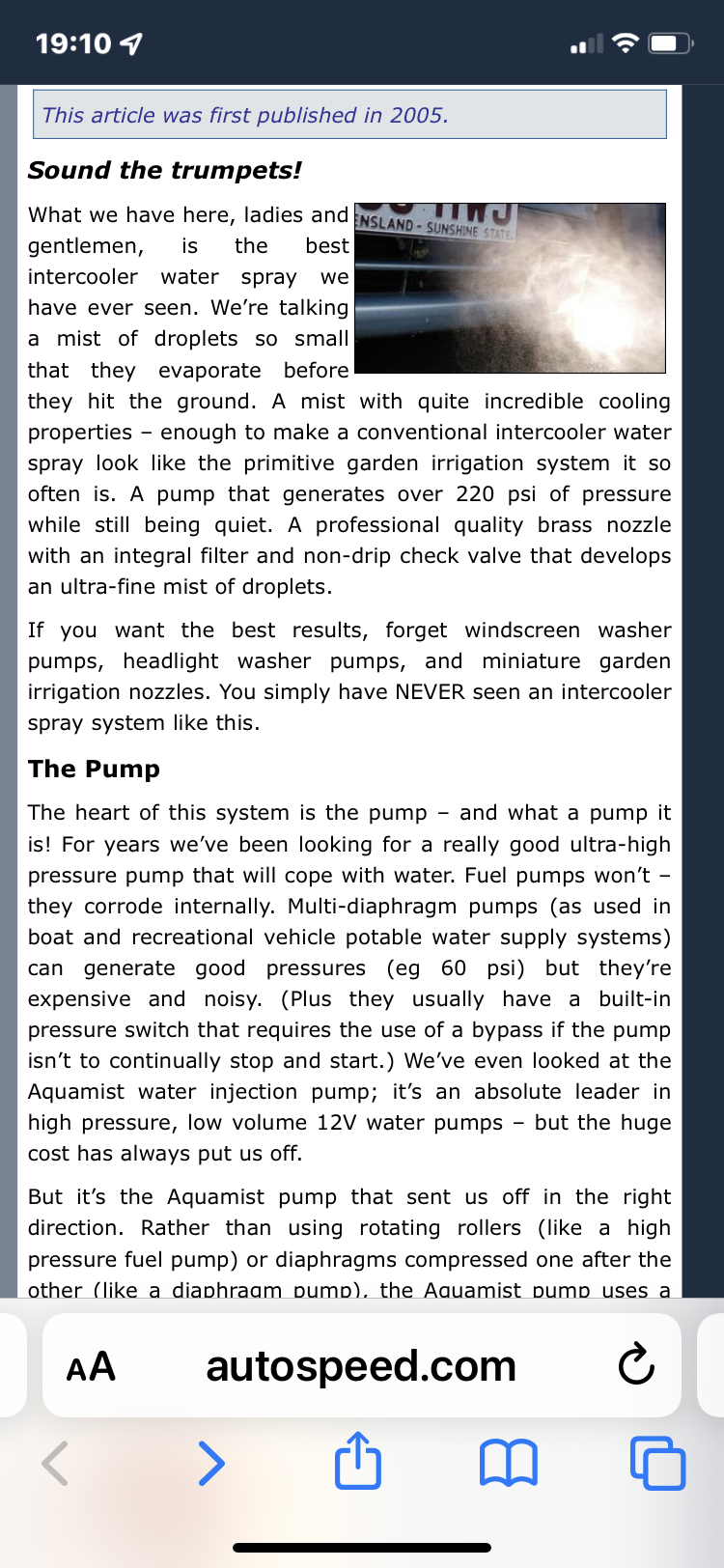

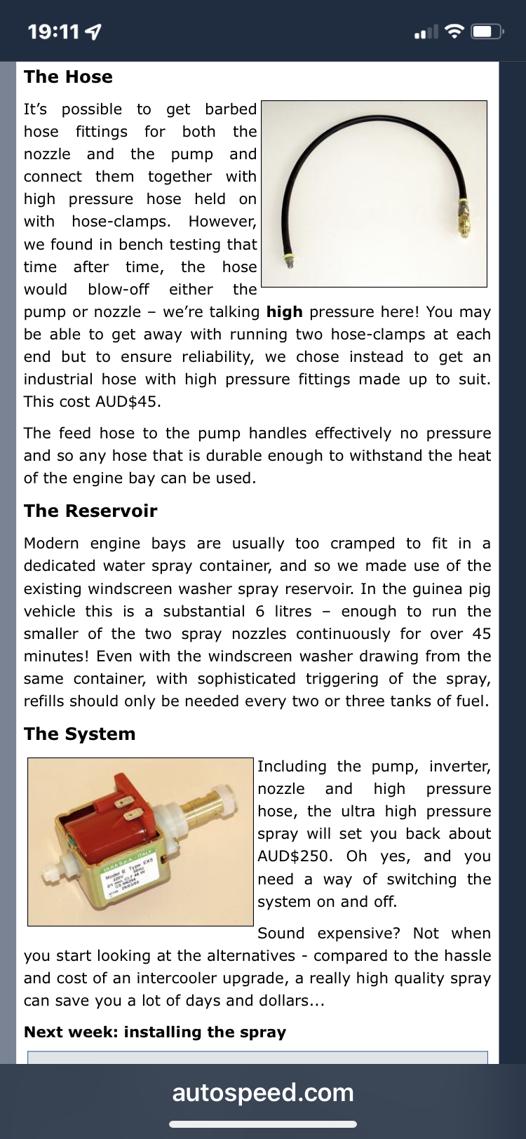

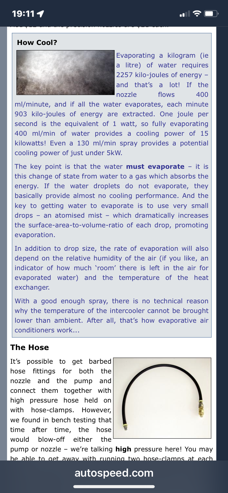

I stumbled on an article about intercooler sprayers.
If you make yourself an intercooler sprayer use an expresso machine pump
They can reach 300psi and make microscopic size water droplets which means more efficient latent heat of evaporation to remove heat.

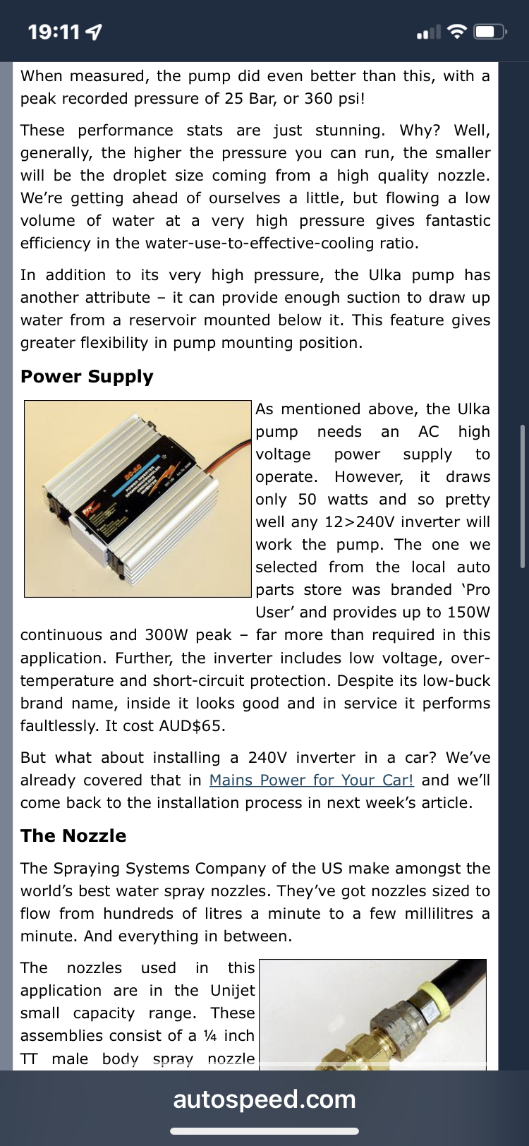

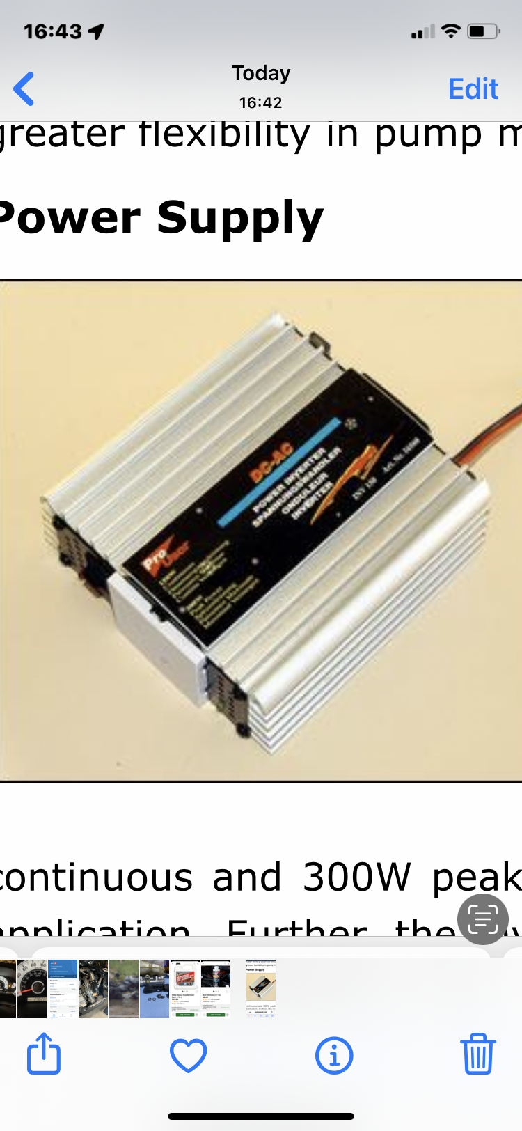

But that says it's 120V, it's not going to perform the same at 12V.
gruhsy
Posts: 534
Has thanked: 48 times
Been thanked: 83 times
It does when you add an inverter AC/DC
AudiSport wrote: Tue Jan 25, 2022 1:37 pm But that says it's 120V, it's not going to perform the same at 12V.

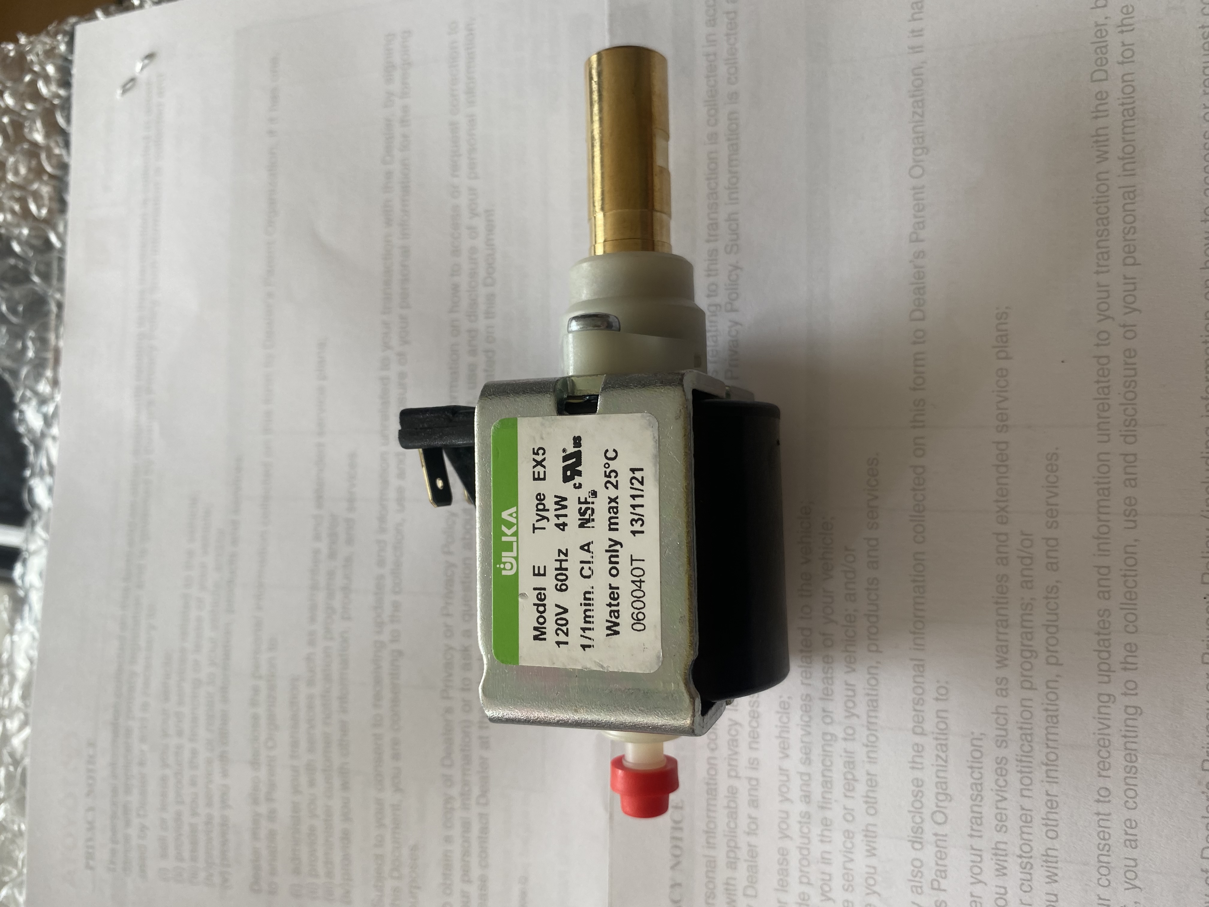

Here is one model

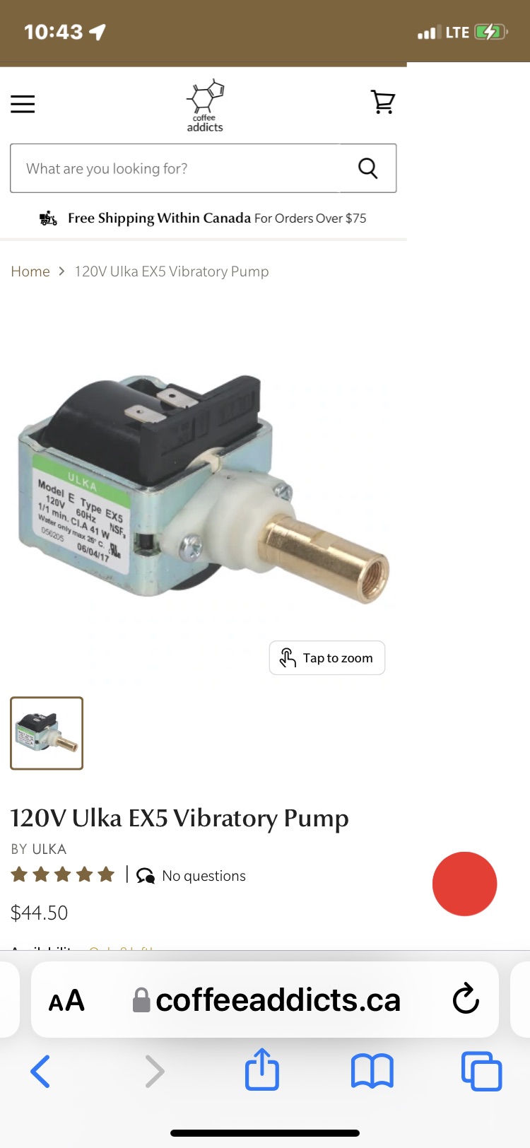

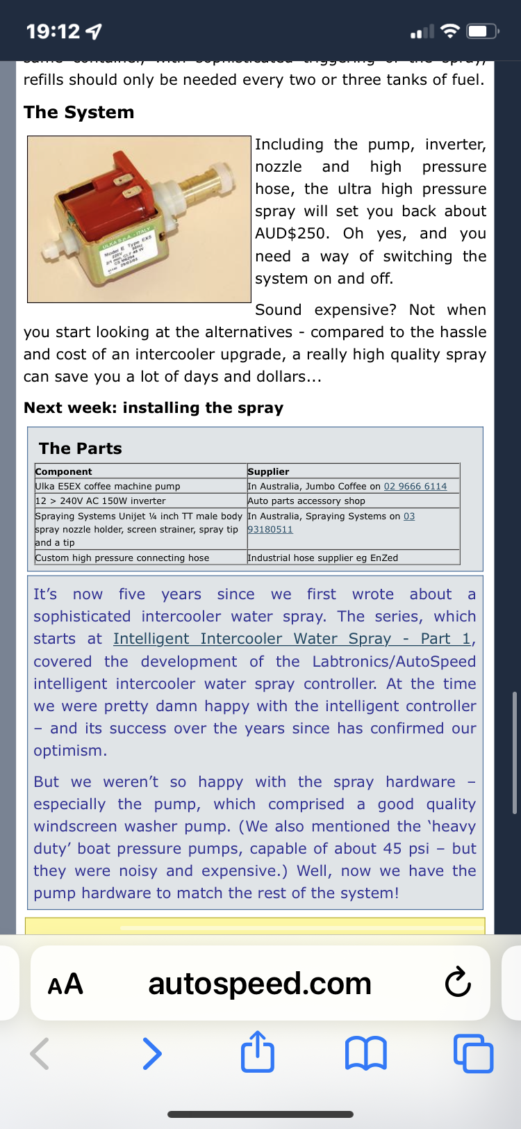

More of tech details can be found on this link
The best fact about these pumps are how small the droplet of water are.
44.50$ Canadian for the pumps local to me.
These Italian pump are found in tons of appliances according to the read
They have a few fun articles
https://www.autospeed.com/cms/a_113191/article

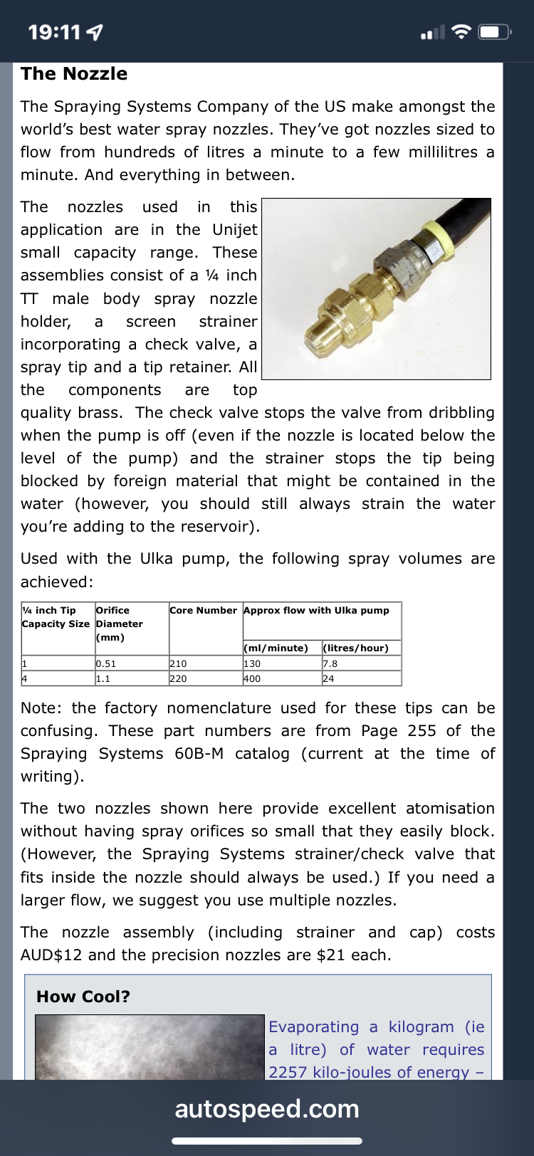

The pump controls the flow and pressure. Wouldn't the droplet size be a function of the nozzle (at certain pressure)?
Have you considered a water methanol system? Then just add a branch to for IC spray? I would even look at the pump & spray bar used on some WRXs (maybe some BMWs).

Fast951 wrote: Wed Jan 26, 2022 4:07 pm The pump controls the flow and pressure. Wouldn't the droplet size be a function of the nozzle (at certain pressure)?
Not sure if you read the short article.

Bought the intercooler sprayer pump.
Store just down the road from my house.
46.72$ Canadian
Far more powerful pump than anything else available.
